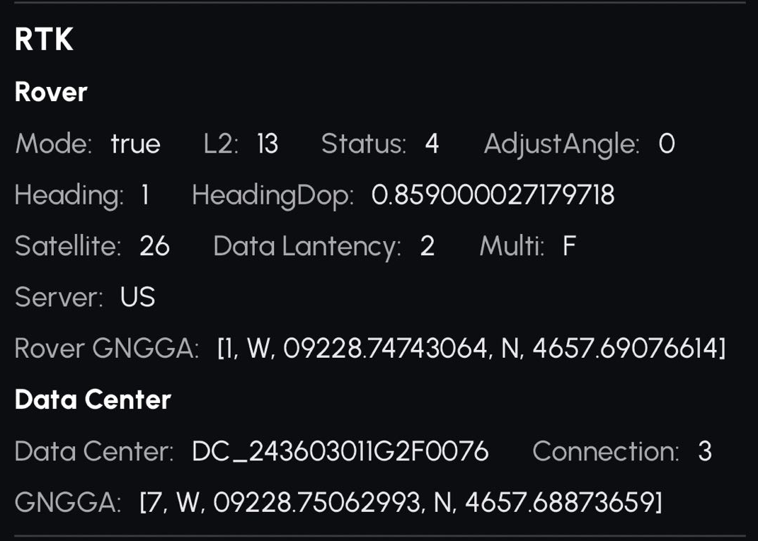

First check the current status of RTK if it is 4
RTK status
The meaning of different status of RTK
  • RTK = 1: No signal from the data center. This usually indicates a problem with the data center itself.
  • RTK = 2: Weak RTK signal. Check for potential obstructions or interference.
  • RTK = 4: Everything is functioning normally.
  • RTK = 5: Possible obstruction or antenna issue. If the machine is obstructed, manually move it to an open area. If there are no visible obstructions, ensure the antenna is securely tightened and the RTK node is properly connected.
Additionally, verify if there is data in GNGGA. If not, it may indicate a problem with the data center. The detailed data can be viewed on the APP diagnose page.
