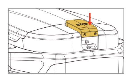

  • Press the Emergency Stop Button.
emergency stop button

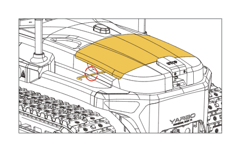

  • Confirm that Yarbo is turned off by checking if all the lights are switched off. Unscrew the bolts on the side of the battery cover.
    bolt unscrewing

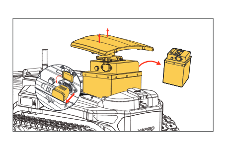

  • Remove the battery cover and unplug the cable connecting Yarbo and battery pack.
  • Remove the battery pack and safely secure it.
battery removal

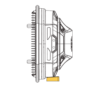

  • Before Cleaning: Detach the lawn mower from the universal body. Raise the mower from the side and place it on the Module Vertical Stand (refer to the picture below).
vertcal stand

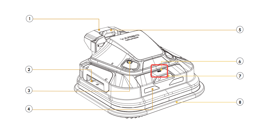

    1. Rain Sensor Maintenance
    The rain sensor, located at the front of the mower, detects weather changes. To ensure proper functionality, keep the grooves clean:
    rain sensors
  • Cleaning Method: Use a soft brush to clean the grooves marked by the red rectangle. Ensure that no dust or debris is obstructing the sensor.
