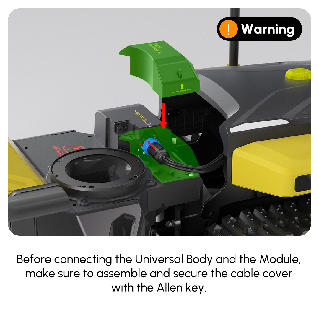

Ensure the cable cover is secured with the Allen key before connecting the Universal Body and Module
Securing Cable Cover for Weather Protection
Carefully secure the protective cover over the connection cable. This will help prevent any potential damage from snow or rain to the cable, the inner components and prevent un-authorized removal of the front module.
