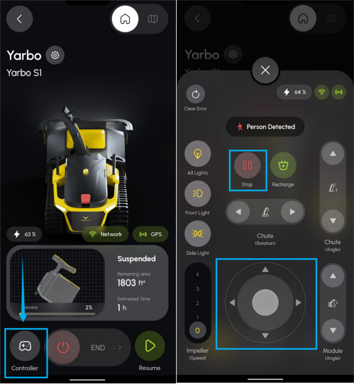

Manual Recharge with Virtual Controller
  • Hit the Controller button.
  • Stop the current work plan.
  • Use the virtual controller to navigate your Yarbo back to the docking station.
  • Make sure to click on the Charge button when Yarbo is all set to be charged. If Yarbo remains in standby at the docking station without user intervention for 5 minutes, it will automatically initiate the charging process.
