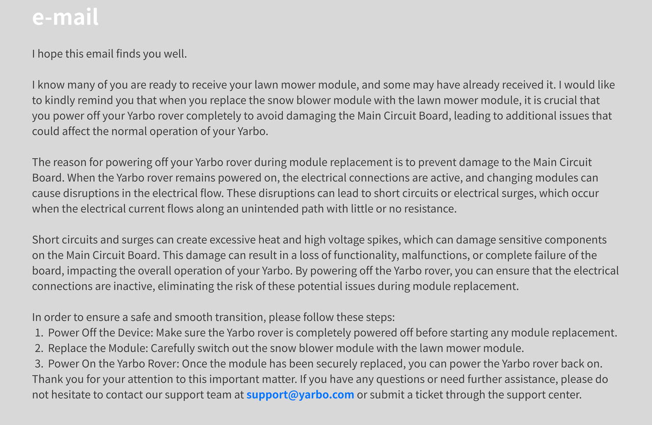

Additionally, the email address provided during the purchase will receive a support email before the device is received, containing the following hot swap warning:
Thank you for choosing Yarbo!
Yarbo Support Team
