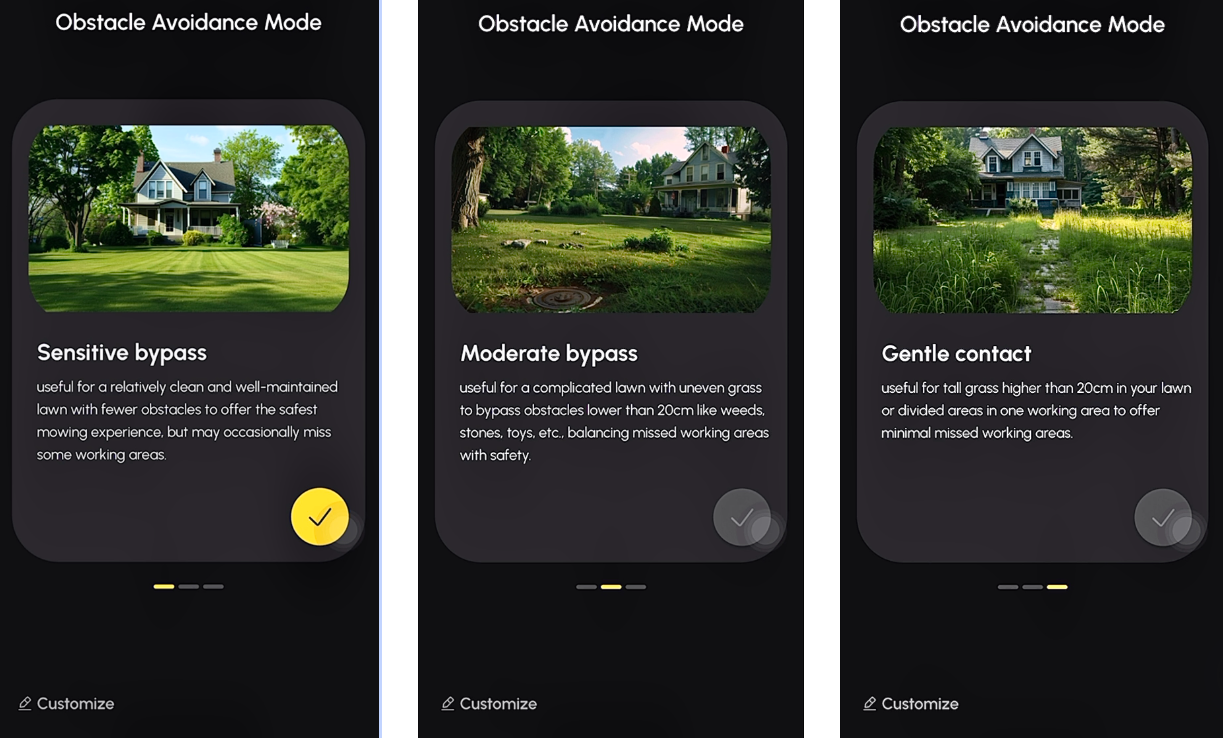

There are three typical obstacle avoidance modes in Yarbo to simplify your using experience.
- Sensitive Bypass: The bypass distance is set to maintain a 50cm(±10cm) gap between the inner side of the machine and the outer side of obstacles. With enhanced sensitivity to small obstacles, Yarbo is able to detect and identify most obstacles in this mode. It is recommended for a relatively clean and well-maintained lawn with fewer obstacles to offer the safest mowing experience, but may occasionally miss some working areas.
- Moderate Bypass: The bypass distance is set to maintain a 20cm(±10cm) gap between the inner side of the machine and the outer side of obstacles. It is recommended for a complicated lawn with uneven grass to bypass obstacles lower than 20cm like weeds, stones, toys, etc., balancing missed working areas with safety.
- Gentle Contact: This setting allows the machine to make light contact with obstacles (speed reduced to 0.1 m/s). It is recommended for tall grass higher than 20cm in your lawn or divided areas in one working area to offer minimal missed working areas.
The above are quick modes set for the most common scenarios. If you wish to make other adjustments during use, you can click "Customize" to adjust the vision bypass and sensors setting accordingly.

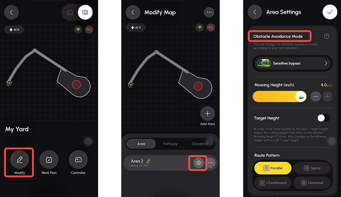

- Starting from Modify Map page, you will see your plans for different areas, where you can modify settings for different areas by clicking the icon shown below.
- There are 3 typical modes (sensitive bypass, moderate bypass, gentle contact) in obstacle avoidance. With detailed descriptions of different obstacle modes, choose one option which you think tailored to your lawn situation most.
- You can move forward to the customized icon for a tailored setting if the given scenarios cannot cater to your needs.

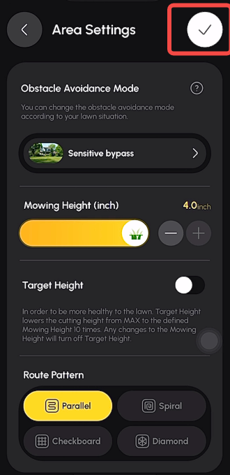

- Clicking √ in the top right corner to save the setting.
