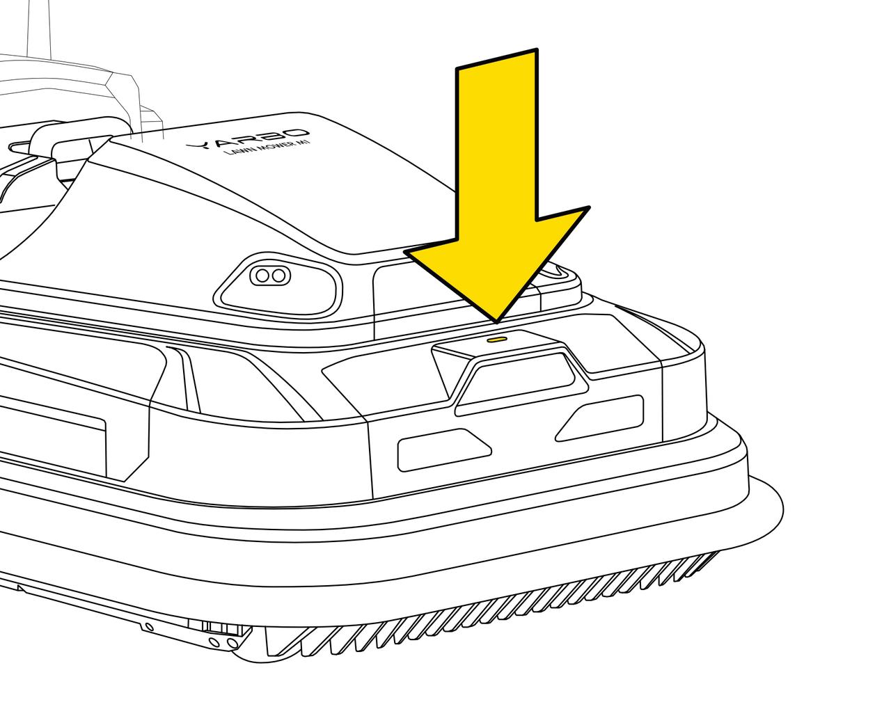

How to clean and maintain the mower's rain sensor for accurate detection?
The rain sensor is located at the top front of the mower module, covered by a small silicone with grooves. You can use a soft brush to clean the grooves to ensure no dust or other obstruction filled between two small yellow conductive probes. During daily use, sometimes the rain sensor may trigger incorrectly, please ensure no water or other conductive substances exist in grooves.
