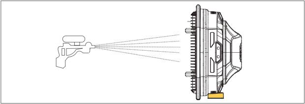

- Raise the lawn mower from the side and place the lawn mower on Module Vertical Stand, please refer to the following picture.
- Utilize a high-pressure water gun or water hose to clean the underside of the lawn mower. Do not spray the water into the universal body to prevent damage.
- Use a clean and gentle cloth or a brush to remove debris, mud and other particles from the shell.

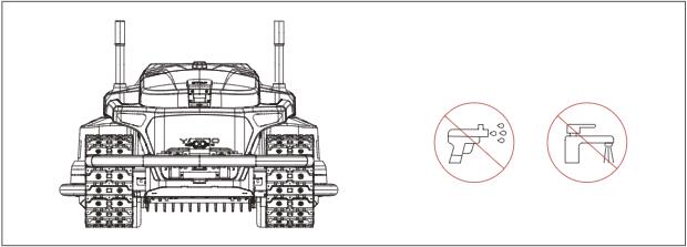

- Turn off the power.
- Use a clean and gentle cloth or a brush to remove debris, mud, and other particles.
- Please avoid using the high-pressure water hose or any high pressure cleaning methods to clean the universal body.
