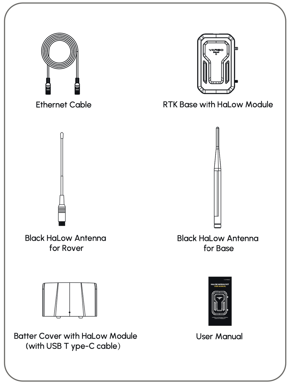

Preparation
Before you begin, ensure you have all the necessary components and tools:
  • Ethernet Cable
  • RTK Base with HaLow Module
  • Black HaLow Antenna for Rover
  • Black HaLow Antenna for Base
  • Battery Cover with HaLow Module (USB and Type C cable)
  • Yarbo app installed on your mobile device

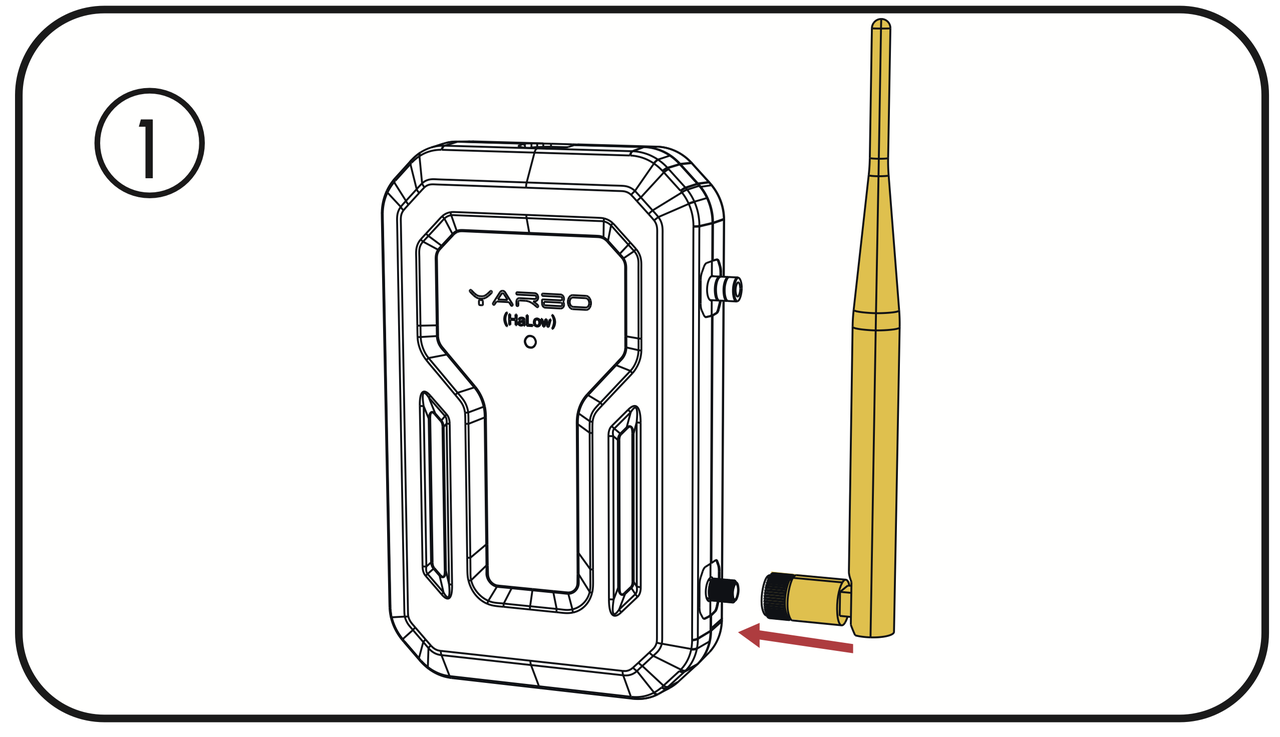

  1. Attach HaLow Antenna to RTK Base
    1. Locate the black HaLow antenna for the RTK Base.
    2. Screw the antenna securely into the designated antenna port on the RTK Base.

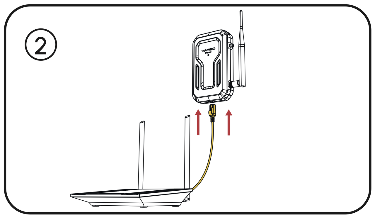

  1. Connect RTK Base to Router
  • Find the Ethernet cable included in your package.
  • Connect one end of the Ethernet cable to the Ethernet port on the RTK Base.
  • Plug the other end of the Ethernet cable into your router to establish a network connection.
Notes: It is recommended to install the RTK base station near a window, close to the working area, and in an open area without metal objects or obstacles to ensure the signal transmission would not be affected.

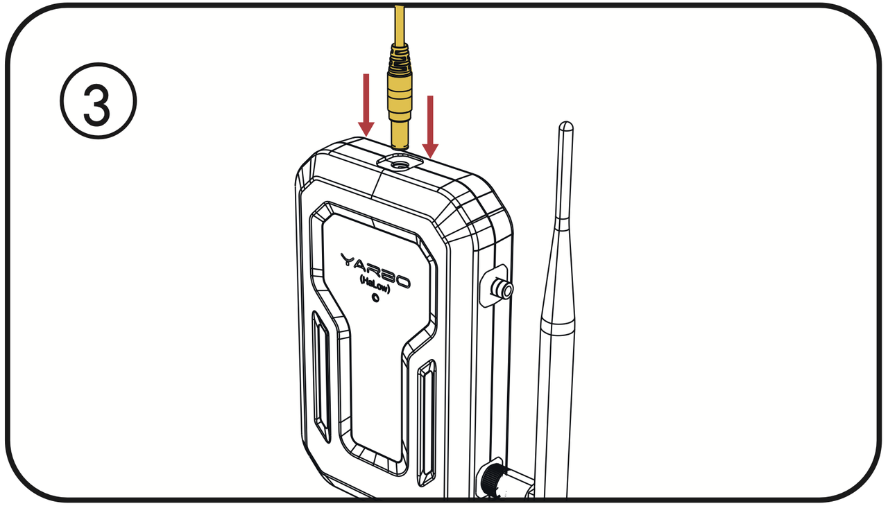

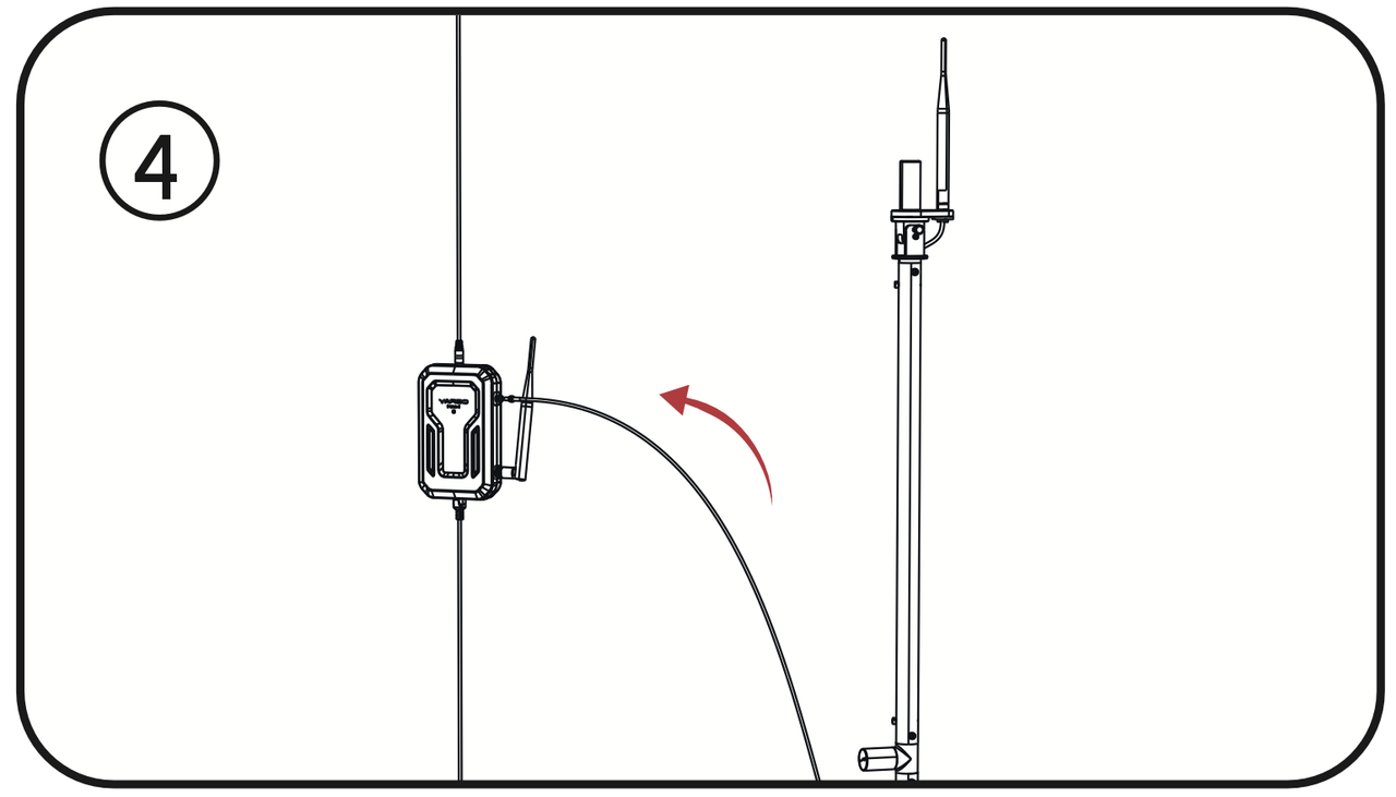

  1. Replace RTK Cable
  • Unplug the RTK cable from the existing setup of RTK base.
  • Connect this cable to the RTK port on the RTK Base equipped with the HaLow module.

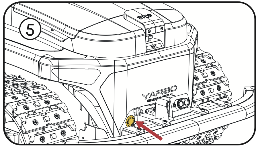

  1. Power off Yarbo
  • Press the power button to power off the Yarbo.

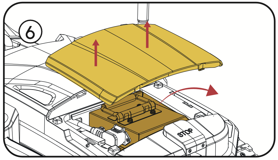

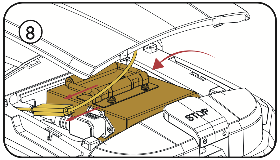

  1. Remove Battery Cover
  • Carefully grasp both sides of the battery cover with your hands.
  • Remove the battery from the universal body.

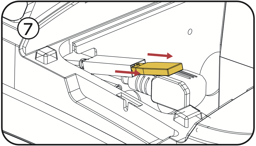

  1. Unpluging the USB connector
  • Locate the USB port inside the battery compartment.
  • Unplug the USB connector of the physical controller.
  1. Insert the USB Connector
  • Locate the cable with the HaLow USB connector attached to the battery cover.
  • Insert the HaLow USB connector into the USB port.
  • Place the battery inside the universal body and secure the battery cover.

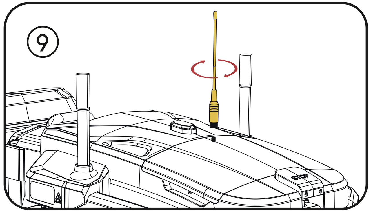

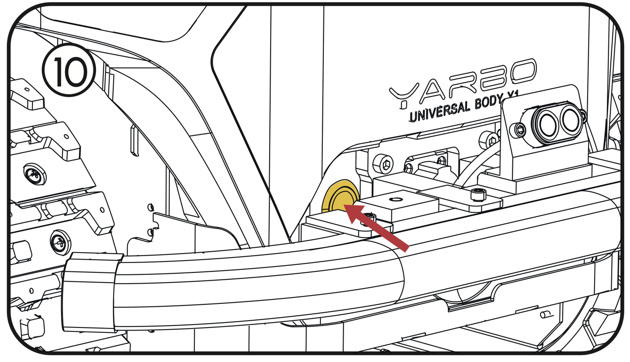

  1. Attach HaLow Antenna to Battery Cover
  • Locate the Black Halow Antenna for the rover.
  • Screw the antenna onto the battery cover.

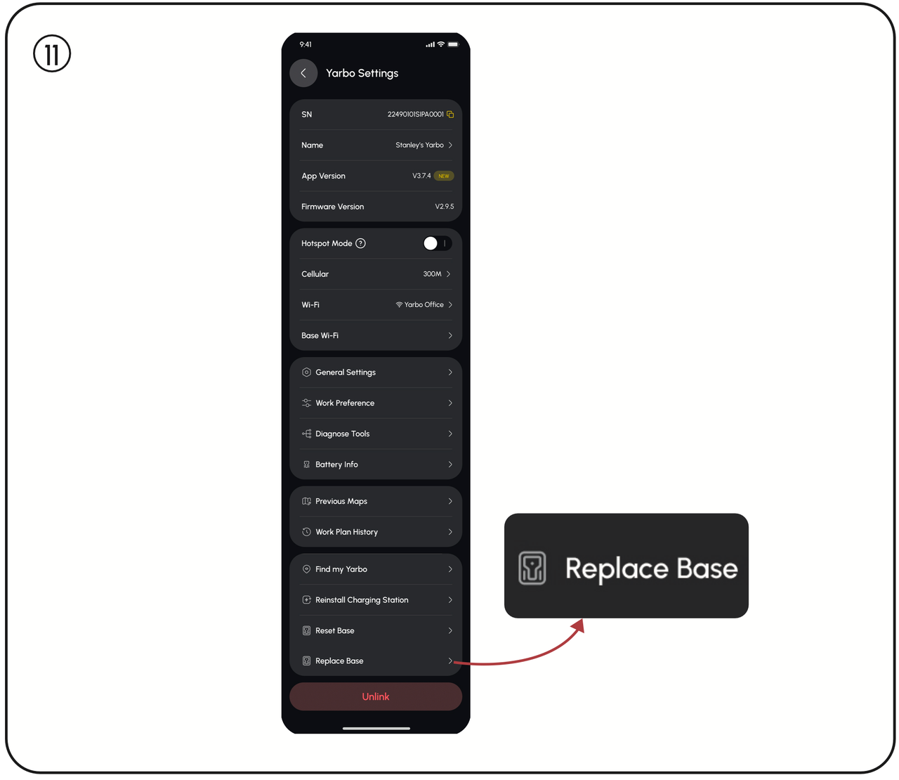

  1. Replace Base in the App
  • Open the app setting page
  • Click 'Replace Base' to initiate the process of replacing the base station, and follow the guide in the app to complete the network connection for the new RTK base.
