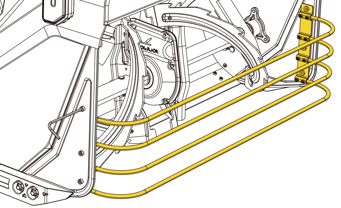

The Snow Blower Protection Fence : Integral to Our Triple-Layer Safety System
The Snow Blower Protection Fence enhances our Triple-Layer Safety System, which includes side cameras, a front camera, millimeter-wave radars, and a bumper. It not only protects your feet from the spinning auger but also shields the auger from hard obstacles during automated operations, ensuring safe and efficient performance.
protection fence
