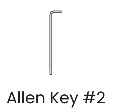

Step 1: Gather the Tools Needed
Before you start, ensure you have an Allen Key #2, which is included in your Yarbo package.

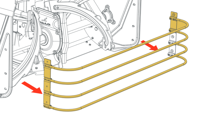

Step 3: Remove the Protection Fence
Once the bolts are removed, you can lift the protection fence off the snow blower module. Be sure to remove the fence carefully without forcing it to avoid any damage to other parts. protection fence removal
