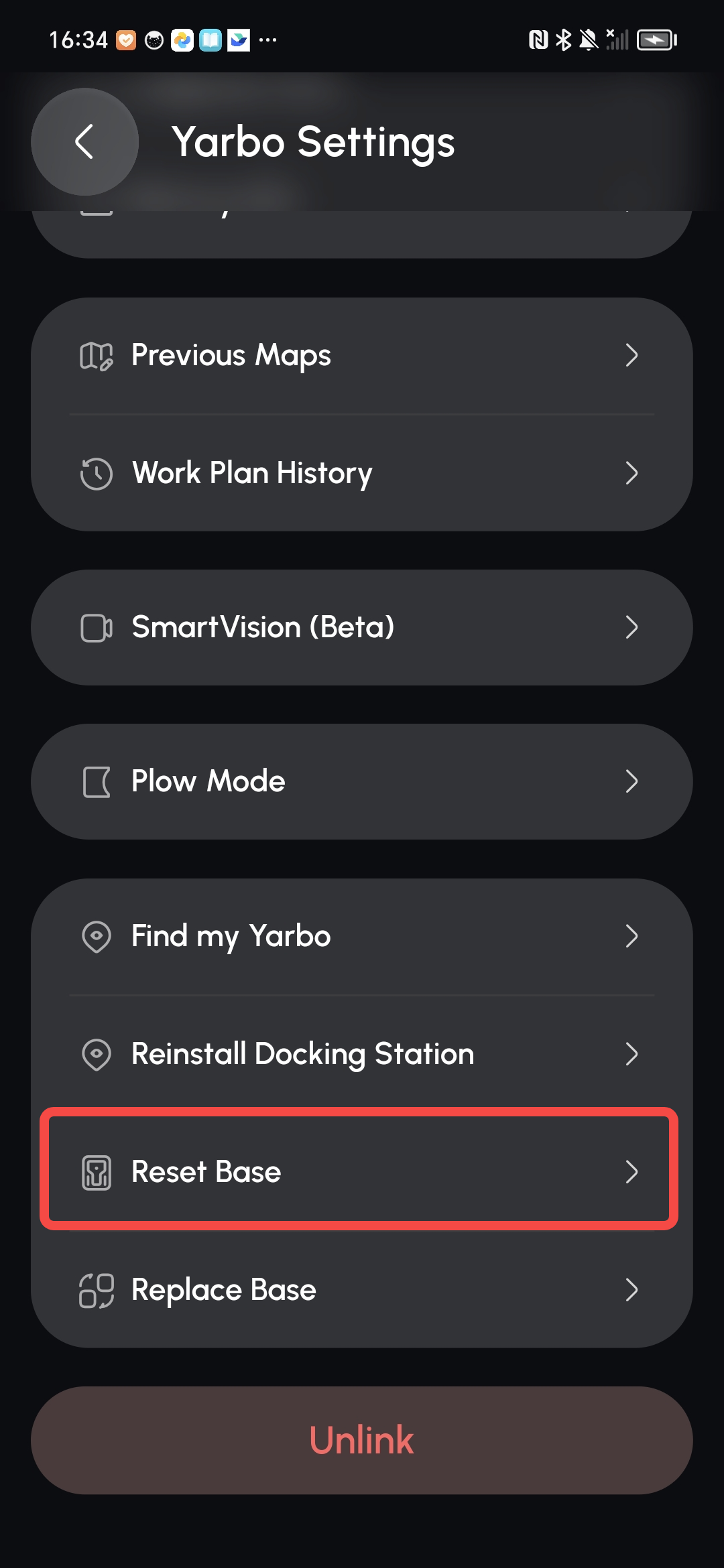

  1. Access Yarbo Settings and Select “Reset Base”
    1. Open the Yarbo app.
    2. Go to the “Yarbo Settings” page.
    3. Scroll down and find the “Reset Base” option, then tap it.

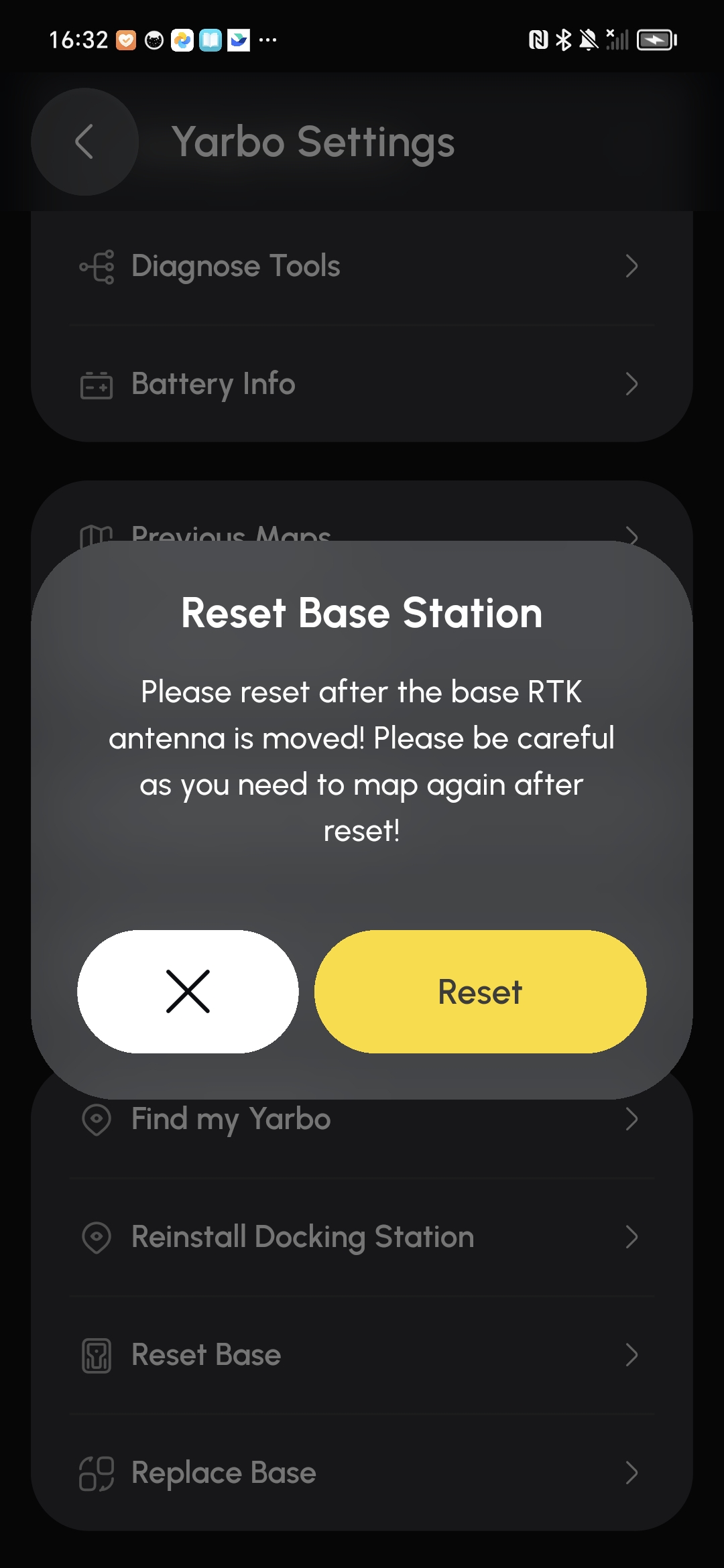

    4. A confirmation message will pop up, reminding you that a reset will require you to remap.
  1. Confirm the Reset
    1. Read the confirmation message to understand that resetting will erase all settings.
    2. Tap the yellow “Reset” button to confirm.

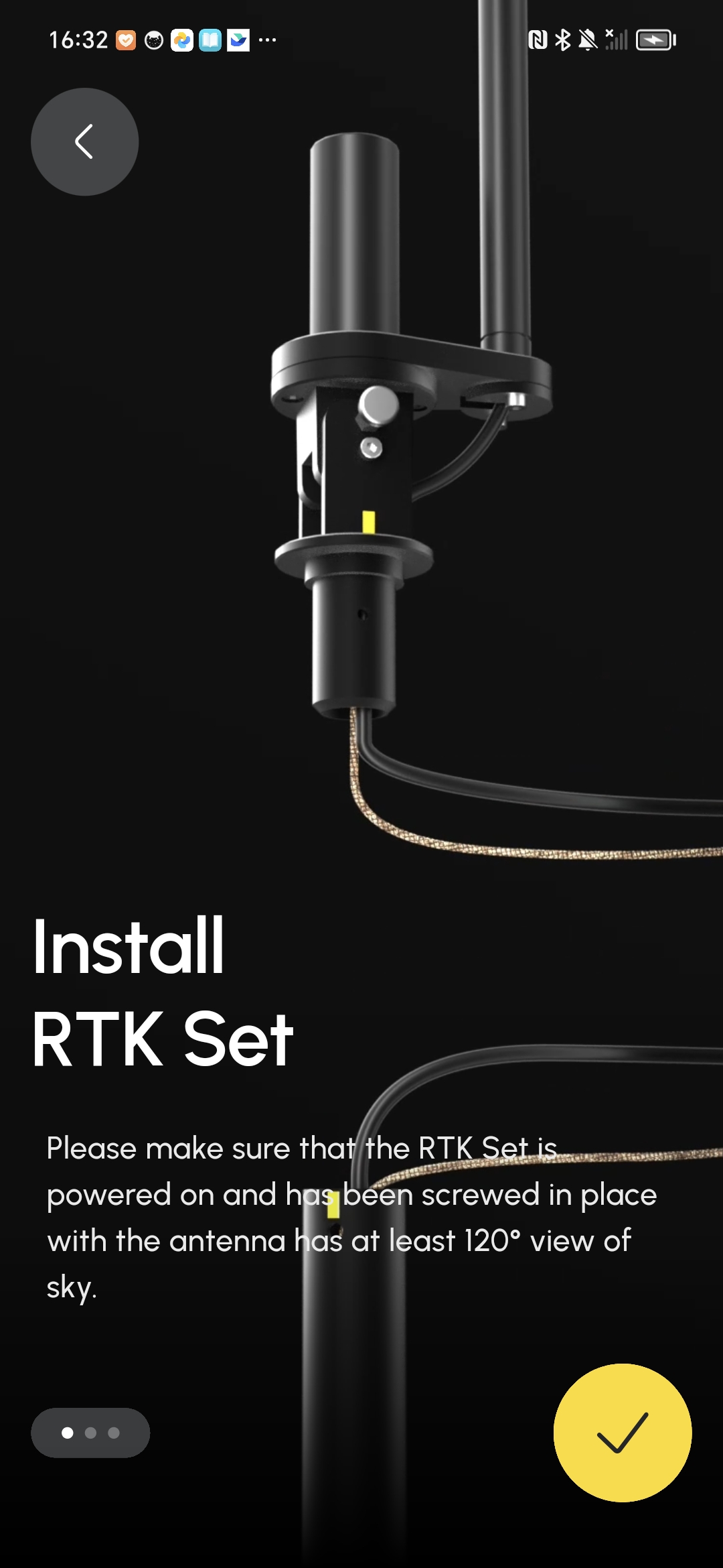

  1. Reinstall the RTK Antenna
    1. Choose a Location: Make sure the RTK set is powered on and the antenna is installed in an open area with at least a 120° view of the sky.
    2. Secure Installation: Ensure the antenna is firmly attached and secure.

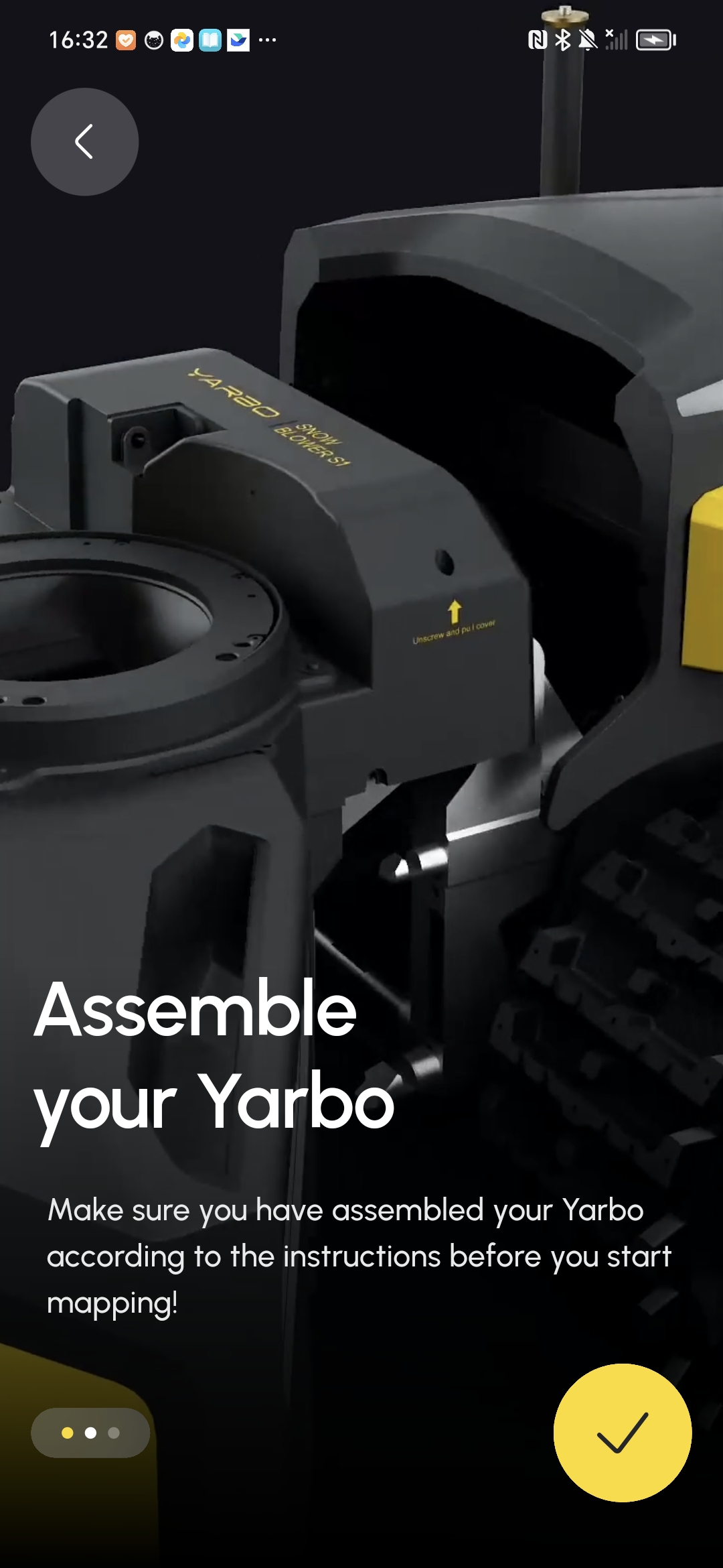

  1. Assemble the Yarbo Device
    1. Reassemble the Yarbo device, making sure all parts are correctly and securely connected.
    2. Check for any loose or incorrectly installed components.

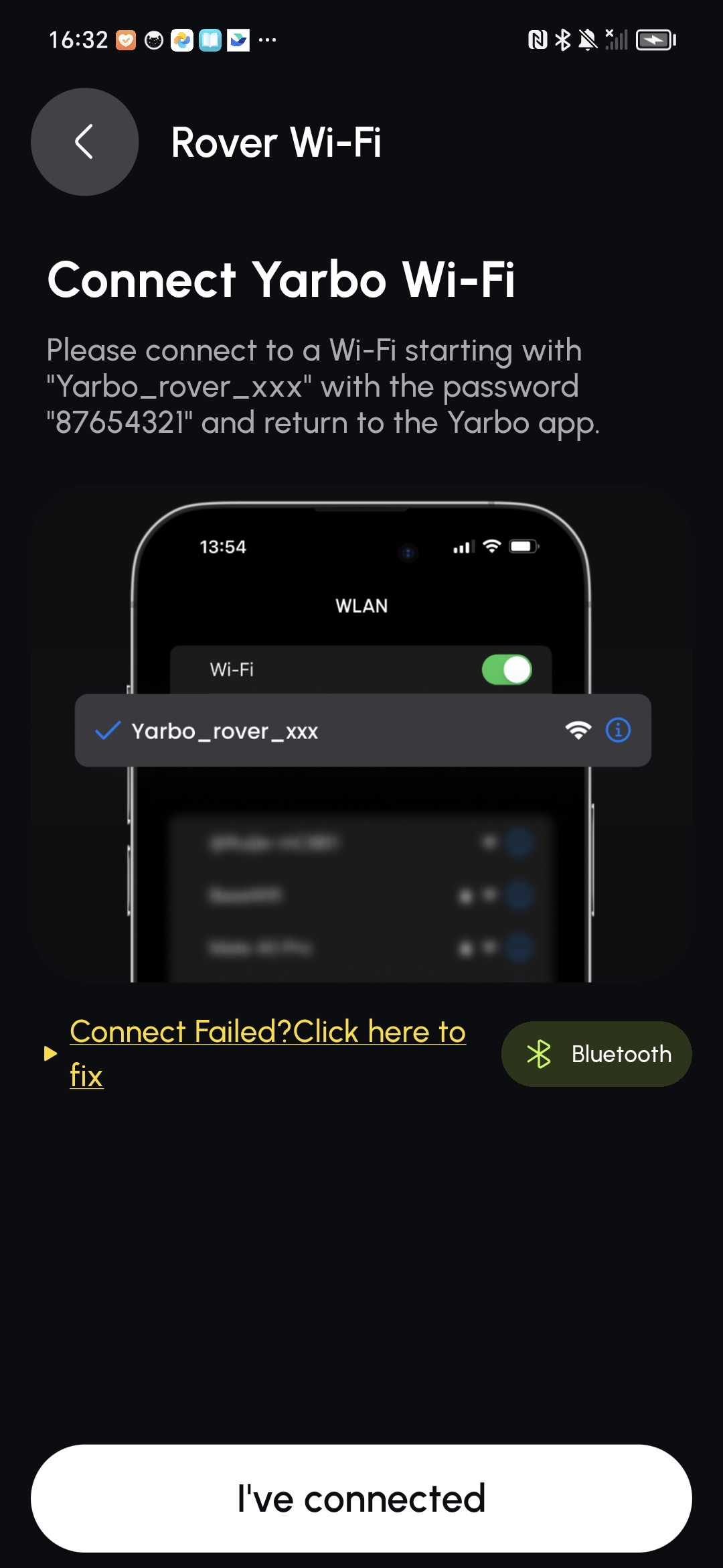

  1. Connect to Yarbo Wi-Fi
    1. On your device, go to Wi-Fi settings and find the network named “Yarbo_rover_xxx.”
    2. Enter the password “87654321” to connect.
    3. Return to the Yarbo app and confirm the connection.

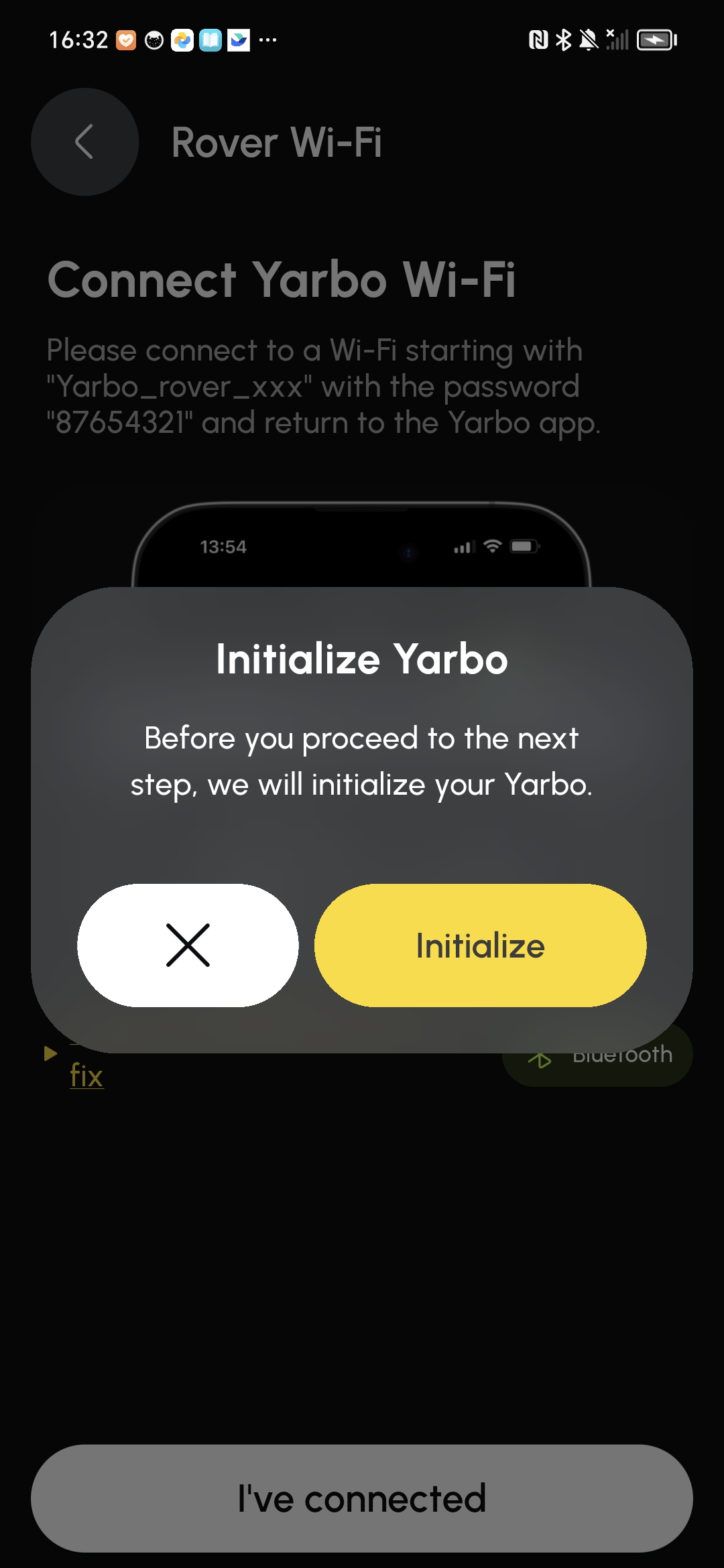

  1. Initialize Yarbo
    1. The app will prompt you to initialize the Yarbo device.
    2. Tap the “Initialize” button to start the setup process.

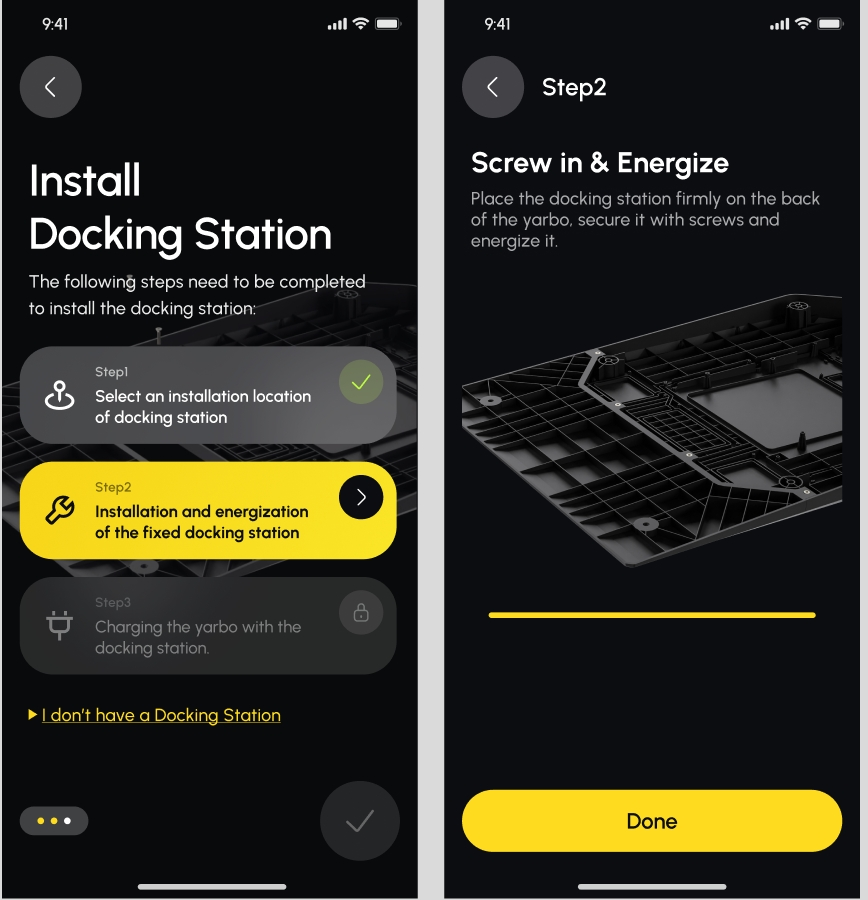

    1. Screw in and Energize:
      1. Secure the charging station in place using screws, as shown in the image. Connect it to a power source.

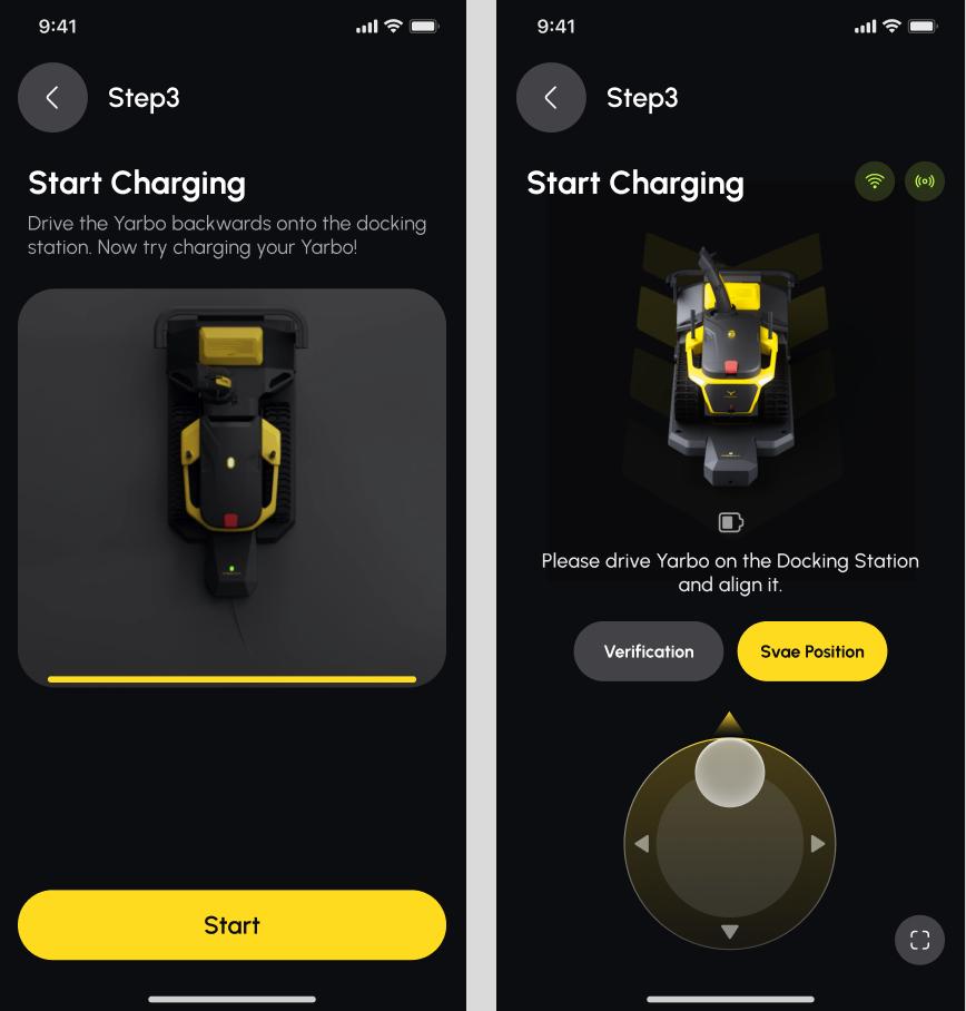

    1. Start Charging:
      1. Drive Yarbo onto the charging station, align it correctly, and verify the setup. Begin charging by checking the indicator light and confirming in the app.

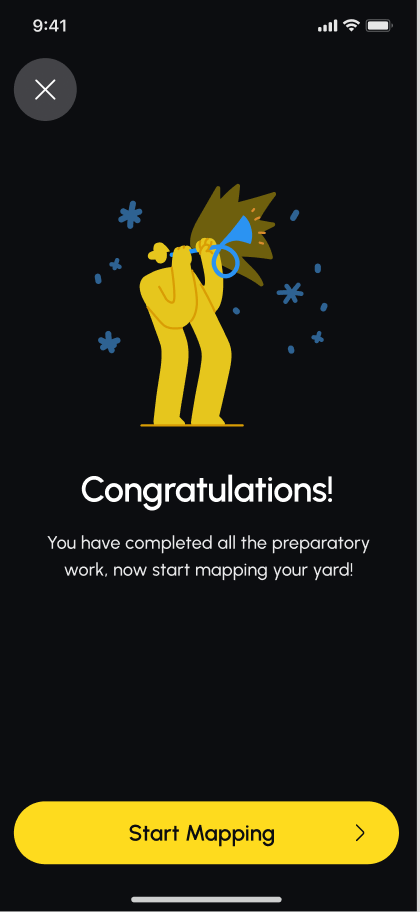

  1. Finalize the Reset
    1. After resetting, you can continue with other settings in the app, like mapping the yard.
