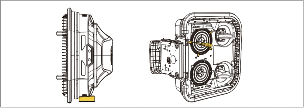

The cutting blades can be replaced when they are damaged or worn out. We recommend you change the blades every six months. Make sure the blades are fixed securely and flexibly. Handing and disposing of old or damaged blades includes 4 steps:
  1. Detach the lawn mower from the universal body.
  2. Raise the lawn mower from the side place the lawn mower lawn mower on the Vertical Stand for Module, please refer to the picture shown below.
  3. Unscrew the Cutting Blades Bolts using Phillips-Head Screwdriver provided in the lawn mower Box content.
  4. Install the new blades by tightening the cutting blade bolts.
For more detailed guidance, please refer to the video:
For the discarded blades that have been replaced, we suggest disposing of them or recycling them in accordance with local regulations.
