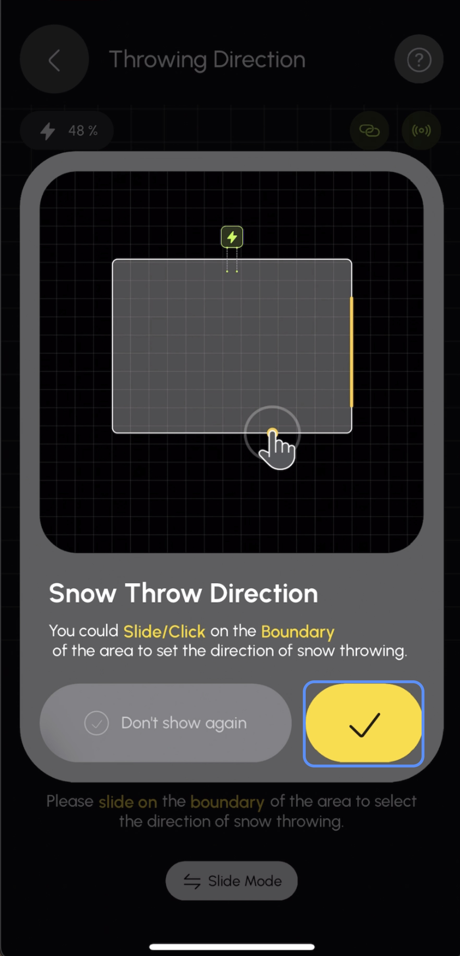

1. Guided animation in snow-throwing direction setup:
When entering the snow-throwing directions setup, you'll encounter a guided animation. You have the option to click "Don't show again" or directly click the "Confirm" button to proceed.

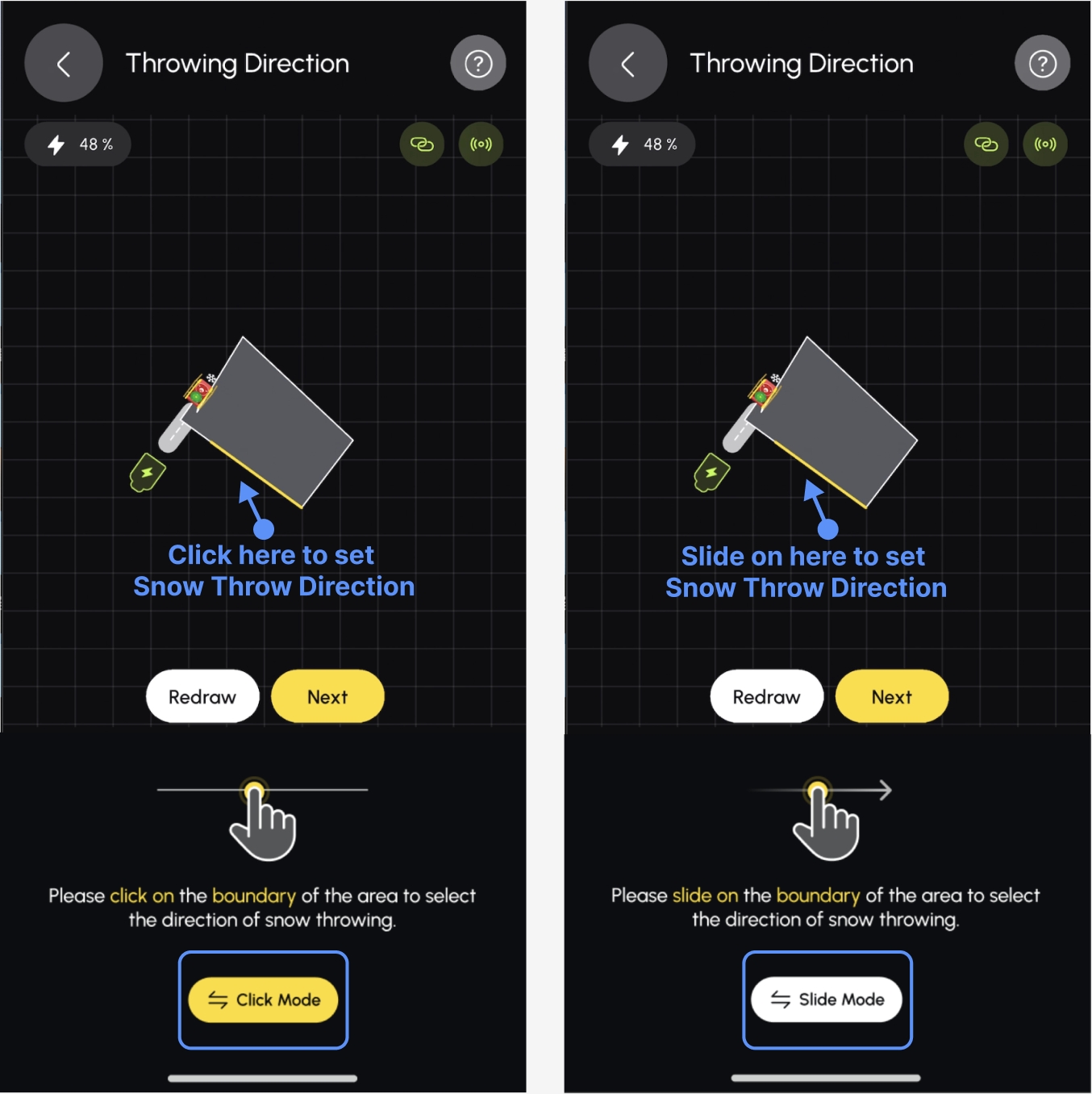

2. Setting snow-throwing directions:
To configure the snow-throwing directions, please click or slide along the boundary of the working area. Click the button at the bottom of the interface to switch between different setting modes.

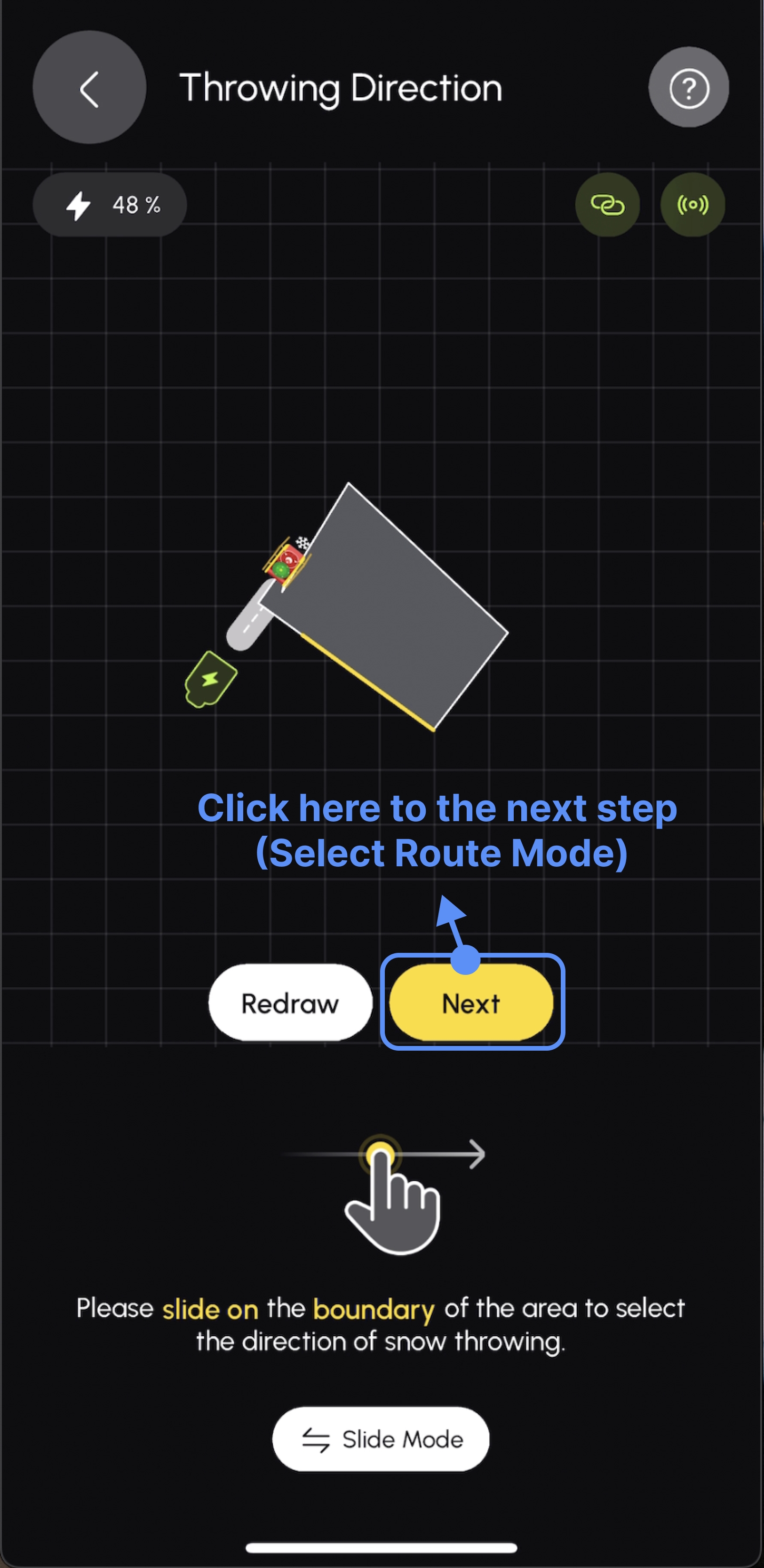

3. Completion of snow-throwing direction setup:
After completing the snow-throwing directions set up, you have completed the fundamental mapping process. Click "Next" to proceed to the next step.
4. Error correction in snow-throwing directions:
 If any mistakes are made during the drawing, there's no need to worry. You can click "Redraw" to start over.
