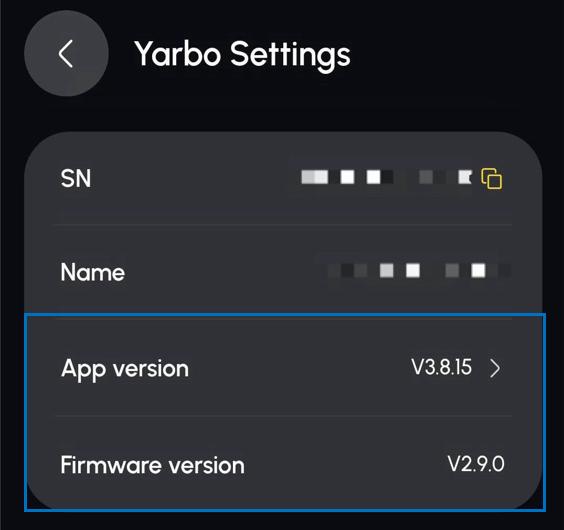

- After the firmware upgrade is complete, check the updated firmware version in Yarbo App — Settings. This step ensures that your Yarbo is running the latest firmware for optimal performance.
