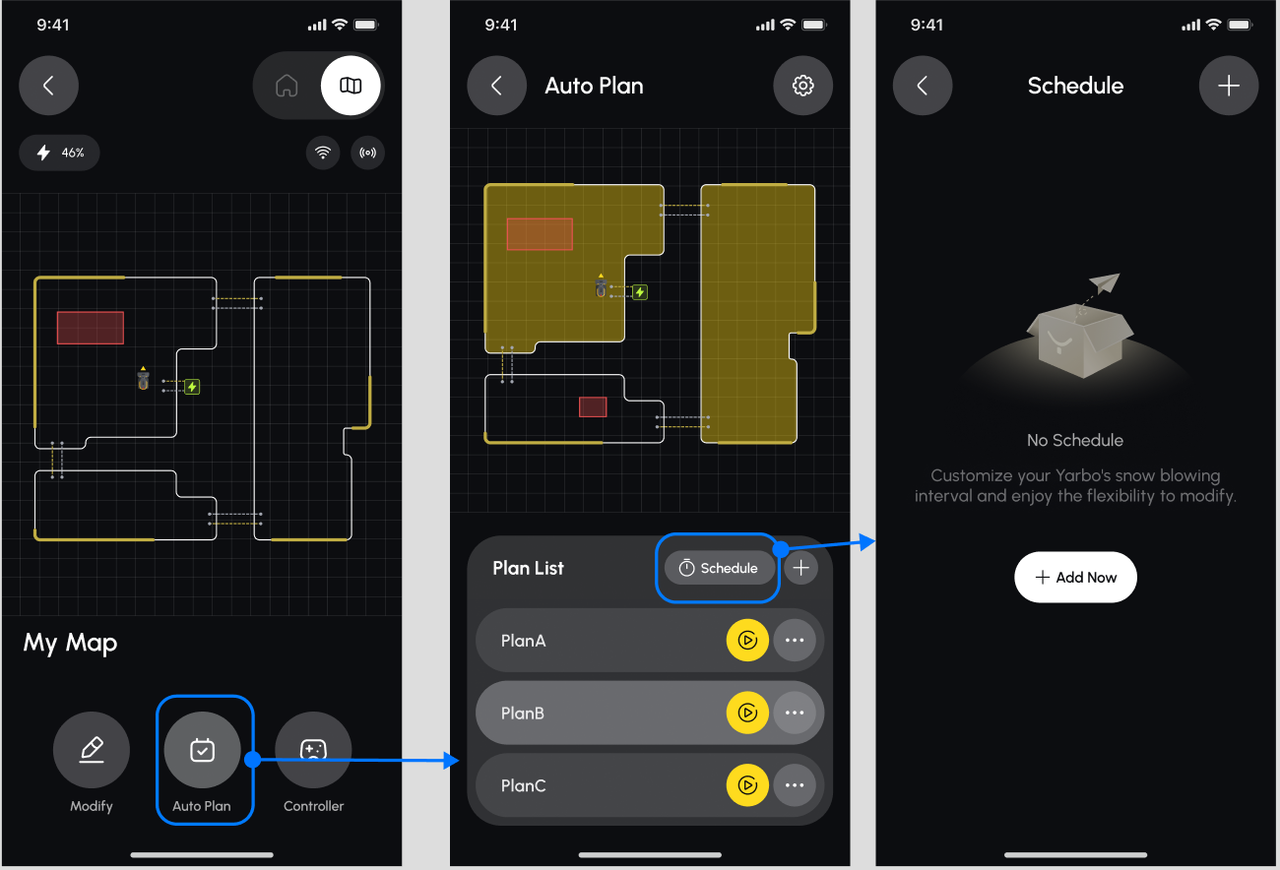

  • To access the schedule settings, start by selecting "Auto Plan" on the map page. Once on the Auto Plan page, navigate to the top menu and click on "Schedule." This will take you to the schedule settings where you can create a work schedule for automated snow removal.

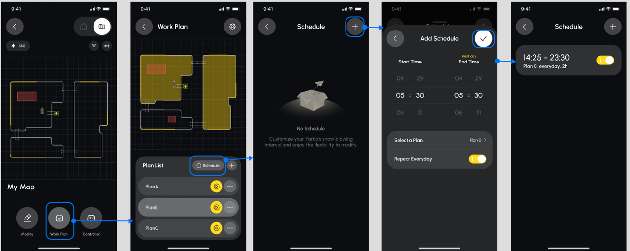

Step 1: To initiate the scheduling process, navigate to the Map page and click on "Work Plan." Within the Plan list, locate the "Schedule" feature.
Step 2: On the Schedule page, click the "Add" icon to begin creating a schedule for a designated plan.
Step 3: Set the "Start Time" and "End Time“ for the scheduled cleaning. This establishes the time frame during which the Yarbo will autonomously execute its cleaning plan.
Step 4: Next, select a plan from the plan list. Once you have selected a plan, you can turn on the "Repeat Everyday" option based on your preference, ensuring that the schedule automatically repeats every day within the specified time period.
Step 5: Once satisfied with the schedule settings, save the plan to enable the Yarbo to automatically execute the work plan according to the defined schedule.

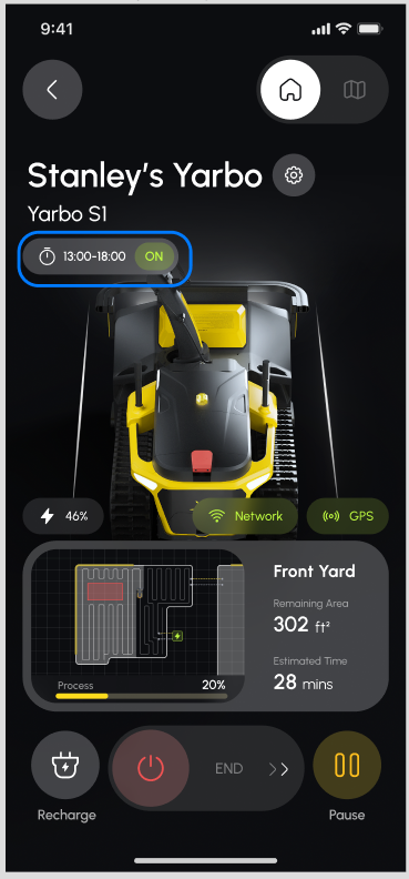

  • The plan you have scheduled will be automatically executed by Yarbo upon reaching your set start time. An icon showing the ongoing execution of the schedule will appear on the home page.

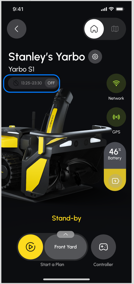

  • When you manually cancel the current work plan, the schedule will only be automatically restarted at the next scheduled start time. A paused schedule will also appear as 'off' in the icon on the home page.

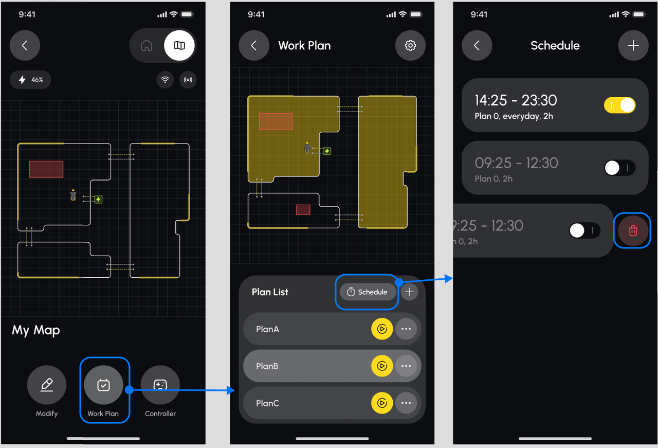

Delete a Schedule
  1. Find the "Schedule" feature in the Plan list by going to the Map page and clicking on "Work Plan."
  2. To remove the corresponding schedule, swipe left on a schedule and click on the delete icon.
