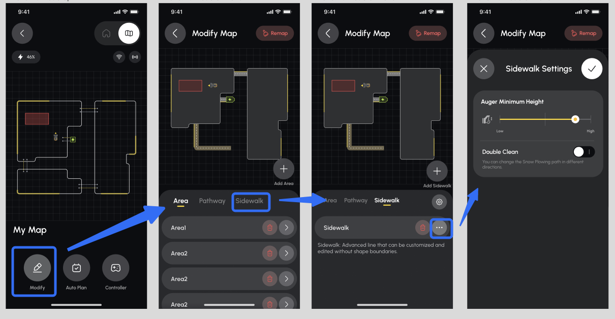

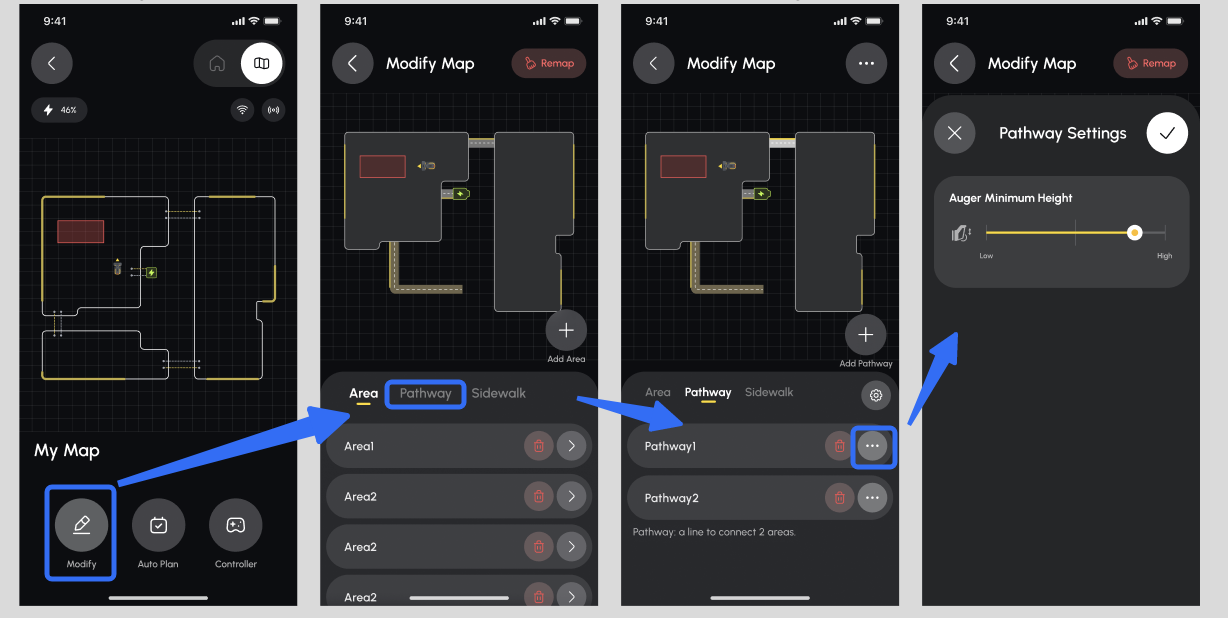

- Before activating the plow blade mode, it is recommended to adjust the module height for pathways and sidewalks to an appropriate level based on the terrain within the modify page. This adjustment can help prolong the lifespan of the plow blade.
- On the plow blade mode page, only the parameter settings for the work area can be customized. Parameter settings for pathways and sidewalks must be customized through the modify page. Adjusting the parameters for the work area, sidewalk, and pathway at the same time will be developed in the future update.

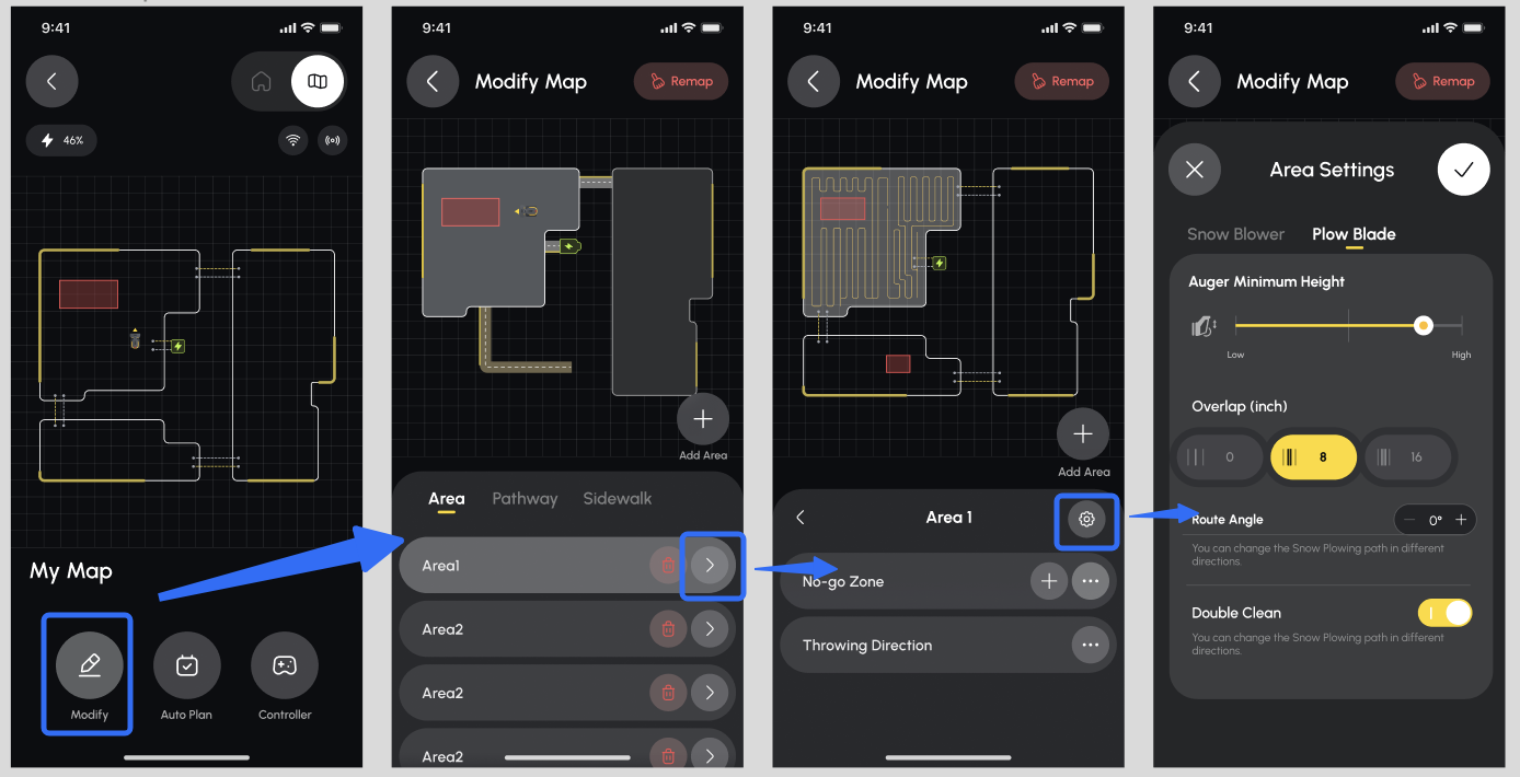

You also can access parameter settings for the work area within the modify page:
- Access 'My Map' Page: Begin by clicking on the icon located in the upper-right corner, directing you to the 'My Map' page where you manage and customize your map settings.
- Enter Modification Mode: Click on 'Modify' to enter the modification mode. This mode will allow you to access various customization options.
- Select the Targeted Area: From the available list, choose the specific area you intend to adjust to by clicking on it.
- Access the Settings Page: Once selected, click on the associated settings icon to open the dedicated settings page for the chosen area. This action opens the settings page dedicated to the chosen area, allowing you to make detailed adjustments according to your preferences.
- Choose Plow Blade Mode: Select 'Plow Blade' to customize the parameter settings specifically for this mode.
On the plow blade mode, the parameter setting of the pathway and sidewalk needs to be adjusted within the modify page if necessary. Please refer to the following guide for locating the settings page when the plow blade mode is enabled.
