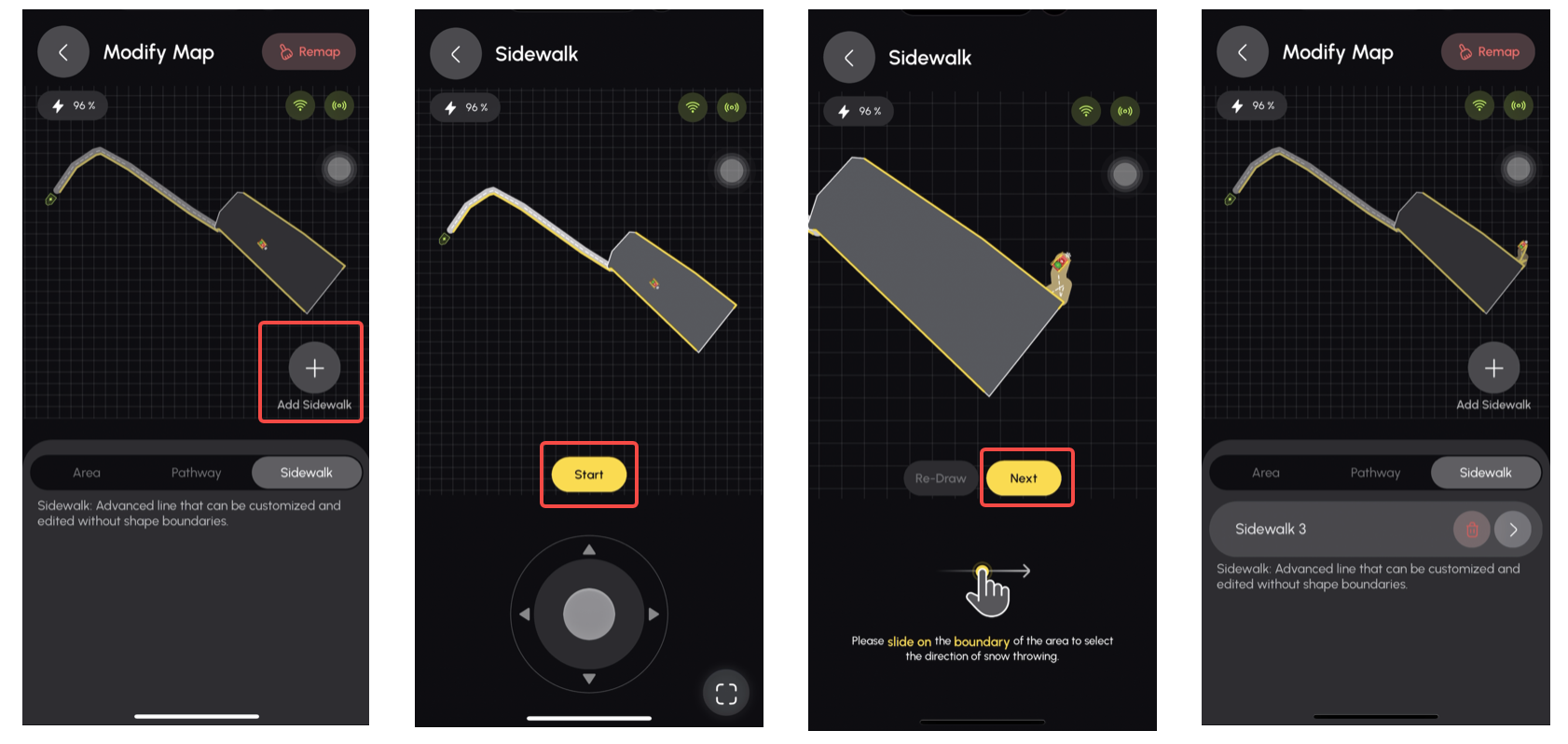

- Begin by clicking on the "Map" icon located in the top right corner of Yarbo's homepage.
- Look for the "Modify Map" button within the map interface.
- Click on "Modify" to access the Sidewalk option.
How to Use Sidewalk?
- The route of the sidewalk is determined by how you guide Yarbo to draw a sidewalk on your map, which is a personalized route not generated by a closed shape.
- The sidewalk must be connected to an area or pathway.
- A sidewalk on the map can be a continuous line that allows for turns. If you wish to use the sidewalk feature to clean an area without creating a work area, you can either create multiple sidewalk lines within that area or establish a continuous sidewalk with turnarounds, resembling a U shape.
- A sidewalk is a single linear path, distinct from a closed area, and it can be seamlessly connected to specific areas.
- The sidewalk cannot be cross the no-go zone.
- The parameters of each sidewalk can be customized.
- Initiate Sidewalk Addition: Locate and click the "Add Sidewalk" button on the toolbar.
- Start Drawing: Click on the "Start" button to define your sidewalk on the map area, please ensure that the sidewalk is connected to an area or pathway.
- Select Throw Direction: Slide the boundary to indicate the direction of snow throwing for the sidewalk.
- Complete Drawing: After selecting the throw direction, click on the "Next" button to finalize and conclude the drawing process.
- Confirmation: Confirm the drawn sidewalk and its designated direction. If satisfied, proceed with any additional steps or save the changes.
