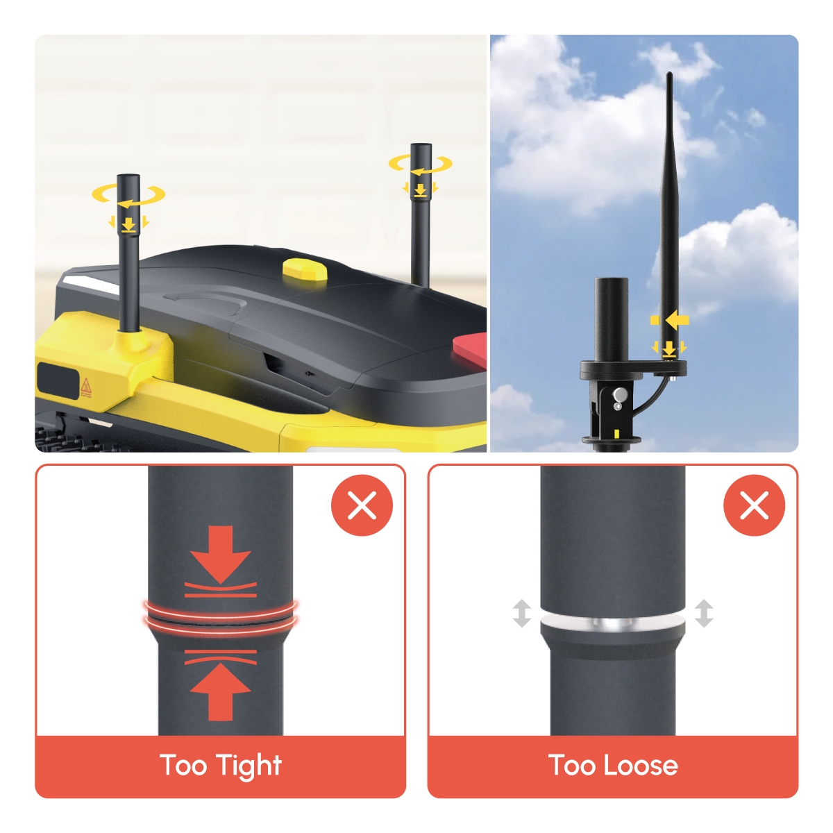

Securely Fasten the Antennas
1. Make sure to securely fasten the antennas on both the Yarbo Main Body and the external RTK pole.
2. Make sure to tighten the antennas just enough, but be careful not to overdo it as it could cause damage.
Securing the RTK Antenna
Make sure the RTK Antenna structure is securely fastened. Any movement in the structure of the antenna will directly affect the accuracy of Yarbo’s positioning.
