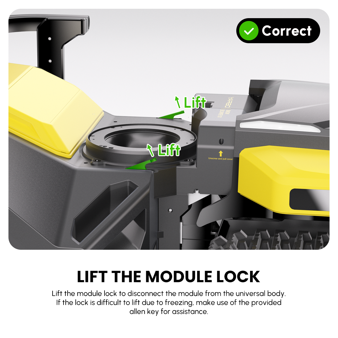

How to Disconnect the Module from the Universal Body?
Find the module lock, highlighted in green in the picture above. Lift this lock and the module will disengage from the main body.
If the lock seems to be frozen, use the provided Allen key #1 to lift it, or move the entire unit to a warmer environment.
