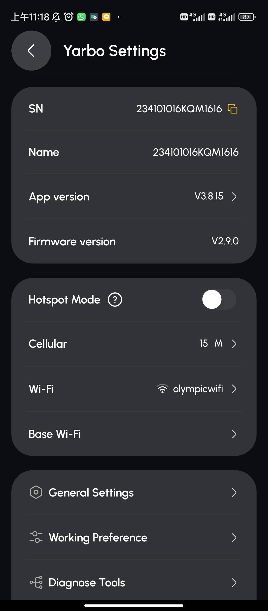

- If the solutions above do not work. Please contact our customer service for support. When you report your issue, be sure to include the version of your machine, as indicated in the picture below. This information is crucial, as the issue you're facing might be a known concern associated with this specific version of the machine.

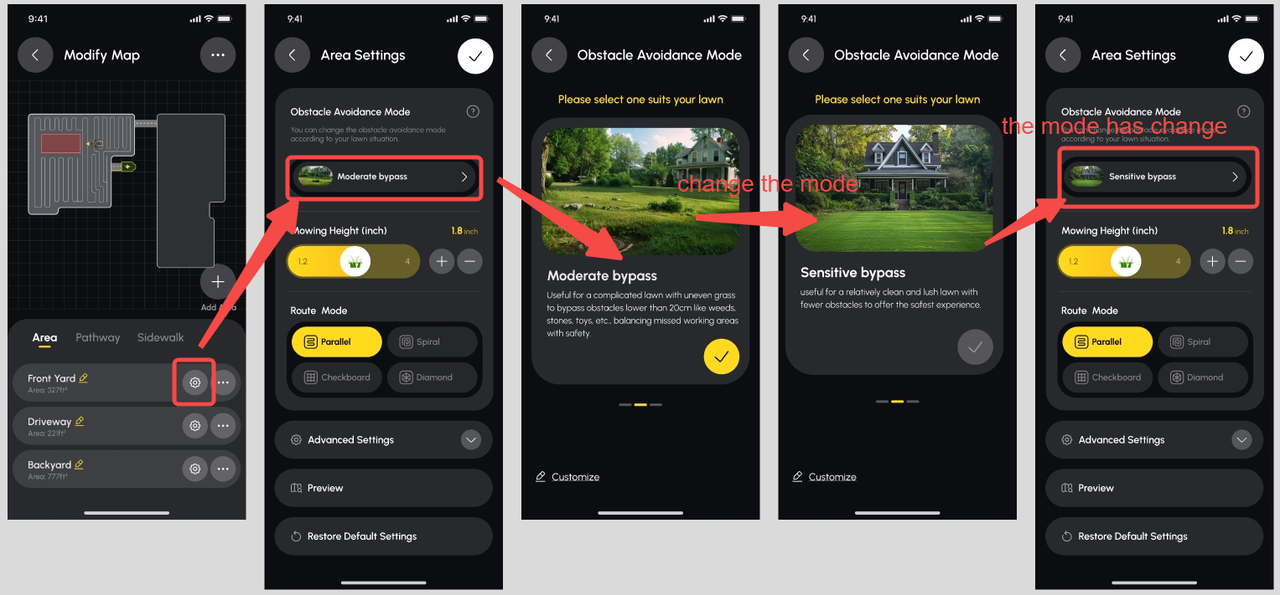

How to choose and adjust obstacle avoidance mode for my Yarbo?
What is the obstacle avoidance mode for? Avoidance mode is designed to automatically adjust Yarbo to your lawn situation. Each obstacle avoidance mode automatically has a default of camera sensitivity and ultrasonic sensors, in order to ensure smooth ...
