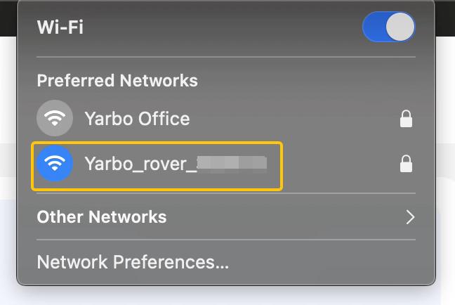

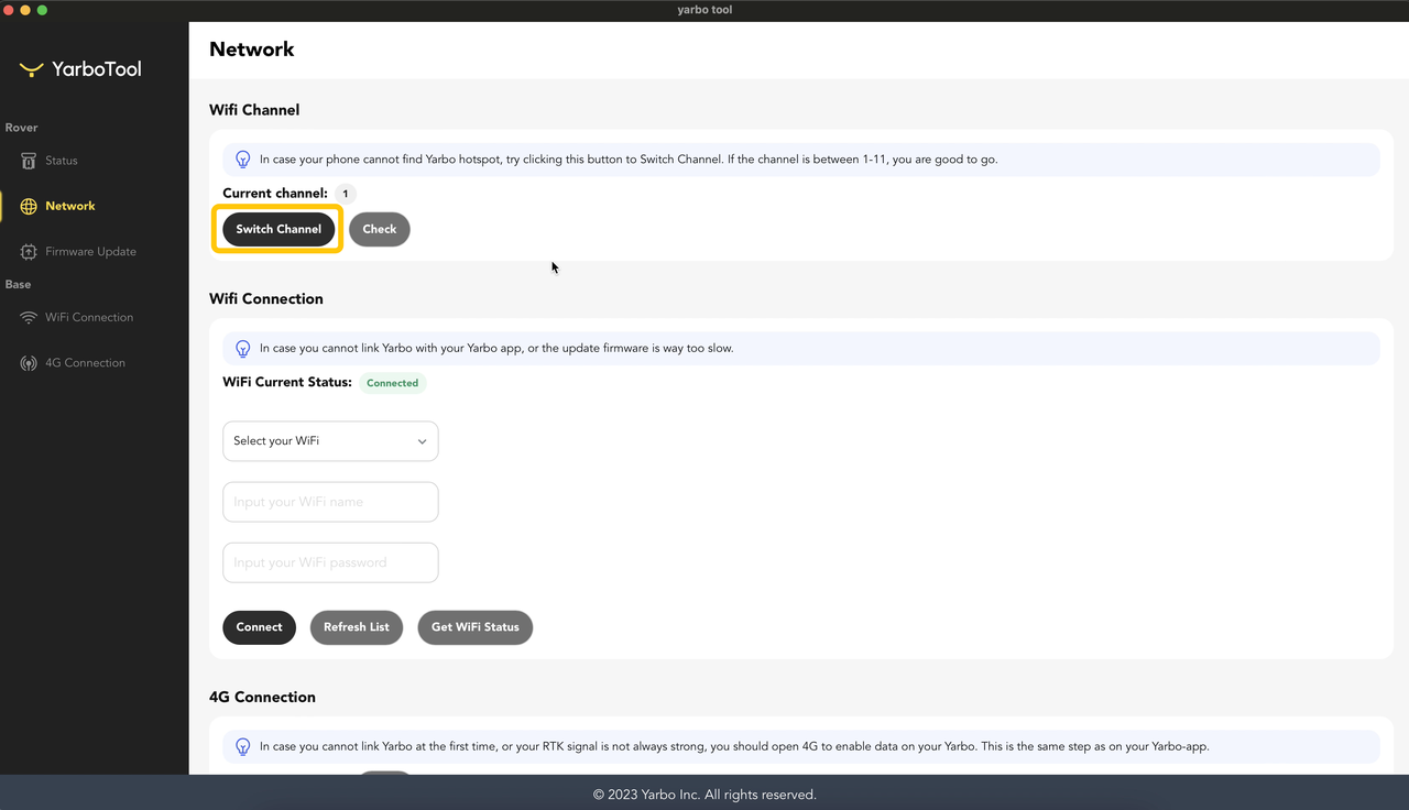

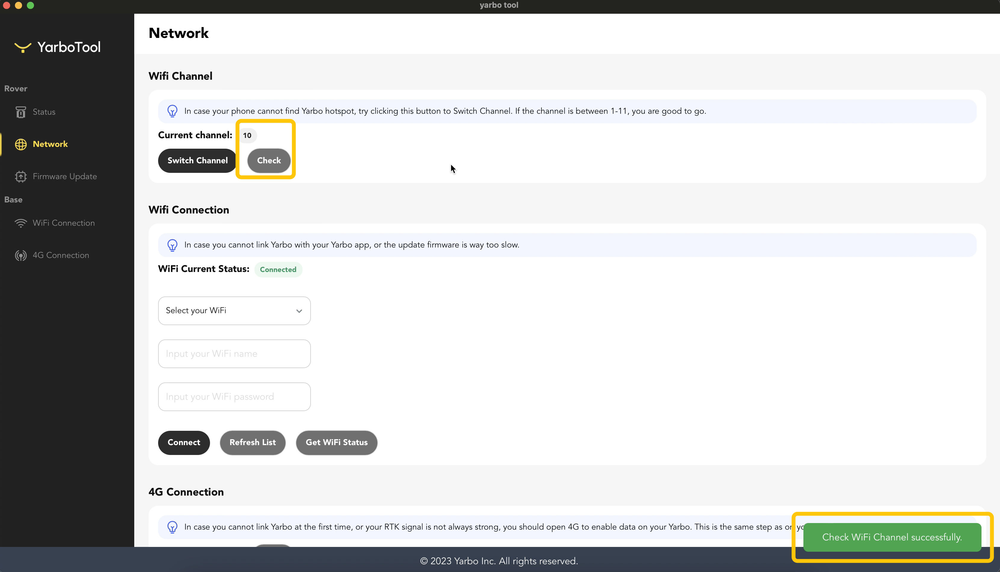

- The Yarbo app can not connect to the rover via the hotspot connection. 【Rover -> Network-> Wi-Fi Connection】
- The hotspot of Yarbo's rover cannot be found on the setting page of the mobile device. 【Rover -> Network-> Wi-Fi Connection】

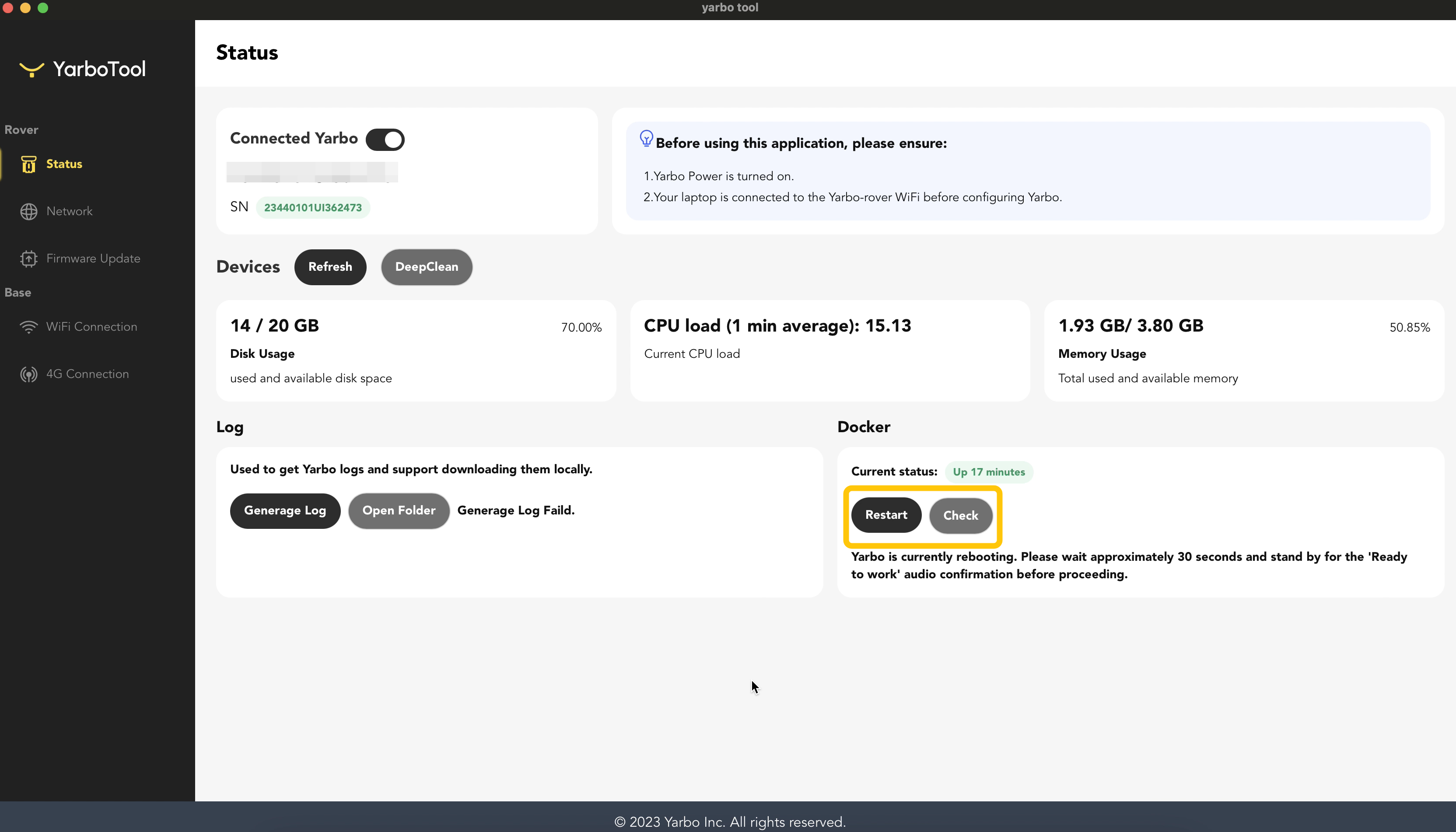

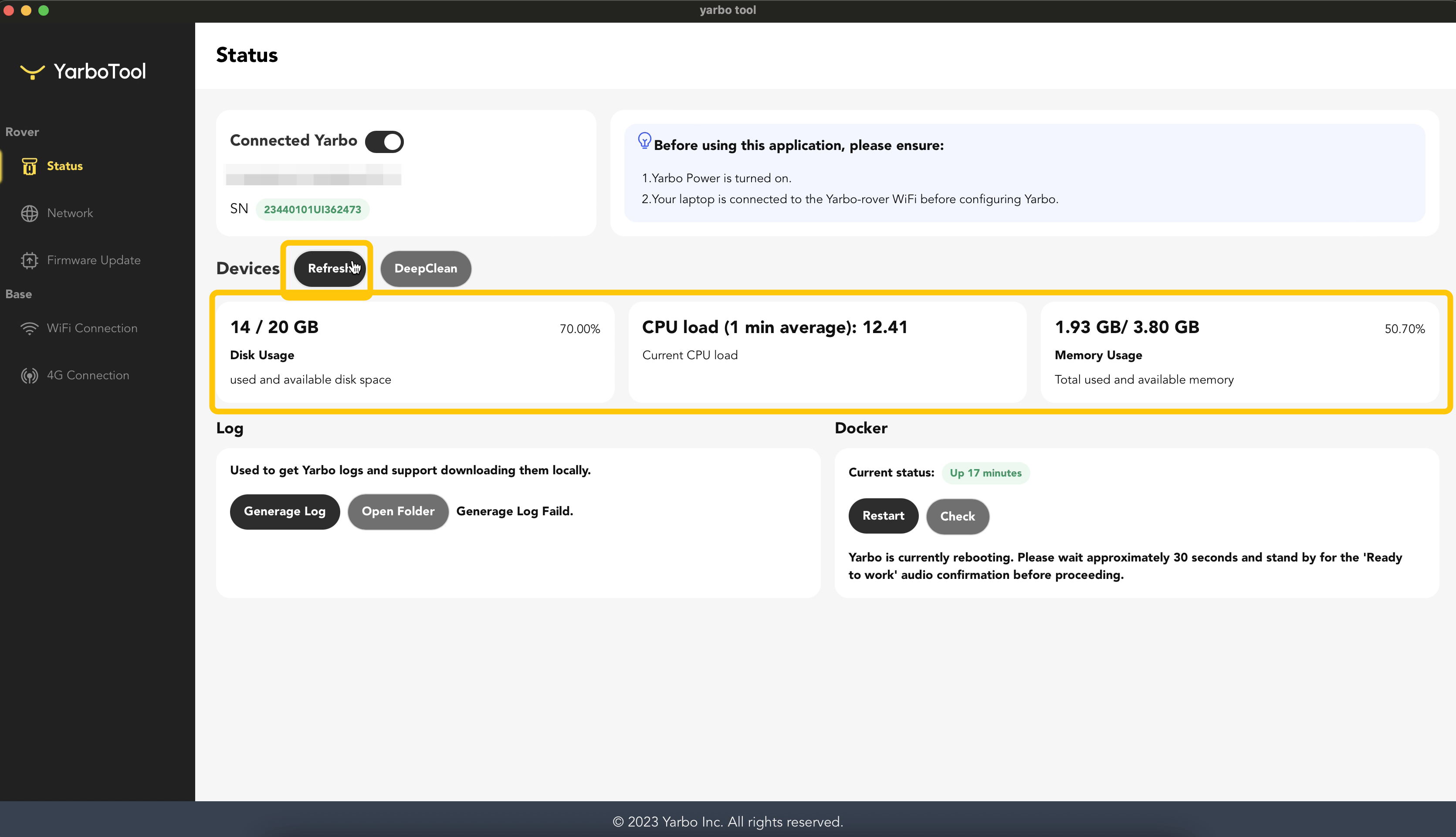

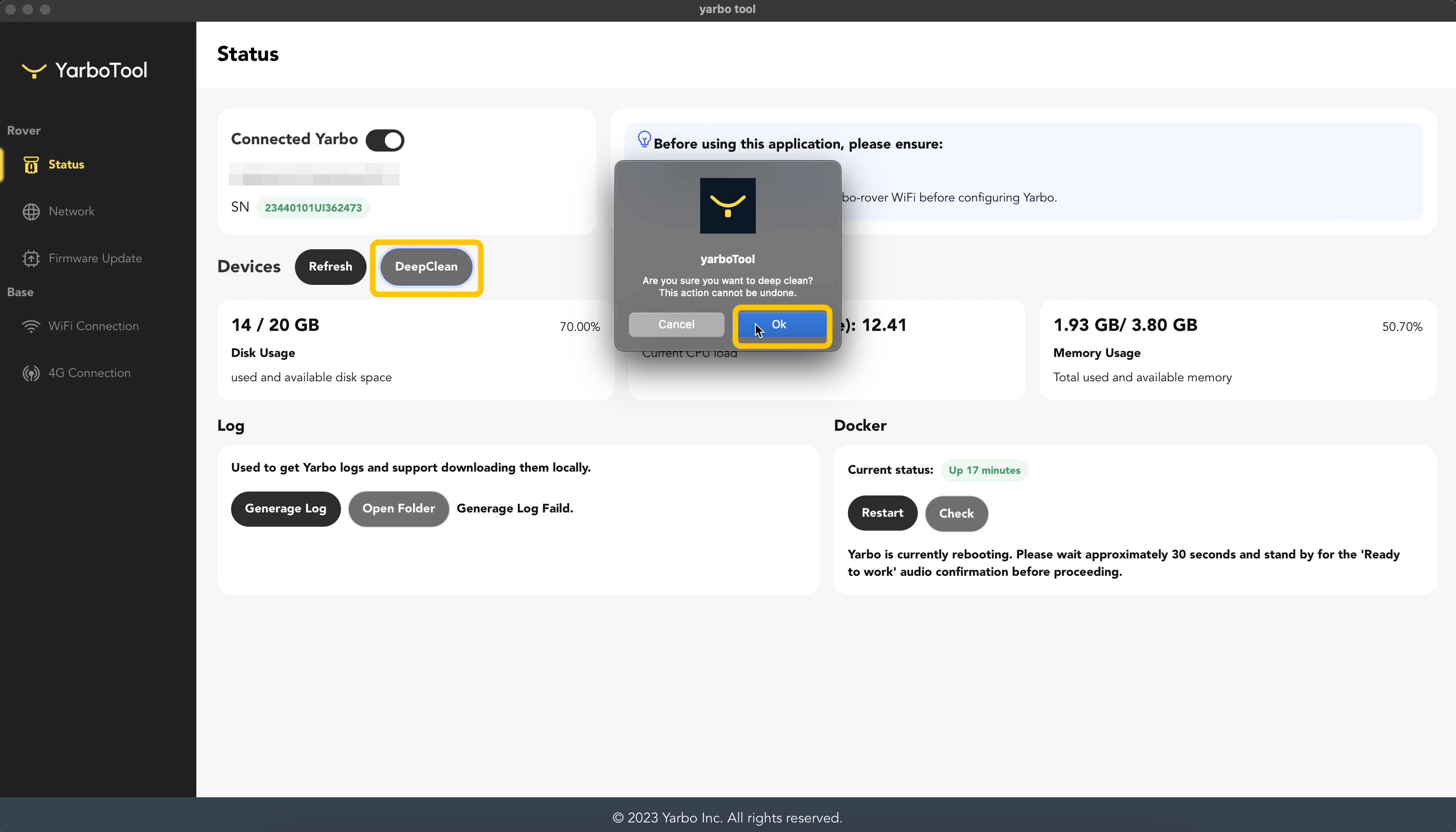

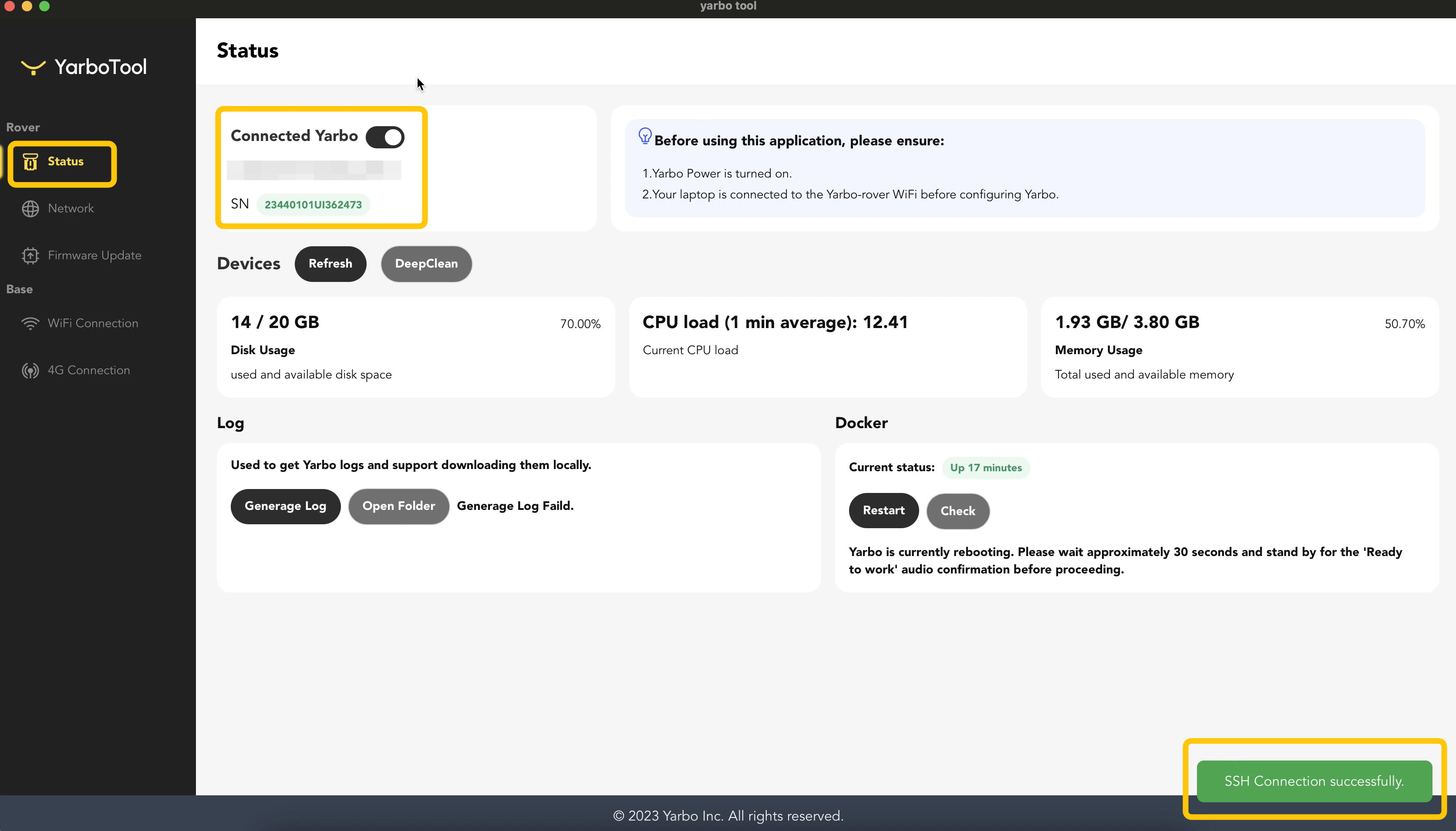

- The rover is stuck displaying colorful lights and will not reboot. 【Rover->Status->Deep Clean】【Rover->Status->Docker->Restart】
- Remote debugging is required, but there is no internet connection available【Rover-> Network-> Wifi Connection and 4G Connection】

- Generating log files: When troubleshooting complex issues or when requested by the support team for further analysis.
- Restarting within Docker: If the Yarbo device encounters software-related issues that may be resolved by restarting within the Docker environment. This action is typically taken after other troubleshooting steps have been exhausted and when software instability is suspected as the cause of the problem.
