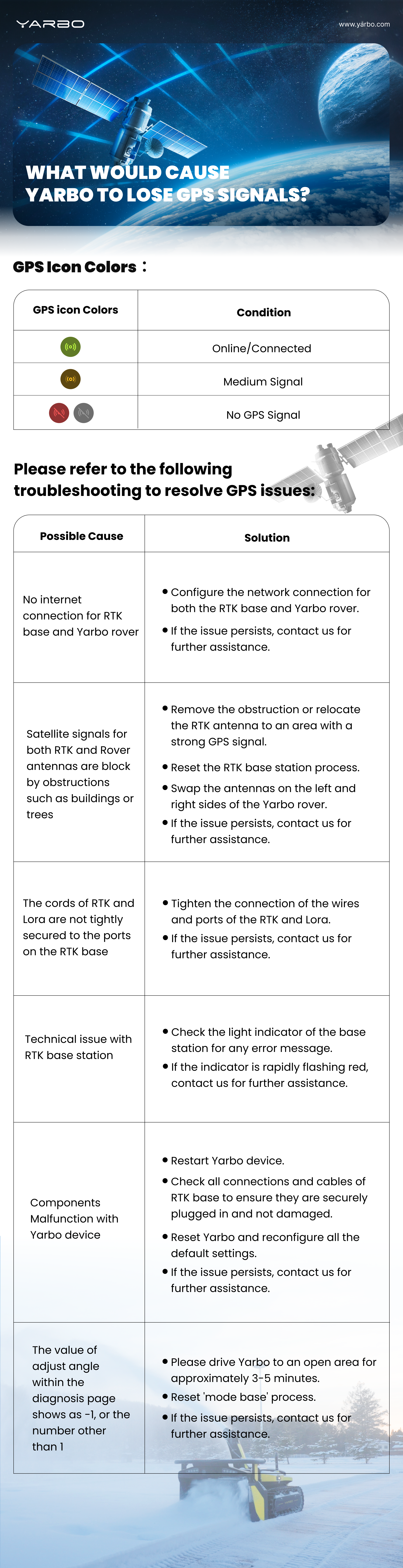

On our app, you will find a network signal indicator and a GPS signal indicator. The network signal indicator represents your internet connection, whether it is through Wi-Fi or a 4G hotspot. The GPS signal indicator represents the stability of your ...
