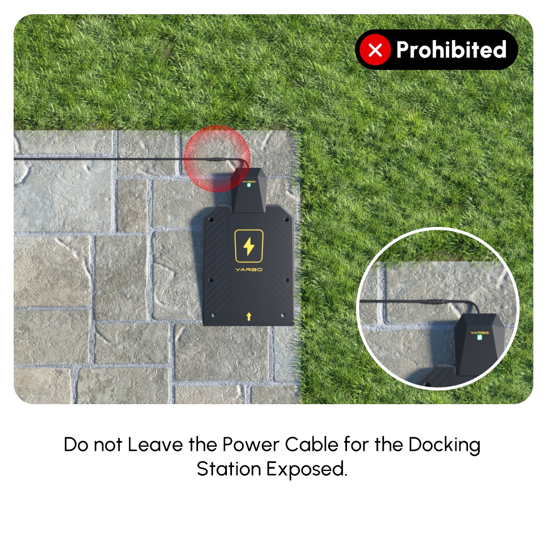

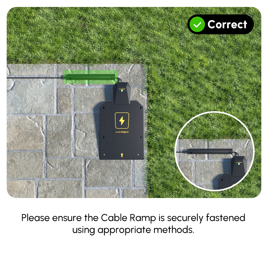

Installation Necessity and Cable Protection: Securing the Cable Ramp is crucial to safeguard the Power Cable. When users install the Docking Station close to a wall, a weak GPS signal may occur, causing Yarbo to veer away from the Docking Station. This could prompt the Auger to initiate snow-clearing operations, potentially leading to accidental damage of the Power Cable and posing a risk of serious injury.
