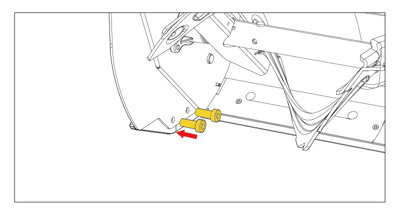

Step 1: Insert the bolts through the designated holes on the auger housing.

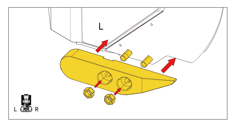

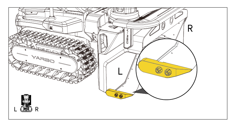

Step 2: Attach the Skid Shoes onto the bolts for both the left and right sides. Utilize the nuts from the provided bag to securely connect the Skid Shoes to the auger housing.

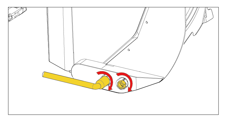

Step 3: Using Allen Key #2, firmly tighten the nuts to ensure a secure and stable installation.
