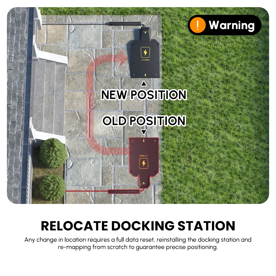

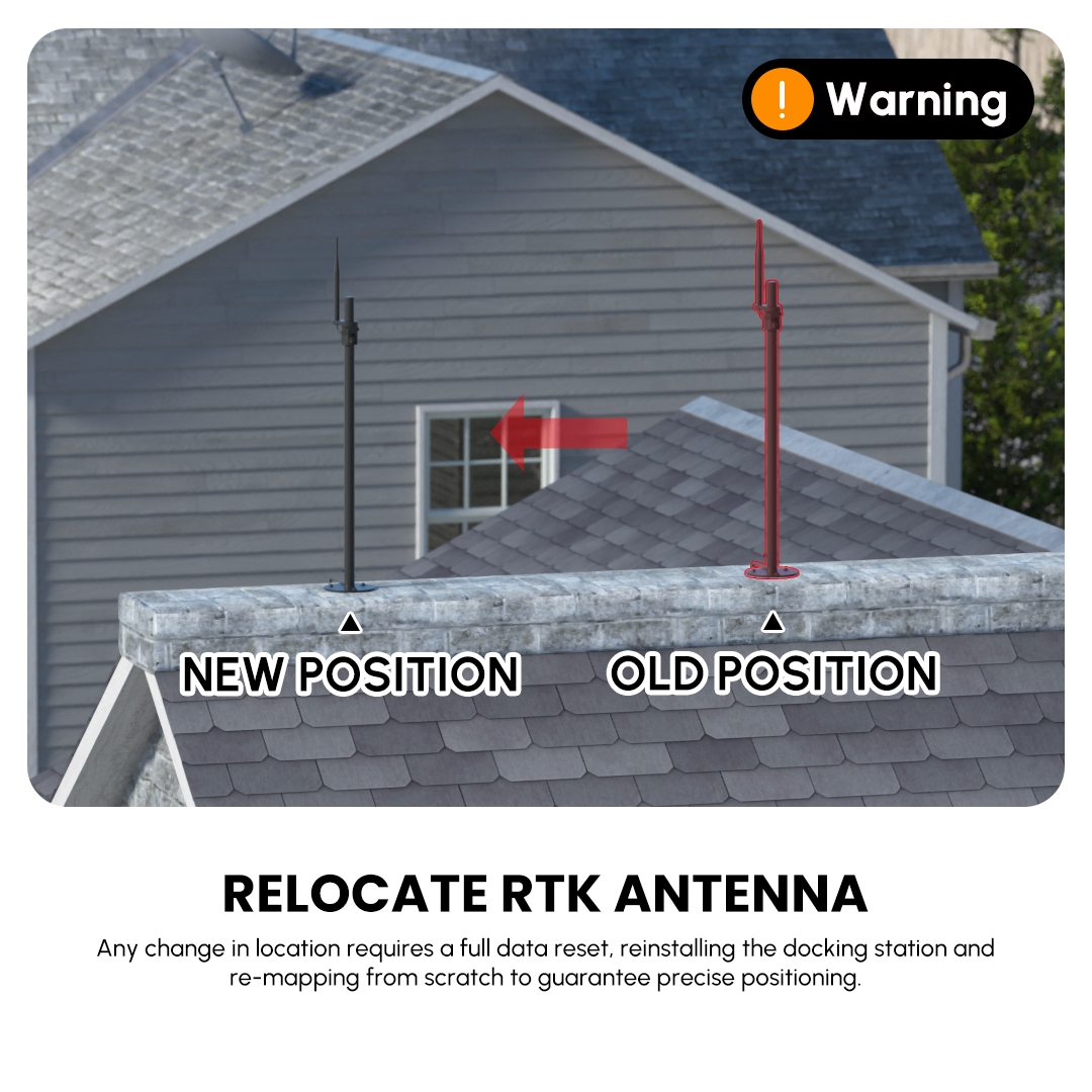

What if I want to relocate the Docking Station or RTK antenna?
Once your docking station and RTK antenna are set up, we advise not moving them. But if you need to relocate them, make sure to follow the instructions for "Reinstall the docking station" and "Reinstall the RTK" in the app. This is important because all current data needs to be cleared.
The entire map used by Yarbo's auto-plan is built based on the exact location of the RTK. If you move these components, you'll need to recreate the map from the beginning to ensure accuracy.
  If you have any further questions or need assistance, please feel free to send an email to support@yarbo.com.

      DO NOT change the location of the RTK or the Docking Station. Any change in location requires a full data reset, reinstalling the docking station and re-mapping from scratch to guarantee precise positioning.
    • Where should I position the docking/charging station?
      Before installing the docking station, it is important to make the necessary preparations: Concrete & Brick Ground Grass Ground Impact Drill + Expansion Bolts Steel Nails or Grass Pegs Next, to ensure optimal functioning of your Yarbo, follow these ...
    • What if I want to relocate the RTK antenna?
      If the RTK antenna is moved to a different position, the current auto-plan map would need to be deleted and recreated. The entire map is constructed based on the precise location of the RTK. The logistical positioning of the map would be shifted ...
    • Securing the RTK Antenna
      Make sure the RTK Antenna structure is securely fastened. Any movement in the structure of the antenna will directly affect the accuracy of Yarbo’s positioning.
