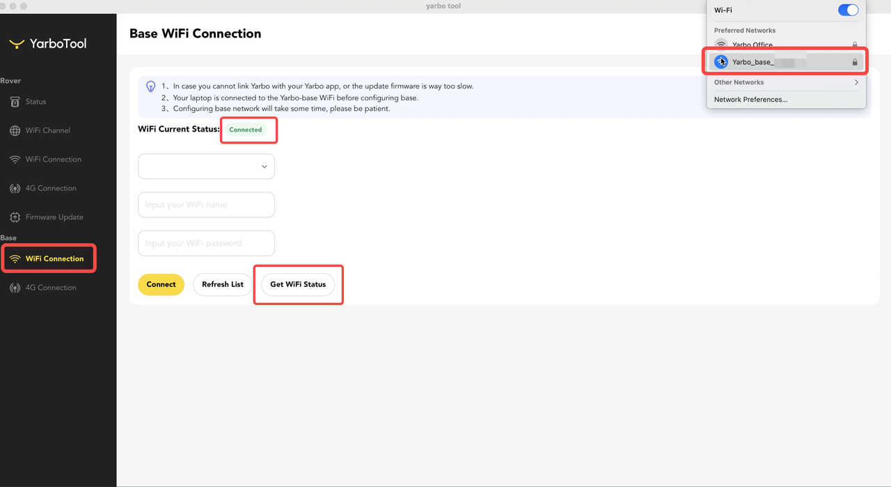

If you encounter difficulties connecting the RTK Base to the Wi-Fi network using your mobile device, consider using the Yarbo Tool for further troubleshooting. Please follow the steps below:
Step 1: Download and Install Yarbo Tool, ensure you have the latest version of the Yarbo Tool installed on your laptop.
Step 2: Connect your laptop's WiFi to the Yarbo base's hotspot, named something like "Yarbo_base_XXXXXX.” The initial connection password is set to "87654321."
Step 3: Open the Yarbo Tool application on your laptop and navigate to the "WiFi Connection" in the Base section.
Step 4: Click on "Get WiFi Status" to verify a successful connection to Yarbo base's hotspot. The WiFi Current Status should display as "Connected."

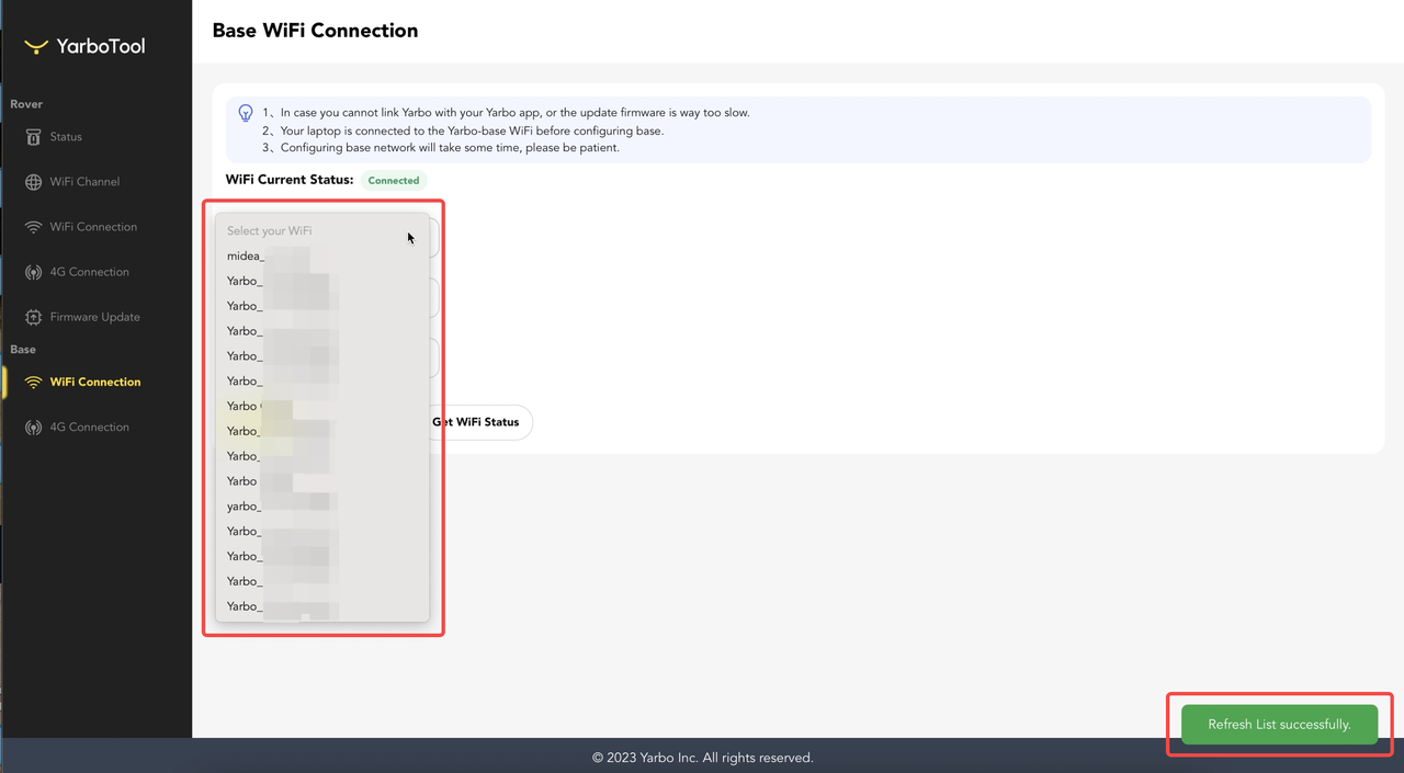

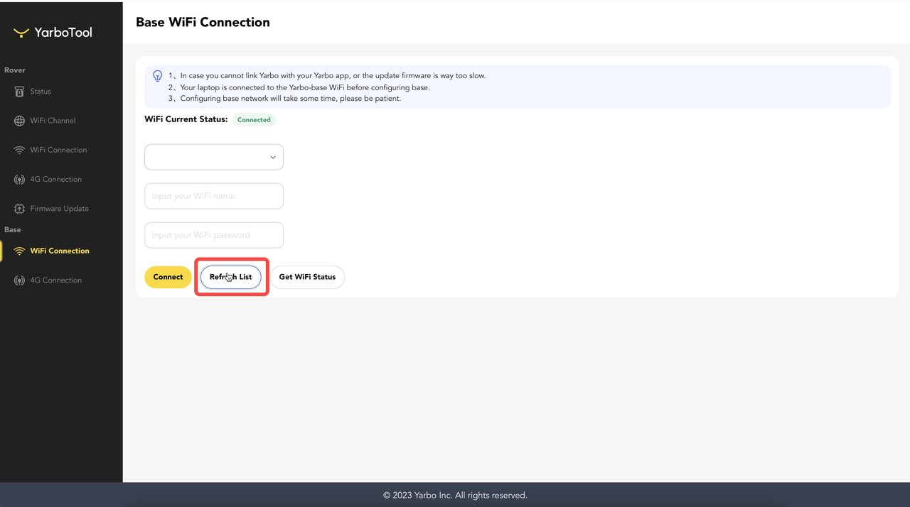

Step 5: Click "Refresh List" and be patient as the list loads. This may take a moment.
Step 6: Choose the desired WiFi SSID from the drop-down menu, enter the correct WiFi password, and then click "Connect."
Step 7: Once again, click on "Get WiFi Status" to confirm a successful connection to the Yarbo base's hotspot via WiFi. The WiFi Current Status should now show as "Connected."
