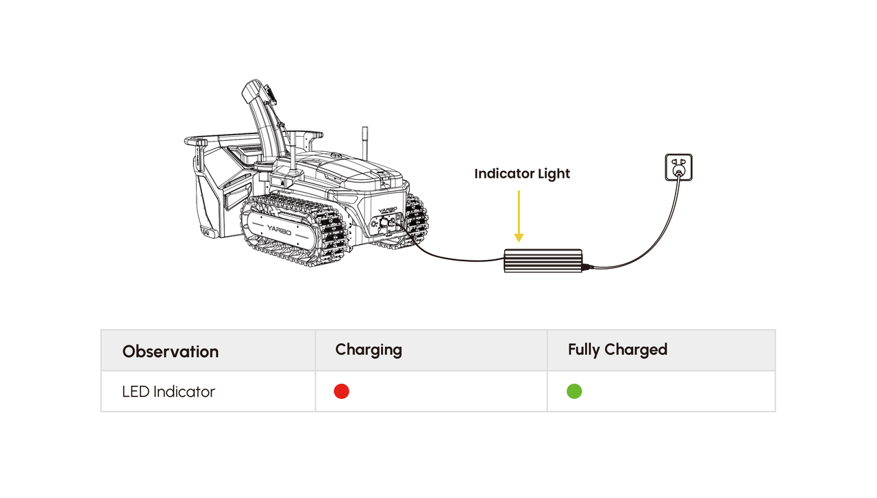

Charging Yarbo with the Wired Charger:
- Before charging Yarbo, check the voltage switch on the wired charger and set it to your home's AC voltage.
- Connect the wired charger to an electrical outlet and the charging port under the rear cover of Yarbo.
There are a few things to keep in mind when using a wired charger to charge Yarbo.
- Check the cable and connectors: Inspect the charging cable for any signs of damage or fraying. A damaged cable should be replaced to ensure safe and efficient charging. Also, please ensure that the connectors are clean and free from debris or dirt, as this can affect the charging process.
- Connect securely: When connecting the charger to Yarbo, please ensure a secure and snug connection. A loose connection may result in slow or interrupted charging. Double-check that the charger is firmly plugged into both Yarbo and the power source.
- Ensure compatibility: Please ensure that the wired charger you are using is compatible with Yarbo. Check the charger's specifications and ensure it provides the appropriate voltage and current for charging Yarbo.

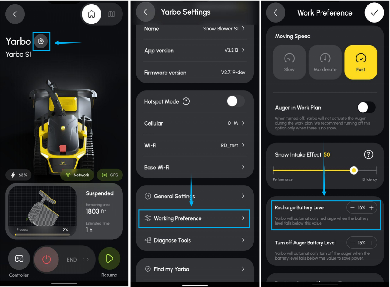

Increase the recharge value
Increase the recharge value for the battery within the Work Preference page from the Yaro Settings. Yarbo will automatically navigate back to the docking station once the battery level falls below the designated threshold during the work plan.
