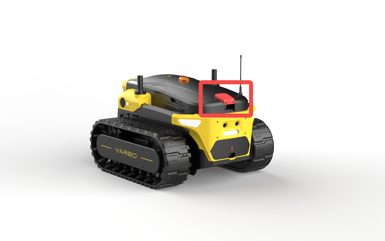

  1. Use the Emergency Stop Button: Press the emergency stop button to ensure the mower is completely powered off. The position of the button is shown below.
