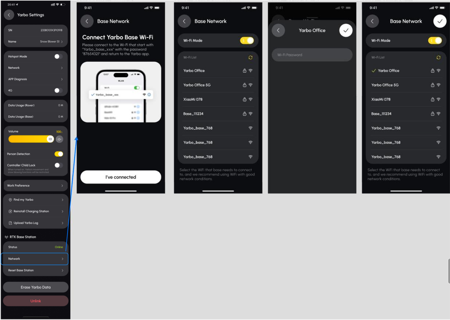

Step 1: Connect to Yarbo Base Hotspot
1. Open your mobile device and ensure that the Wi-Fi feature is enabled.
2. Access the Wi-Fi settings on your mobile device.
3. In the Wi-Fi network list, locate and select the Yarbo Base you want to operate. The default hotspot name should be something like "Yarbo_base_XXXXXX".
4. For the initial connection, enter the default password (87654321).
5. Wait for your mobile device to successfully connect to the Yarbo Base hotspot.
Step 2: Configure Yarbo Base and Connect to Wi-Fi Network
1. Open the Yarbo app, select the desired Yarbo device, and click on the settings option. Scroll down and click on "Network" in the RTK Base Station section to access the device's Wi-Fi configuration page.
2. In the Yarbo APP, select the Wi-Fi network you wish to connect to and enter the password.
3. Ensure the entered Wi-Fi password is accurate, then click the confirm button.
4. The Yarbo Base will attempt to connect to the specified Wi-Fi network. Please wait for a successful connection, which may take approximately 1-2 minutes. If needed, you should manually click the refresh button during this waiting period.
