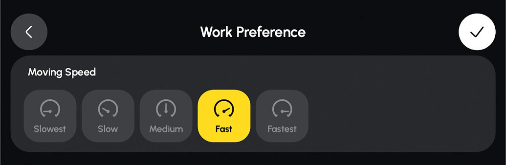

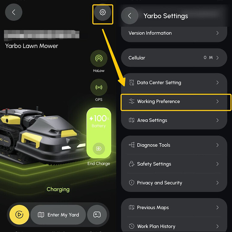

  1. Moving Speed in “Work Preferences”
Go to the main page and tap the settings icon in the top-right corner. Then, select “Work Preferences”, where you can adjust the moving speed.
working preference
moving speed
In the “Work Preferences” page, you can adjust the moving speed of your Yarbo lawn mower, with five speed levels ranging from 0.3m/s to 0.65m/s:
  • Slowest/Slow/Medium/Fast/Fastest:
Increasing the moving speed reduces the overall mowing time. However, it’s important to note that mowing speed can affect the cutting quality: faster speeds may reduce precision, while slower speeds typically result in a cleaner, more precise cut.

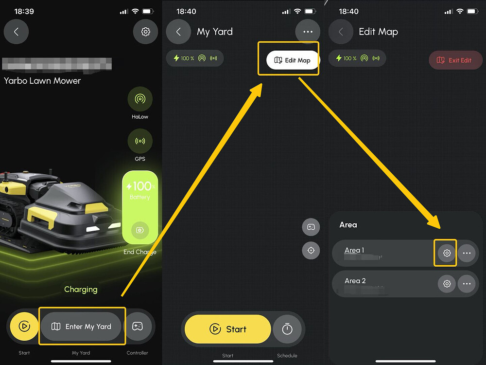

  1. Turning Mode in Area Settings
To find the area settings, simply follow these steps:
Edit map

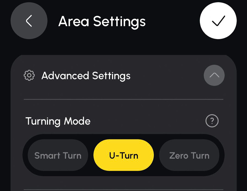

There are three turning modes available to help navigate different lawn shapes:
  • Smart Turn: This mode involves a precise 3-step maneuver, perfect for tight spaces. While it causes less strain on the grass, it takes more time to complete.
  • U-Turn: When selected, the Yarbo will make a large U-turn, reducing turning time compared to the Smart Turn, but it may be less gentle on the lawn.
  • Zero Turn: The most efficient turning mode, ideal for wide, open spaces. However, it may be less gentle on the lawn compared to other modes
    Turning mode

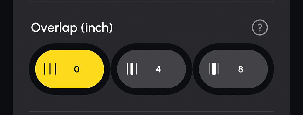

  1. Overlap in Area Settings
In the Area Settings, you can adjust the overlap, which impacts mowing efficiency:
  • A lower overlap reduces overall working time.
  • However, a lower overlap increases the risk of uncut grass. We recommend experimenting with the overlap setting to find the balance that works best for your lawn.
    overlap setting

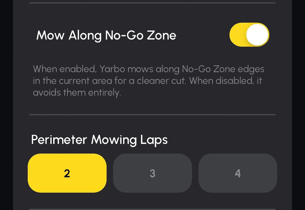

  1. Mowing Along No-Go Zones and Perimeter Mowing Laps
When you enable “Mow Along No-Go Zones,” Yarbo will mow along the edges of the no-go zones. This may increase the total mowing time.
Similarly, adjusting the Perimeter Mowing Laps setting will determine how many laps Yarbo makes around the perimeter. More laps mean more time spent on the task.
perimeter mowing
