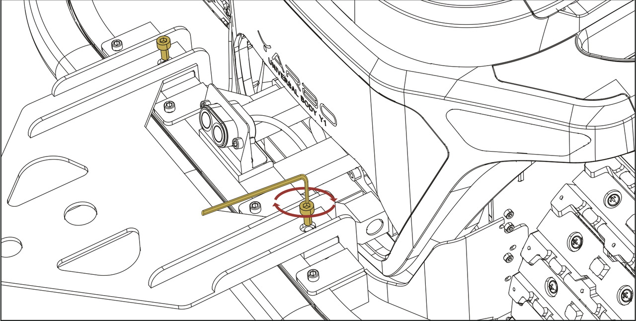

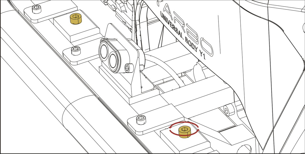

Remove the Rear Cover Bolts
- Locate the New Rear Cover on your lawn mower.
Using an Allen Key #4, unscrew the two bolts securing the New Rear Cover. Keep these bolts aside for later use.

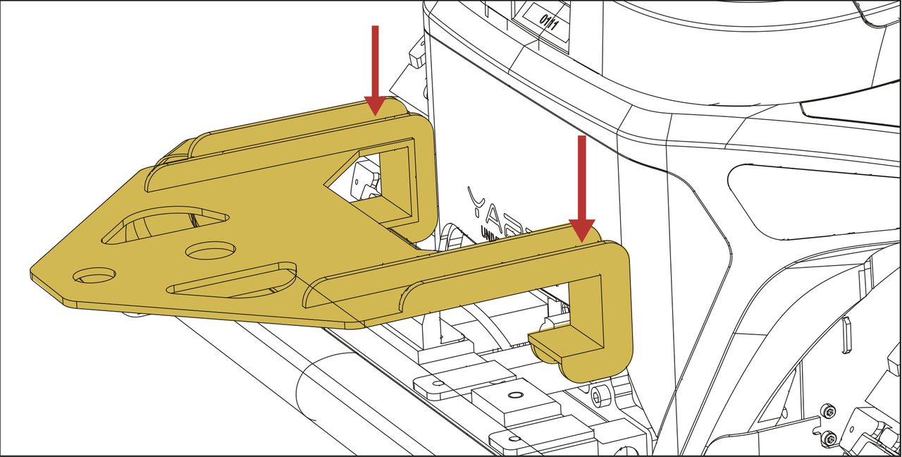

Position the Tow Hitch
Align Bolt Holes
- Align the bolt holes on the Tow Hitch with the corresponding bolt holes on the New Rear Cover.
Secure the Tow Hitch
- Insert the two bolts you previously removed through the aligned holes of the Tow Hitch and the New Rear Cover.
- Tighten the bolts using the Allen Key #4 until the Tow Hitch is firmly secured to the New Rear Cover.
Final Check
- Ensure all bolts are tightened securely and the Tow Hitch is firmly attached.
- Test the stability of the Tow Hitch to make sure it is properly installed.
