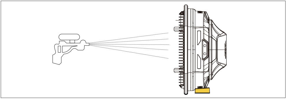

- Detach the lawn mower from the universal body.
- Raise the lawn mower from the side and place the lawn mower on Module Vertical Stand, please refer to the following picture.
- Utilize a high-pressure water gun or water hose to clean the underside of the lawn mower. Do not spray the water into the universal body to prevent damage. Please avoid using solvents or large amount of liquid on plastic components, as commercial solvents can potentially harm the appearance and integrity of your Yarbo.
- Wipe off the water with a clean rag.
- Put the mower module in a clean, dry, ventilated room with moisture-proof and anticorrosive measures.
