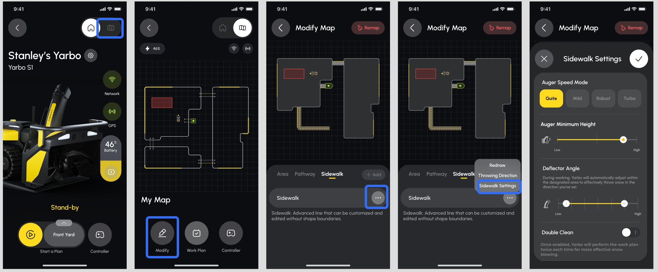

What can you do with the sidewalk settings?
- Auger Speed Mode:
Function: Controls the auger speed with four distinct modes, Quiet, Mild, Robuts, and Turbo. This component is responsible for collecting and processing snow.
Description: Auger Speed Mode allows you to set the operating speed of the auger. Different snow conditions may require varying speeds for optimal performance. Choose the mode that best suits the current snow characteristics, ensuring effective snow removal.
Difference between four distinct modes:
![](https://static.zohocdn.com/zoho-desk-editor/static/images/info.png)
Characteristics: Operates at a lower speed with reduced noise output.
Use Case: Ideal for situations where minimizing noise is a priority, such as in residential areas during early morning or late evening.
Characteristics: A moderate speed setting, balancing performance and noise level.
Use Case: Suitable for typical snow conditions, providing a good compromise between efficiency and noise output.
Characteristics: Runs at a higher speed for more aggressive snow removal.
Use Case: Effective for heavier snowfall or denser snow conditions, providing increased power and performance.
Characteristics: Maximal speed setting for the most demanding snow removal tasks.
Use Case: Designed for extreme snow conditions or large snow accumulation, offering the highest level of power and efficiency.
- Auger Minimum Height:
Function: Sets the minimum height of the auger above the ground level.
Description: This feature determines how close the auger comes to the ground. Adjusting the Auger Minimum Height is crucial for preventing damage to the device and ensuring efficient snow removal. Setting an appropriate minimum height avoids unnecessary contact with the ground and potential obstructions.
- Deflector Angle:
Function: Manages the angle of the deflector, which directs the expelled snow.
Description: The Deflector Angle determines the direction in which the snow is thrown. By adjusting this angle, you can control where the cleared snow is deposited. This feature is particularly useful for directing snow away from specific areas or pathways.
- Double Clean:
Function: Enhances cleaning efficiency by instructing Yarbo to make a second pass over specific areas.
Description: The Double Clean feature improves the thoroughness of snow removal by directing Yarbo to revisit designated sections. This can be beneficial in situations where additional cleaning passes are necessary for optimal results, such as in heavy snowfall or stubborn snow conditions.
