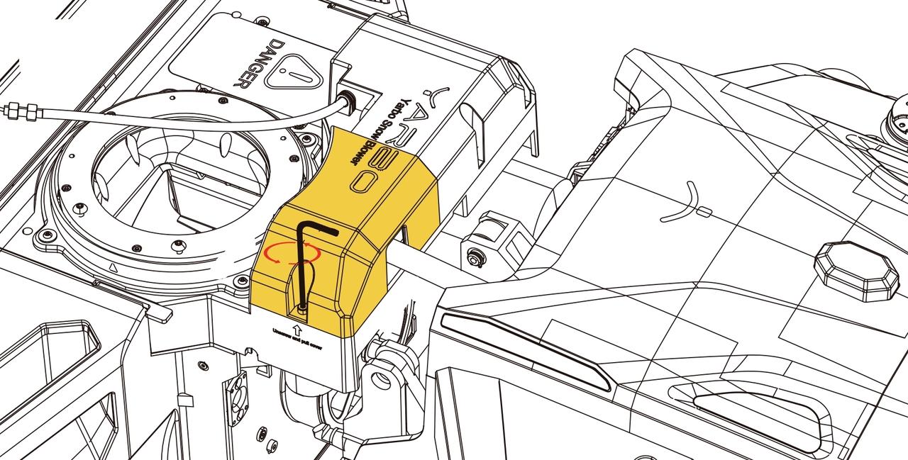

The removable protective cover located at the power connection on Yarbo’s front end is essential for shielding the connection from external elements like moisture, dust, and debris. Proper installation of this cover ensures Yarbo's reliable performance and protects the internal components from potential damage.
Installation Checklist
After attaching the clearing module, take a moment to verify that the protective cover is securely in place over the power connection. Make sure the cover is fully attached and locked into position. This step is crucial to prevent any exposure that could compromise Yarbo's operation.
Impact of Improper Installation
Operating Yarbo without the protective cover properly secured may lead to moisture or debris entering the connection point, causing potential malfunctions. Regularly checking the cover's installation before use can prevent performance issues and extend Yarbo's lifespan.
Best Practices for Winter Maintenance
During the winter season, it's important to regularly clear any accumulated snow around the cable cover. This prevents the cover from freezing in place, which could make removal difficult and potentially damage the connection.
