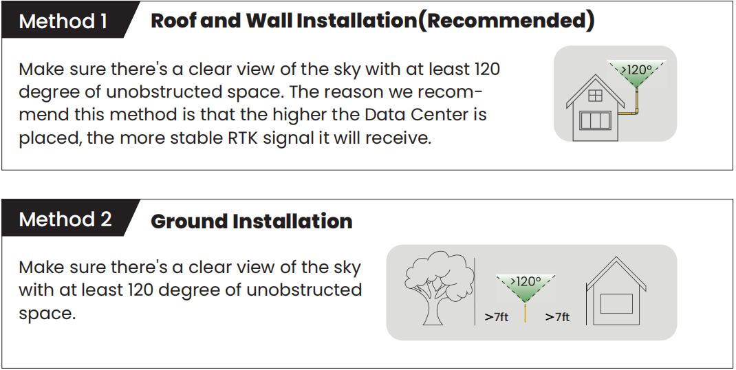

Optimal Installation Guidelines for the Data Center Set
The key consideration when installing the Data Center Set is to ensure it has an unobstructed 120° view of the sky. This is essential for optimal operation. Please select the installation method that best suits your home environment.
Additionally, the Data Center requires a wired network connection. We provide a 30-meter Ethernet cable, but it’s important to choose a location that is close enough to your router while still maintaining the required 120° clear view of the sky.
data center installation methods
⚠️ Important: To ensure the safety of the Data Center when installed on rooftops, it is essential to implement robust lightning protection measures to prevent damage from lightning strikes. In regions where lightning is common, the risk of damage significantly increases. We highly recommend users in high-risk areas purchase a grounding cable, which safely redirects excess electrical current into the ground, thereby minimizing the risk of damage to the Data Center.

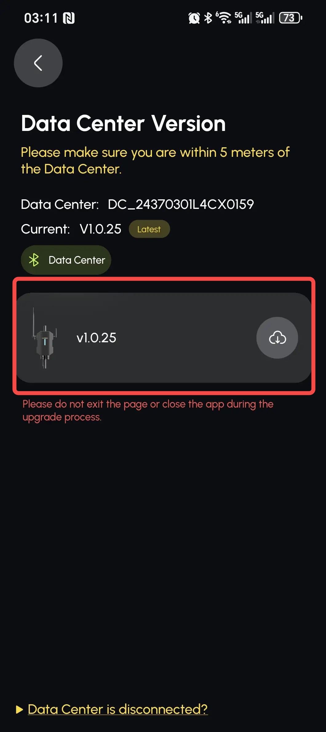

Check the Data Center's Software Version
  1. An outdated version may be causing this issue. Verify if the Data Center's software is up to date.
Main page -> Setting Icon-> Data Center Setting->  Data Center Version
app main page
data center settingconnect data centerdata center versiondata center update
  1. If a download button appears as shown, it indicates that a new version is available for download. After downloading the new version update patch, a prompt will appear stating, "The new version of Data Center was downloaded successfully. Please click the button to update." Click the button to complete the update. The entire process typically takes around 15 minutes, depending on network quality.
Note: Please be aware that during the Data Center update process, all connected Yarbo will temporarily halt their operations.
  1. The Data Center's indicator light will reflect the upgrade progress. Once the upgrade is complete, the indicator should display a solid green light. If the light continues to flash green, please proceed to the next step.
