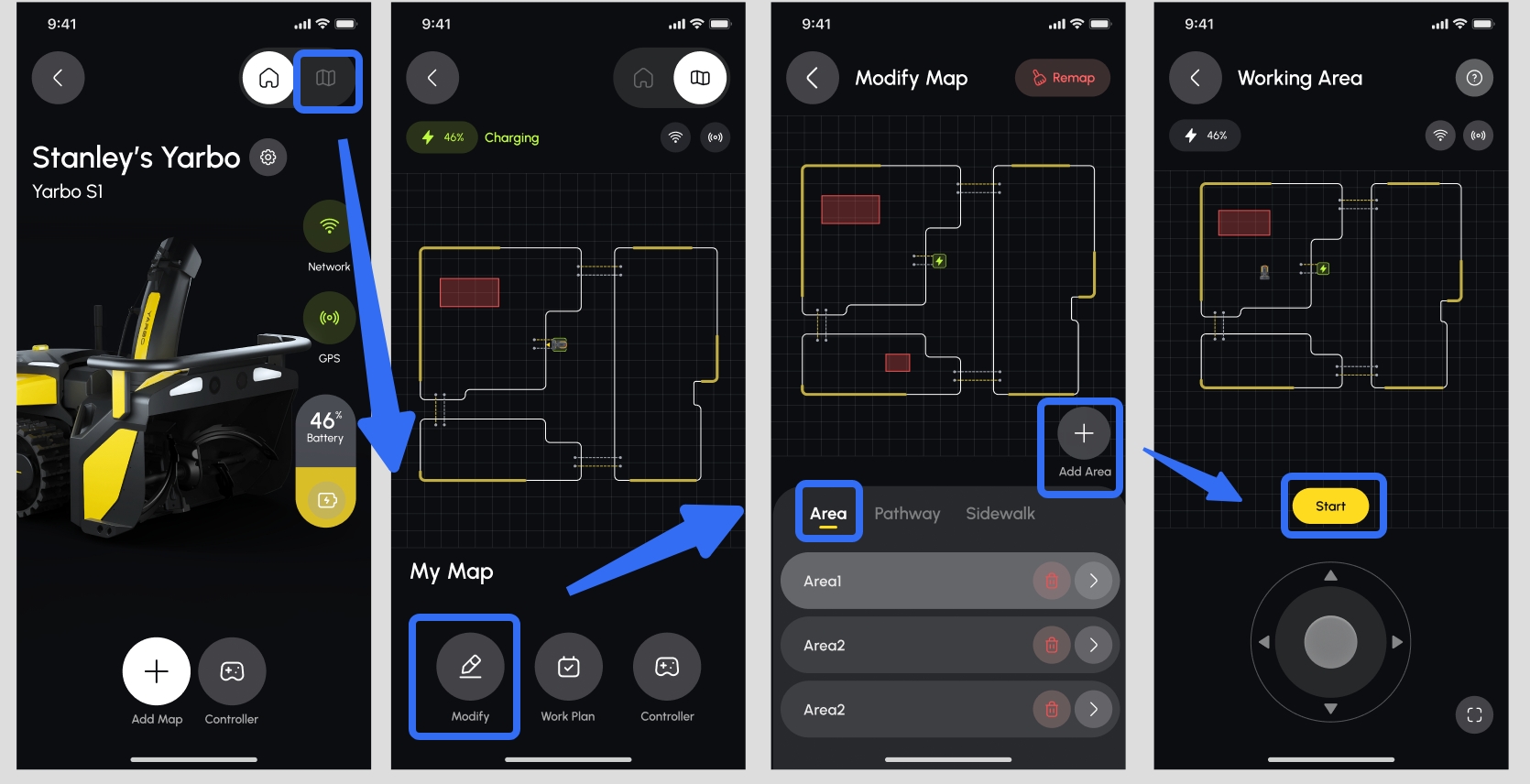

Method 2: Add More Areas from the Modify Page
The additional areas need to be added starting from a specified area. Therefore, you need to first select a specific area. Subsequently, you can start drawing a pathway from this chosen area.
- Navigate to 'My Map' Page: Select the icon in the upper right corner to navigate to the 'My Map' Page.
- Access Area Modification: Click on 'Modify' to access the Area modification mode.
- Initiate Addition Process: Click "Add Area” to start the process of drawing a new area.
- Create a Pathway: Upon finishing mapping of the new work area, draw a pathway to connect it with the previous area.
