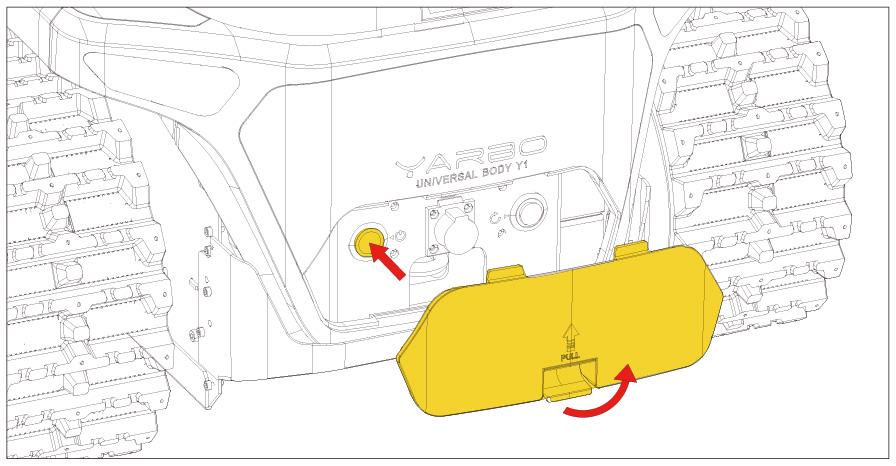

- Remove the rear cover, press the power button to turn off Yarbo(IMPORTANT!).

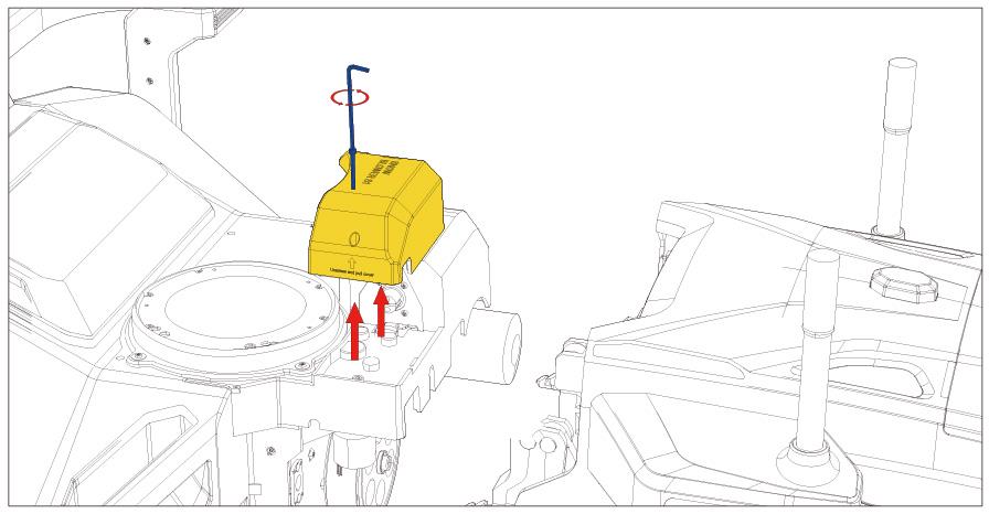

Remove this cover from Snow Blower module, with Allen Key #1.

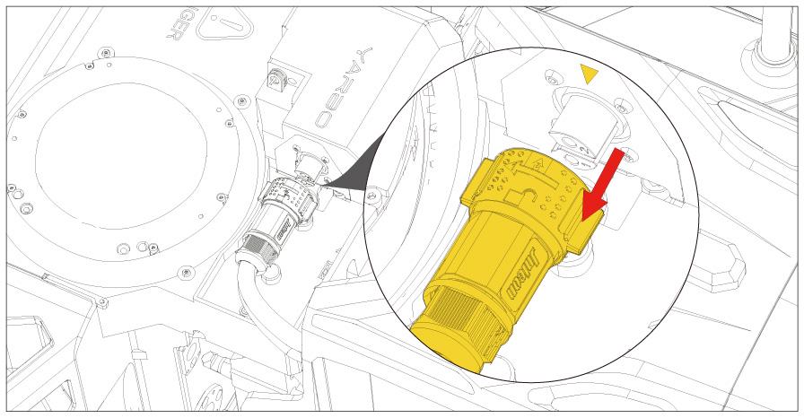

Screw the connector onto the cable as indicated by the sign, then disconnect the female end of the cable.

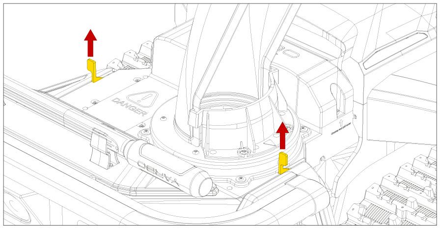

- Lift the Snow Blower Module sightly and then pull up the two lockers on both sides.

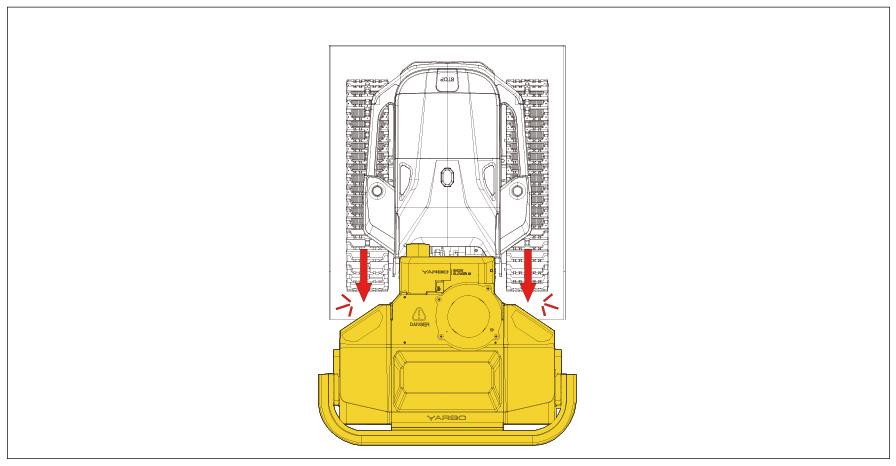

- Pull the Snow Blower Module off by detaching the holes from the shafts.
