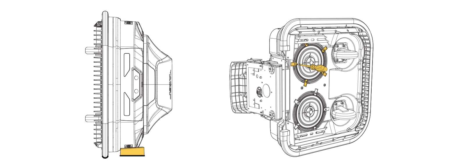

  1. Secure the Mower on the Vertical Stand for Module
      Raise the lawn mower from the side and place it on the Vertical Stand for Module. This stand provides stability and allows you to safely access the underside of the mower. Refer to the image for proper positioning.
  1. Remove the Cutting Blades
      Before handling the blades, wear gloves to protect your hands from sharp edges. Use the Phillips-head screwdriver provided in the lawn mower Box to unscrew the Cutting Blades Bolts.
  1. Install the New Blades
    1. Position the New Blades: Align the hole of the blade and the hole of The Cutting disc.
    2. Secure the Blades: Reinsert the bolts and tighten them with the Phillips-head screwdriver. Make sure the blades are firmly secured to prevent movement during operation.
