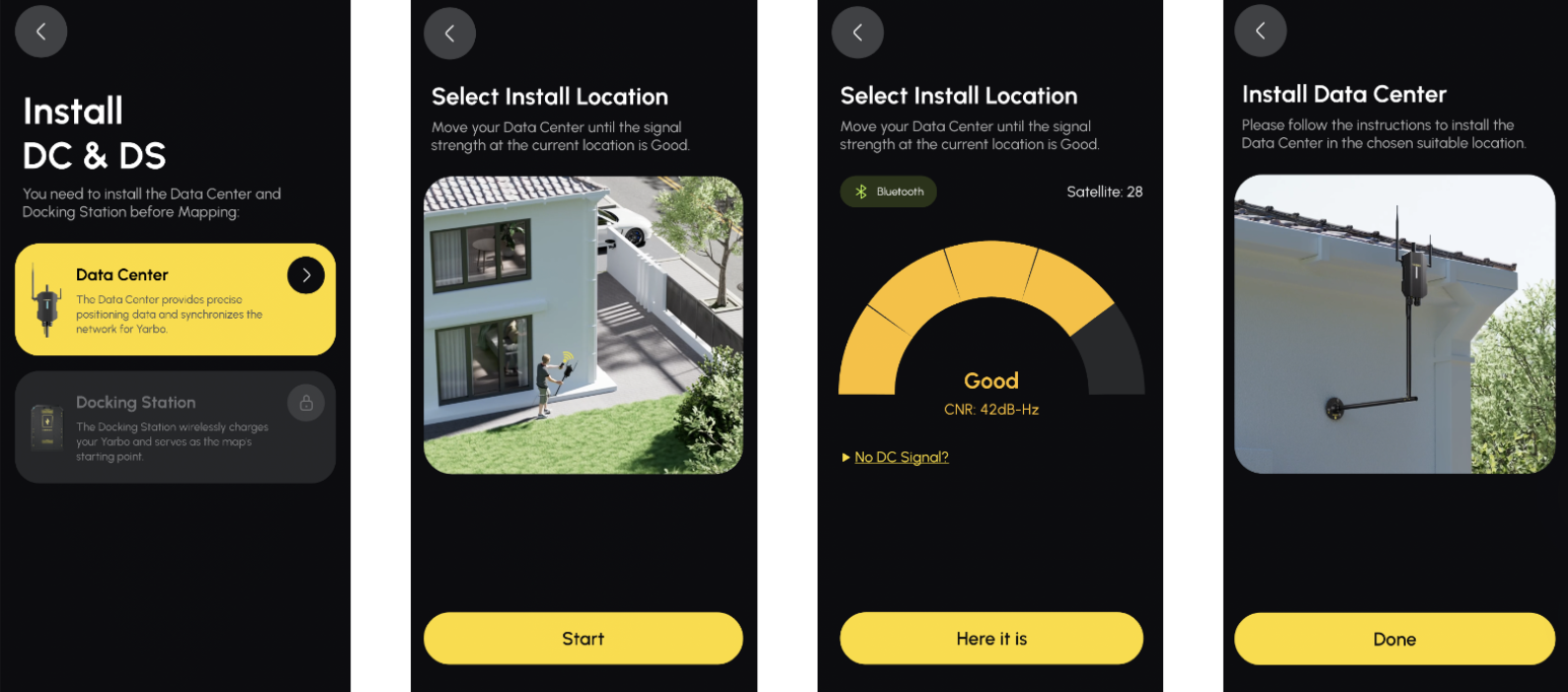

  1. Initiate Relocation Go to the Settings page in the app, select Reinstall Data Center, and confirm Data Center Relocation to begin the process.
    1. Main page -> Setting -> Reinstall Data Center
  1. Move Your Data Center and Device Carry the Data Center in one hand and keep an eye on the signal quality screen
reinstall data center app guide

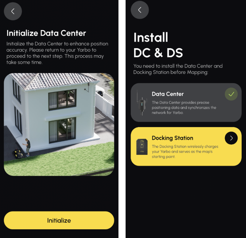

  1. Finalize and Initialize After securely installing the Data Center at its new location, please follow these steps to complete the initialization process, this final step ensures that Yarbo recognizes the new setup and is prepared for optimal operation.
data center installation finilization page
