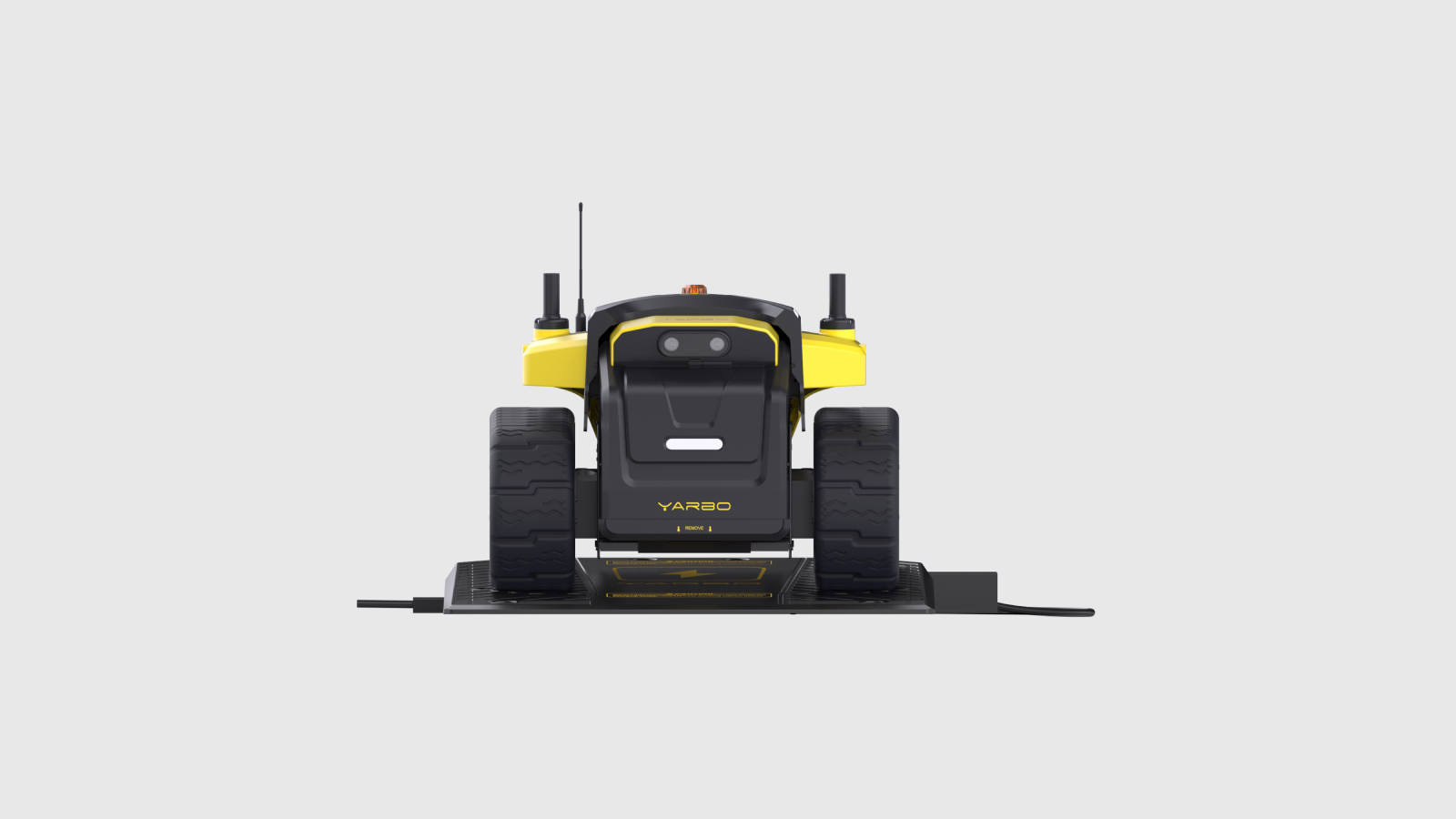

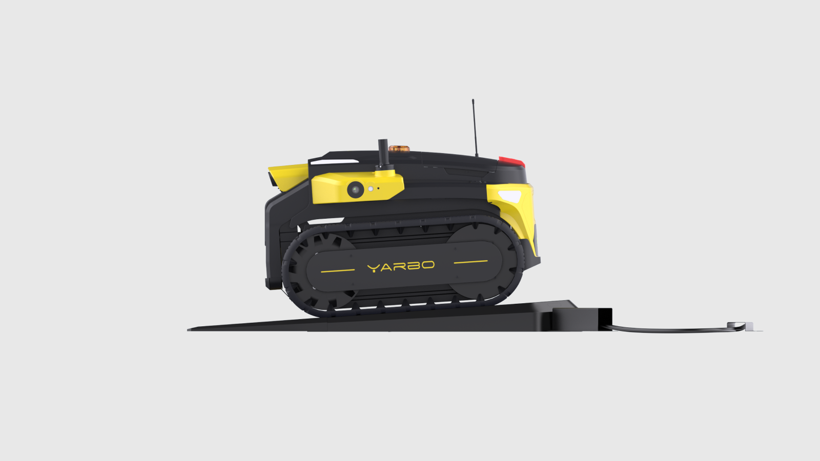

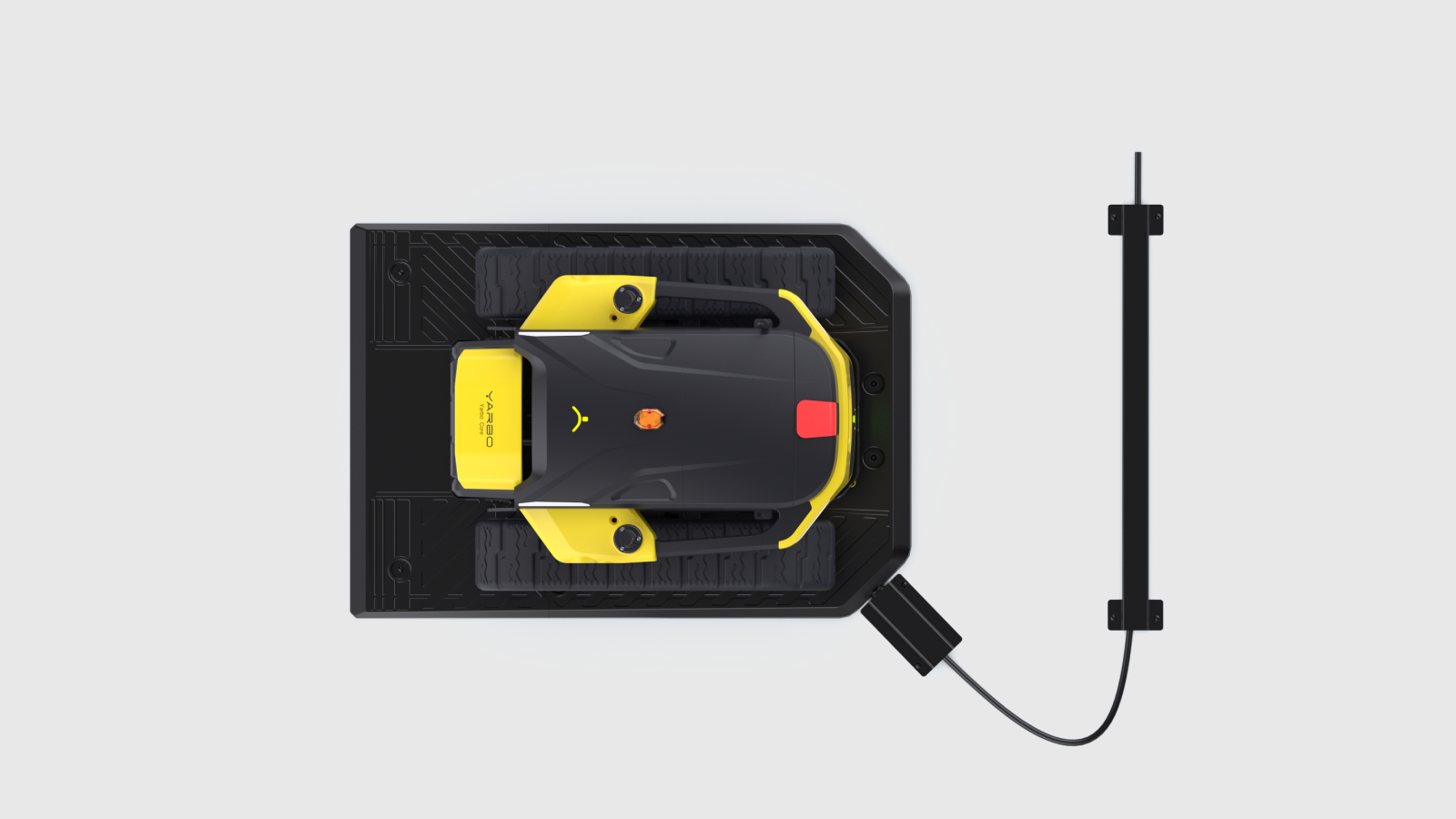

  • Ensure the device and docking station are properly aligned like the following pictures showing:
docking station
By following these steps, you should be able to identify and resolve most charging issues at the docking station. If the problem persists, contact customer support for further assistance.
