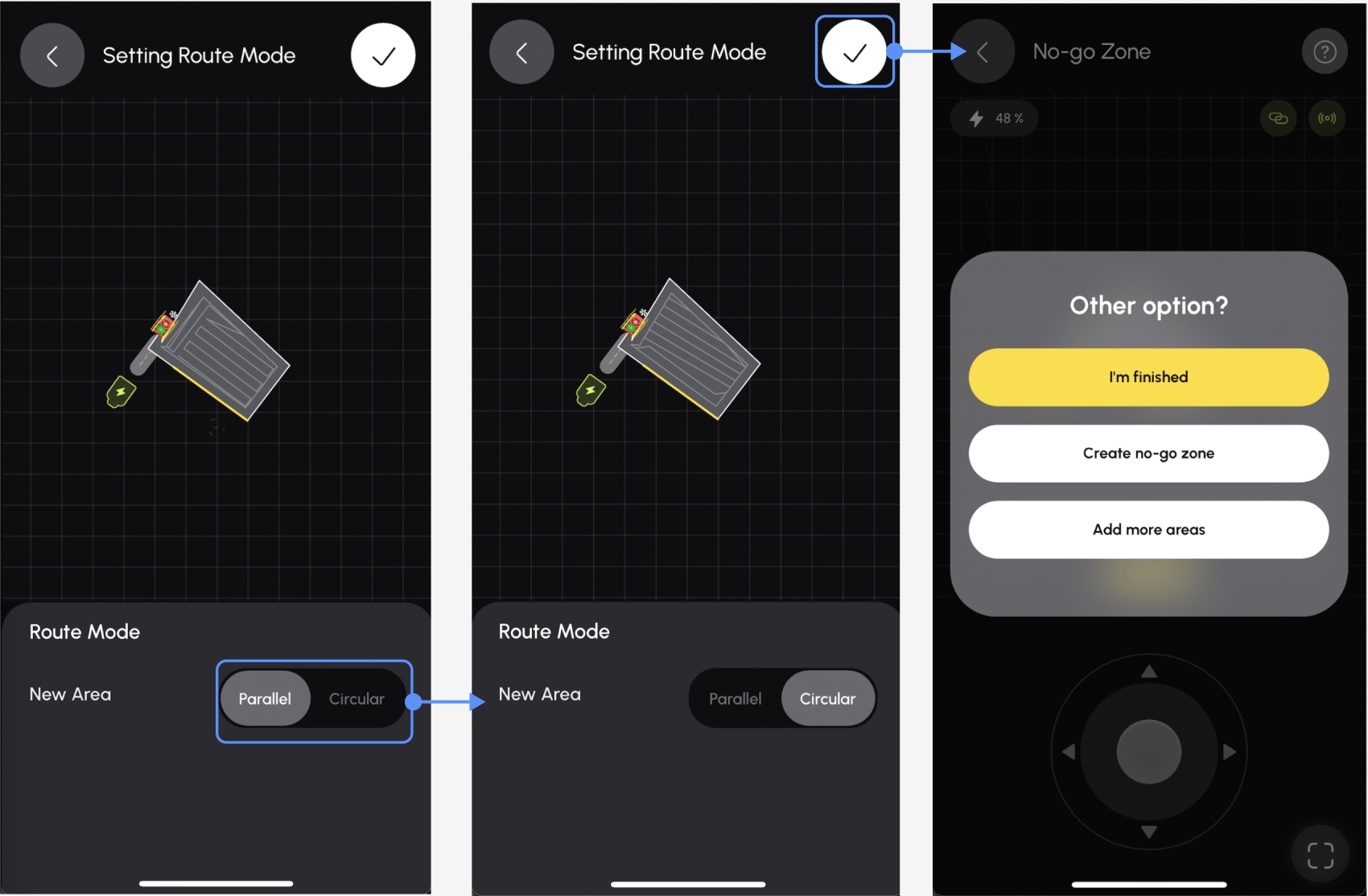

  • The 'Route' refers to the automated working path generated by Yarbo within your workspace. When implementing a plan, Yarbo will follow the route precisely for snow-blowing operations.
  • We offer two route modes, Parallel and Circular, designed to accommodate various driveway shapes and enhance the efficiency of snow blowing operations.
  • For optimal performance in rectangular or polygonal areas, we recommend using Single Grid routes, while Circular routes are advised for circular or ring-shaped areas.

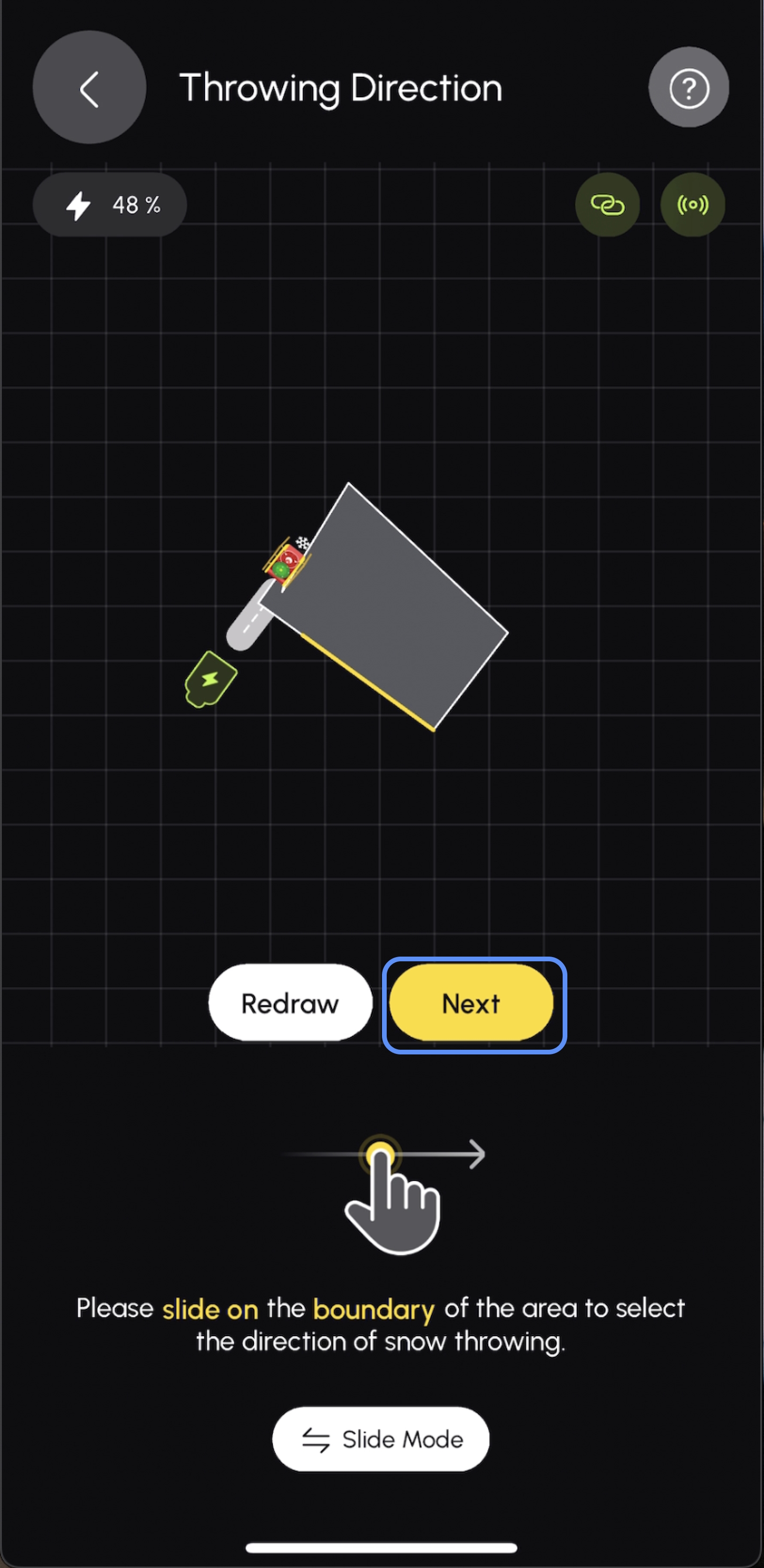

  1. Snow Route Configuration: Upon finishing the snow throwing direction drawing, click "Next" to access the route mode settings.
  1. Mode Selection for Snow Routes: Within the route mode, use the button to switch between parallel and circular modes. Once your preferred mode is selected, click "I'm finished" to advance to the next step.
