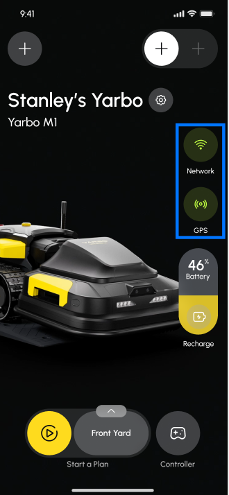

  • 1.The network or GPS signal is weak
        On the app, you will find a network signal indicator and a GPS signal indicor. The network signal indicator represents your internet connection, whether it is through Wi-Fi or a 4G hotspot. The GPS signal indicator represents the stability of your GPS connection. When the signal is "lost" or "weak", the position of Yarbo will be inaccurate, which will cause the machine to go outside the boundary.
        Please try adjusting the RTK antenna to resolve the issue. Additionally, inspect the area around Yarbo to ensure there are no obstructions affecting the signal. If the issue persists, please contact our customer support for additional assistance.
