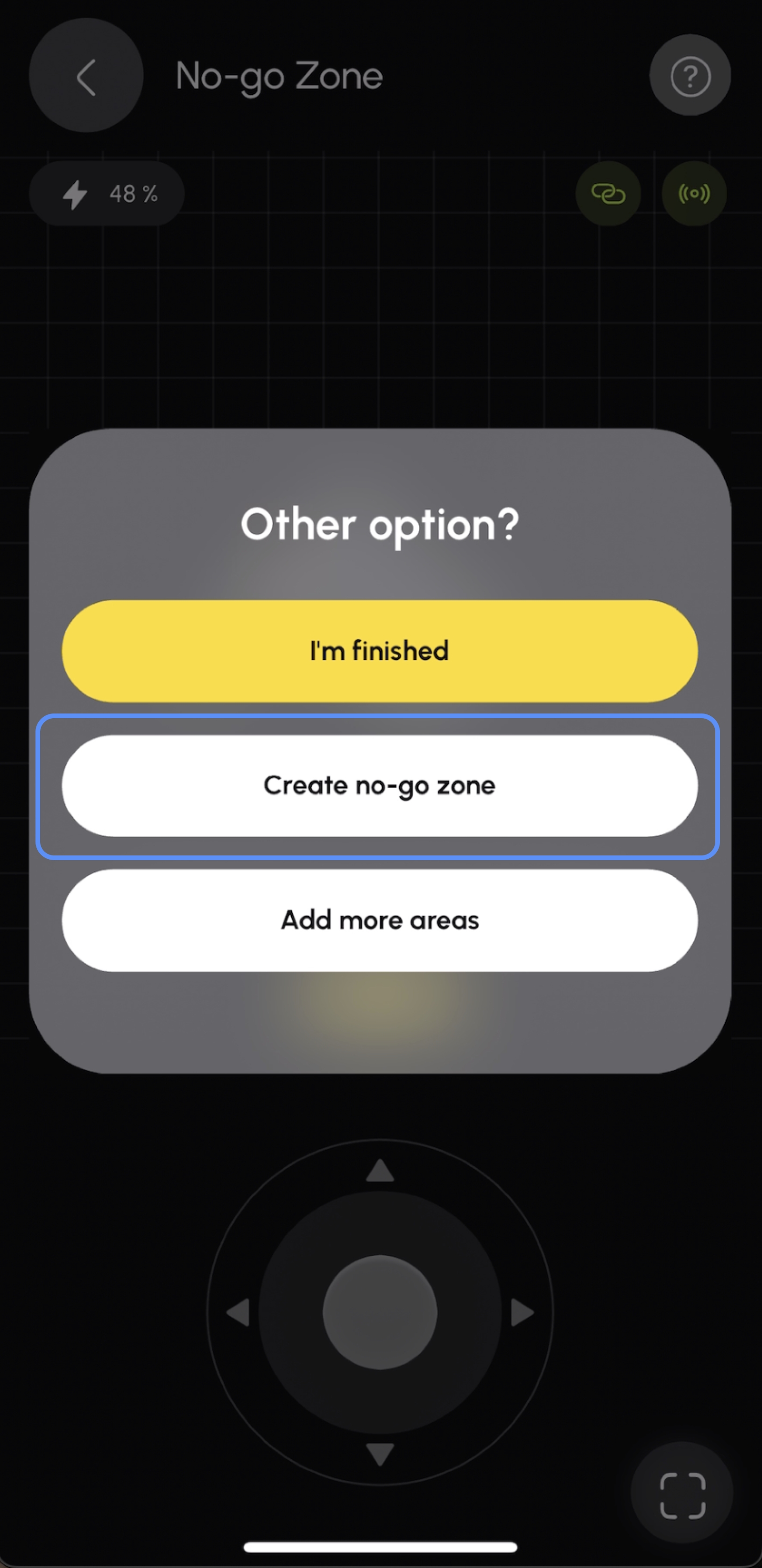

1. Accessing no-go zone creation:
Click on "Create No-go Zone" in the other option pop-up, and you can enter the restricted zone drawing.

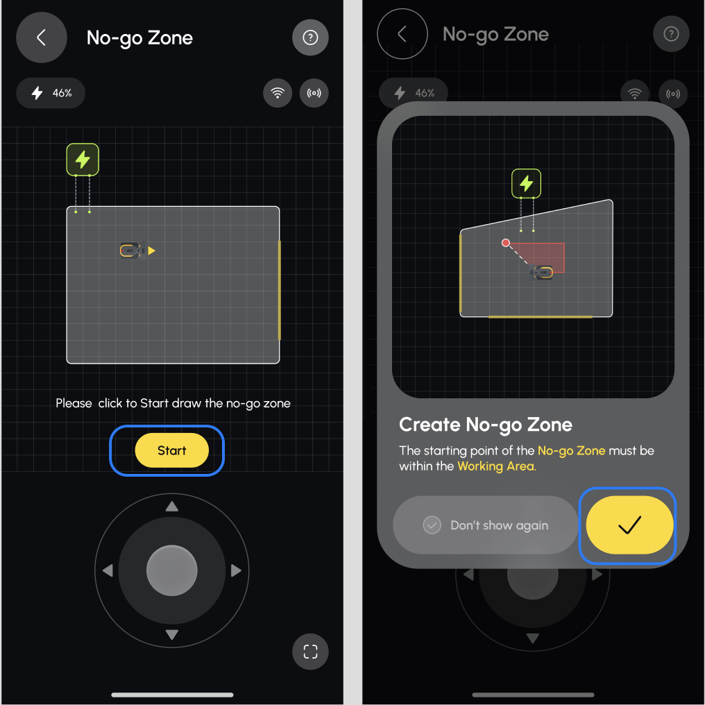

2. Drawing a no-go zone:
Click on “Start" to initiate the drawing of the no-go zone. Then, you will be guided through an animation. You can either click to choose ”Don't show again“ or directly hit the "Confirm" button to proceed with the drawing.

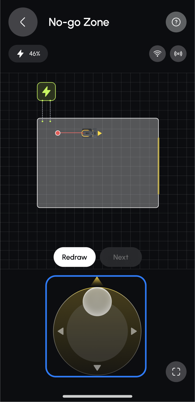

3. Controlling Yarbo for no-go zone creation:
Now you can control Yarbo to walk and create the Working Area!

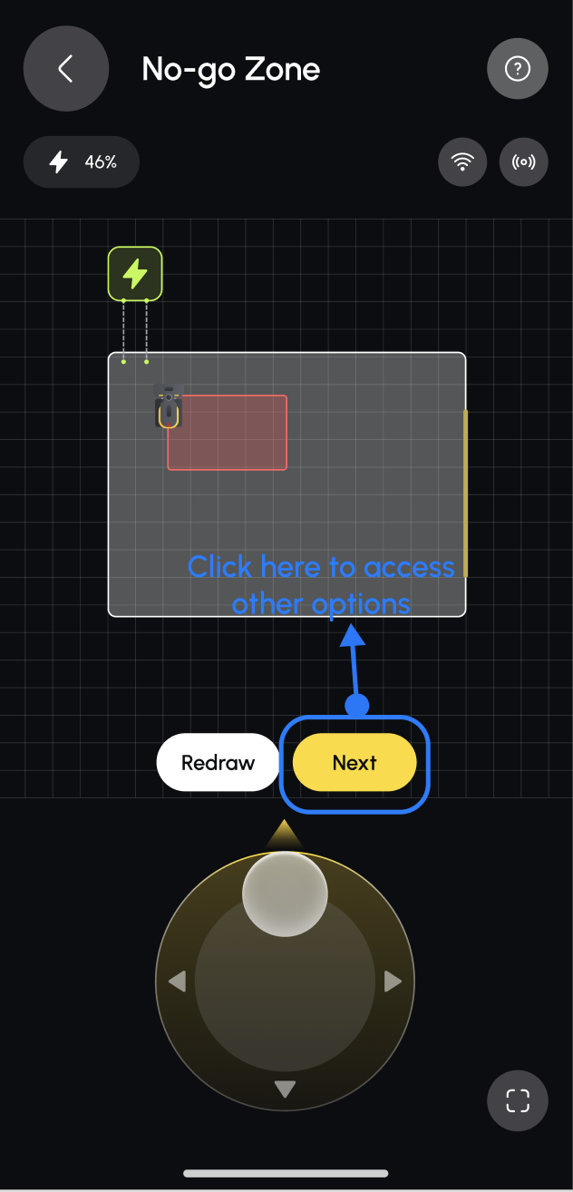

4. Completion of no-go zone drawing:
After completing the drawing, click on "Next", and you can proceed to other options!
