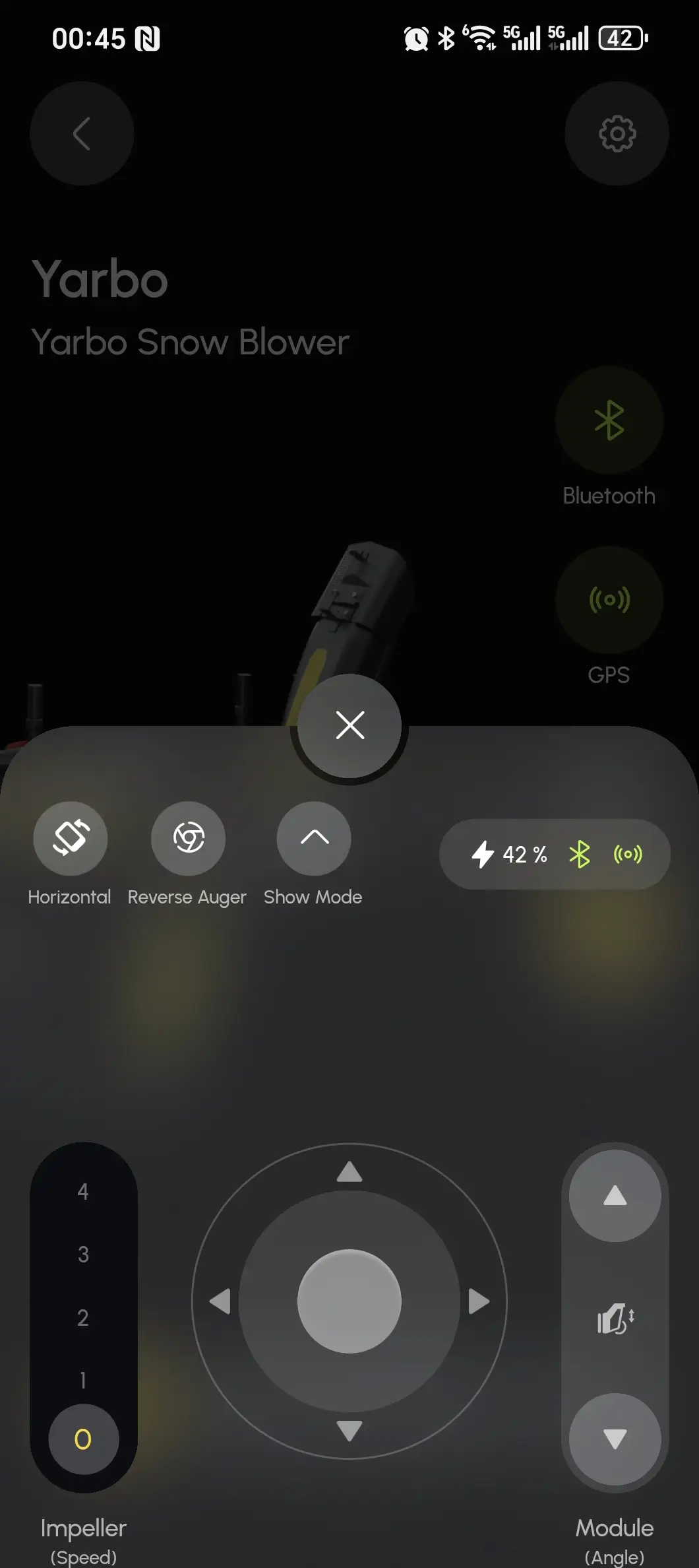

1. Horizontal Mode
app controller hozitontal mode
  • Tap the Horizontal button to switch the controller view to Horizontal Mode.
  • Usage:
    ①:switch to Portrait app controller
    ②:Adjust the horizontal and vertical angle of Chute
2. Reverse Auger
  • Will reverse the direction of rotation of the auger
3. Show Mode
  • Toggle Show Mode to switch the app controller to a mode designed for demonstration or when showing Yarbo’s capabilities without an active work plan.
    app controller show mode
4. Close Controller
  • Use the Close button to exit the app controller when you’re done making adjustments.
5. Battery Percentage
  • Displays the current battery level of Yarbo.
  • Keep an eye on this indicator to know when it’s time to recharge.
6. Network Status
  • Displays the current network status, showing if Yarbo is connected and online.
7. GPS Status
  • Shows the current GPS signal status for Yarbo, ensuring proper location tracking.
8. Error and Warning Display
  • Displays current errors or warnings in Yarbo.
  • This helps you identify and troubleshoot issues right away to keep Yarbo functioning smoothly.
9. Stop Button
  • The Stop button immediately halts Yarbo’s current work plan.
  • Useful for emergency stops or when you need Yarbo to stop moving for safety reasons.
10. Recharge Button
  • When Yarbo is within the working area, use the Recharge button to send Yarbo back to the Docking Station for recharging.
  • Yarbo will navigate automatically to the Docking Station for efficient charging.
11. Clear Error
  • Use the Clear Error button to clear any errors or warnings that Yarbo is displaying.
  • This helps you quickly get back to working mode after resolving any issues.
12. All Lights Button
  • Turn on/off all lights on Yarbo, including:
    • Front Light, Indicator Light, Side Light, and Rear Light.
  • Use this feature to improve visibility when Yarbo is working in low-light conditions.
13. Front Light Control
  • Specifically controls the Front Light, allowing you to turn it on or off as needed.
14. Side Light Control
  • Use this button to turn on/off the Side Lights and Rear Light.
  • Useful for additional visibility from the sides and rear of Yarbo.
15. Impeller Speed Adjustment
  • Adjust the speed of the Impeller using the slider.
  • The higher the number you choose, the faster the speed and the more efficient Yarbo will be at shoveling snow.
  • Tip: Use higher speeds for heavy snow and lower speeds for lighter snow to save power.
16. Chute Rotation
  • Adjust the horizontal angle of the chute.
  • This lets you control where the snow is being thrown, allowing for targeted snow removal.
17. Chute Angle Adjustment
  • Adjust the vertical angle of the chute to control how far the snow is thrown.
  • Higher angles will throw snow farther, while lower angles are good for nearby placement.
18. Module Angle Adjustment
  • Adjust the vertical angle of the module.
  • This feature is useful for fine-tuning the positioning of Yarbo’s snow blower module based on terrain.
19. Direction and Move Control
  • Use the directional pad to control Yarbo’s walking direction and angle.
  • This manual movement feature is helpful for navigating Yarbo to specific locations or making adjustments during a work plan.
