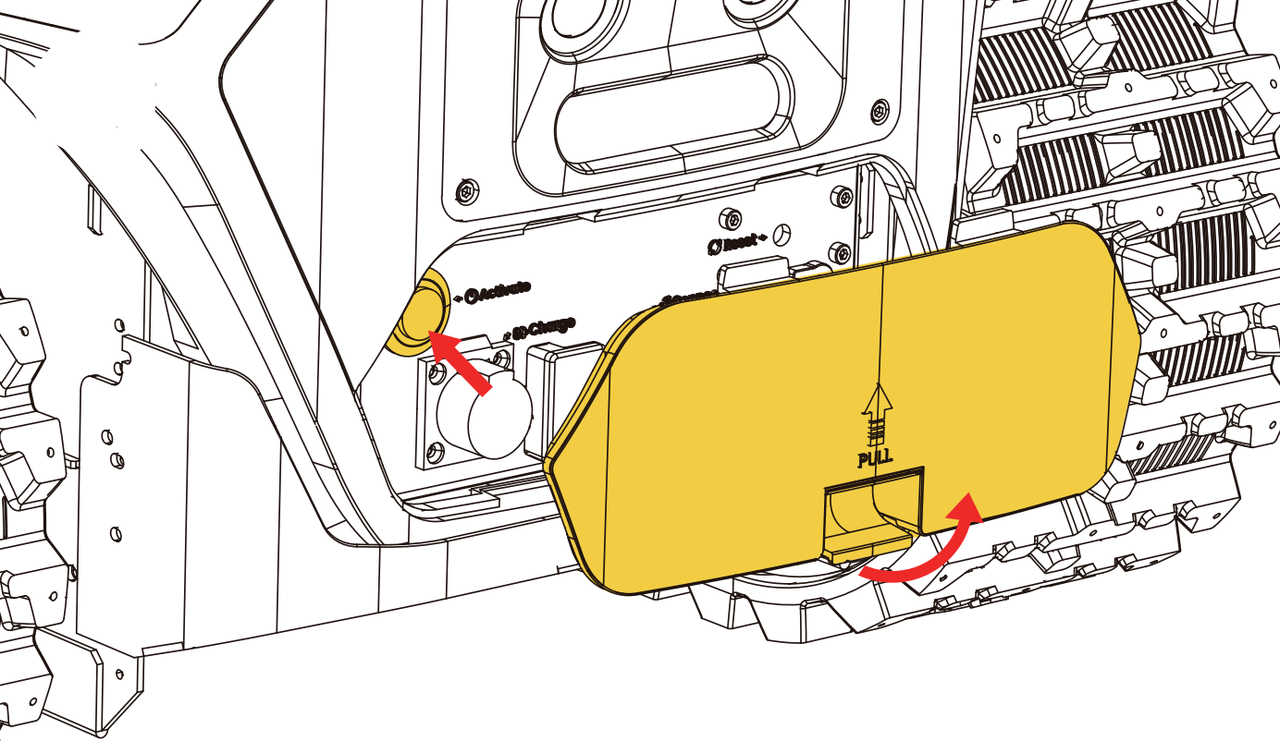

The Power Button on Yarbo serves the following functions:
  1. Starting Yarbo: After ensuring Yarbo is fully assembled, press the Power Button to start Yarbo.
  2. Activating Bluetooth Pairing Mode: When Yarbo is powered off, you can enable Bluetooth pairing mode by pressing and holding the Power Button for five seconds.
  3. After holding the button for five seconds, the tail light on Yarbo will turn blue and then turn off, indicating that Yarbo's Bluetooth device is now ready to pair.
power button
