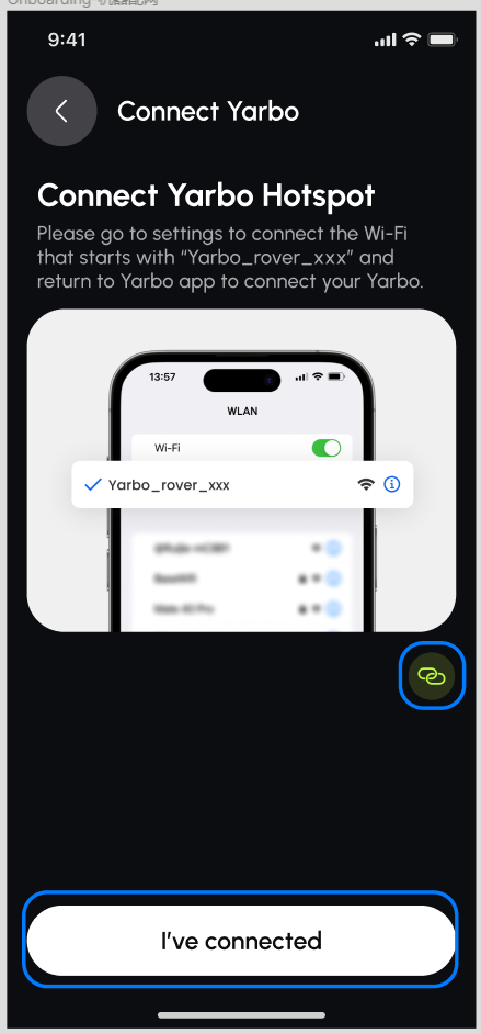

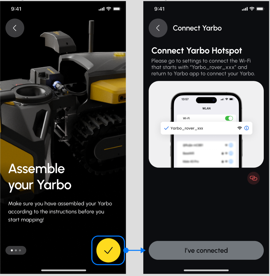

1. In the onboarding guide, upon completing the "Assemble Your Yarbo" step, the page will seamlessly transition to guiding you through the process of connecting to the Yarbo Hotspot.

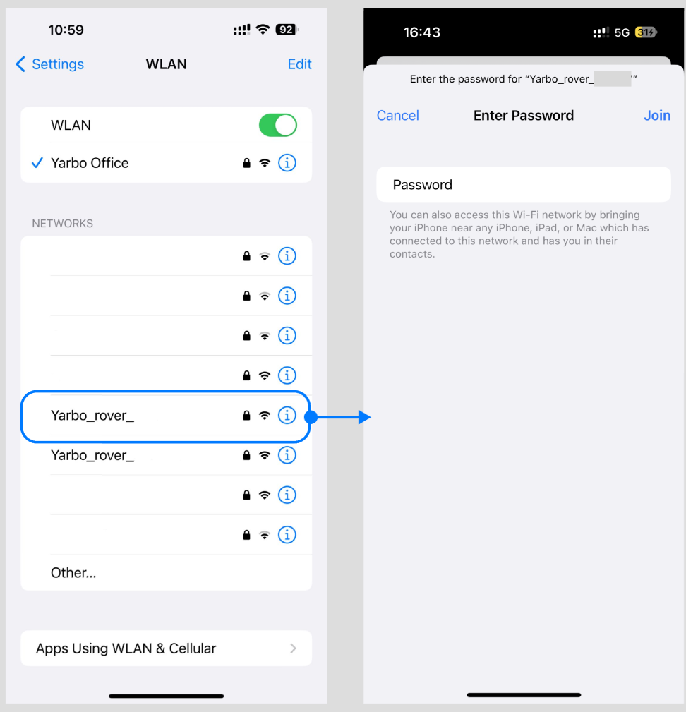

2. Then, follow the instruction and access the Wi-Fi settings on your mobile device, select the Yarbo device you want to operate, typically identified by the SN number ending in Yarbo. The default hotspot name should be something like "Yarbo_rover_XXXXXX". For the initial connection, enter the default password (87654321).
3. Wait for your mobile device to successfully connect to the Yarbo device hotspot.

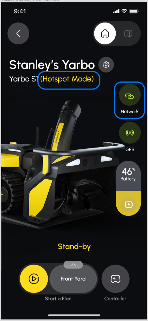

4. Once your mobile device has been connected to the Yarbo device hotspot, you will see the homepage shown at the screenshot below. At this point, you've successfully connected to hotspot mode.
5. You can click on the "I've connected" button to continue with the next steps.

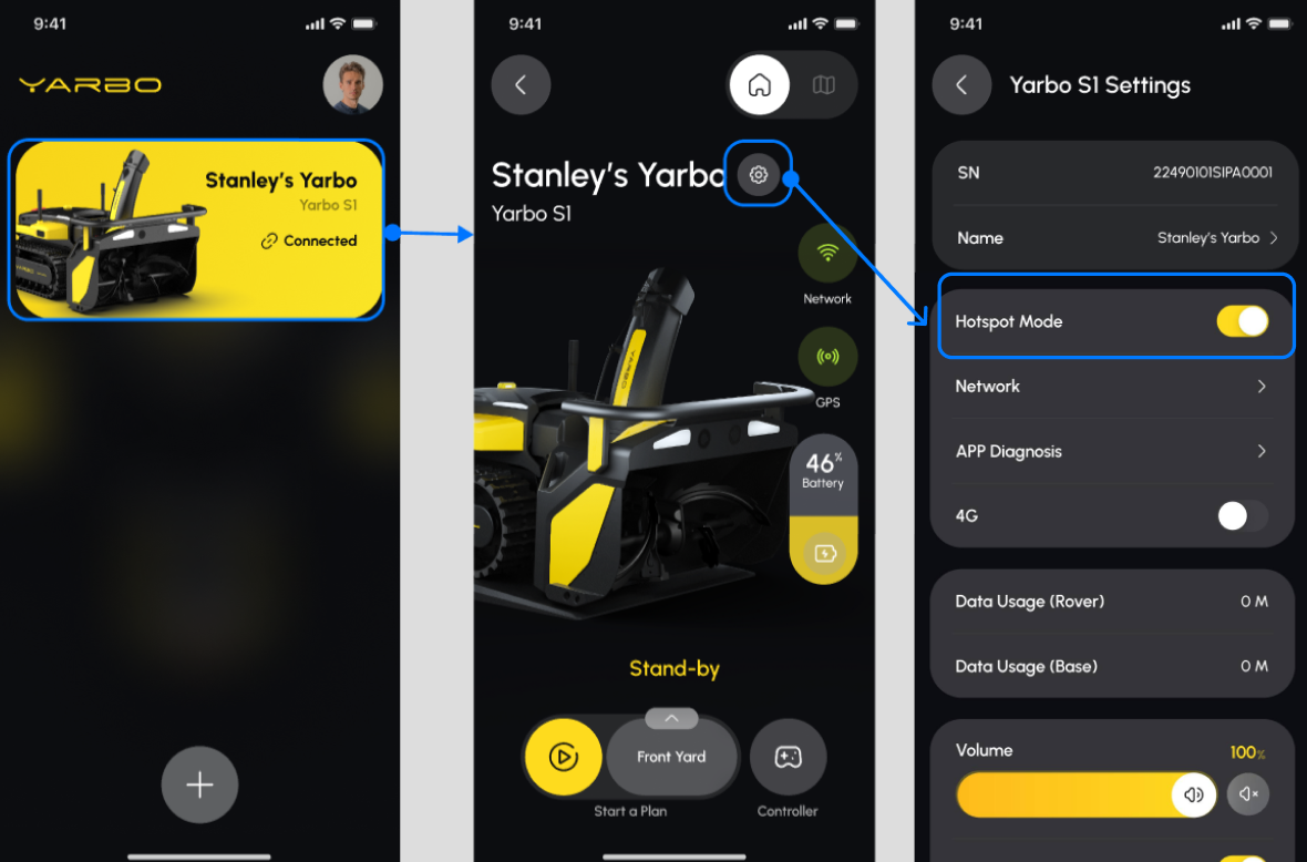

1. Inside the Yarbo Setting Page, activate Hotspot mode.
2. Then, access the Wi-Fi settings on your mobile device, select the Yarbo device you want to operate, typically identified by the SN number ending in Yarbo. The default hotspot name should be something like "Yarbo_rover_XXXXXX". For the initial connection, enter the default password (87654321).

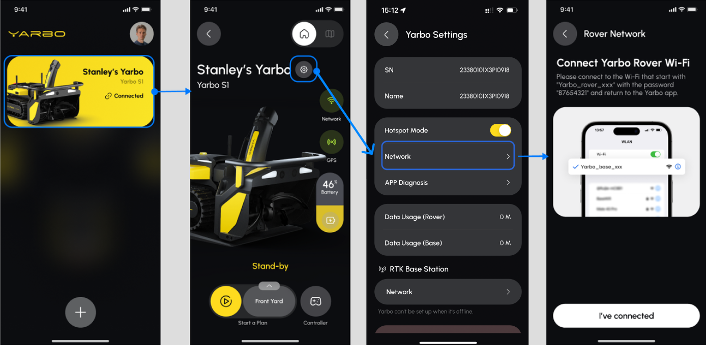

Wi-Fi Connection:

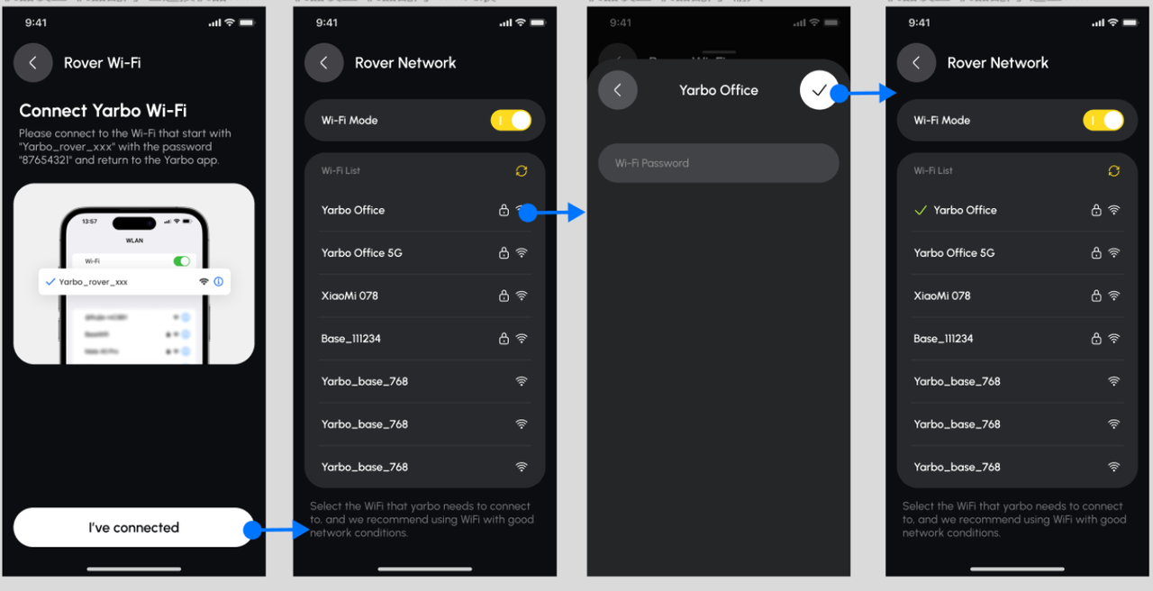

1. Inside the Yarbo Setting Page, activate Hotspot mode. Click on "Wi-Fi" to enter the device network configuration page.
a. Please check if your mobile device has been connected to the Yarbo device hotspot. If yes, please click "I've connected".
b. If your mobile hasn't connected to the Yarbo device hotspot, access your mobile Wi-Fi settings, connect to "Yarbo_rover_XXXXXX" (initiation password: 87654321), then return to the app and click "I've connected".
2. On the Rover Network Page, select the Wi-Fi network you wish to connect to and enter the password, once the Wi-Fi network for Yarbo device has been connected, please return to the Wi-Fi settings on your mobile device, and reconnect mobile device to Regular Wi-Fi Network.
3. Once your mobile device has been connected to the Wi-Fi, you will see the homepage shown as the screenshoot below.
