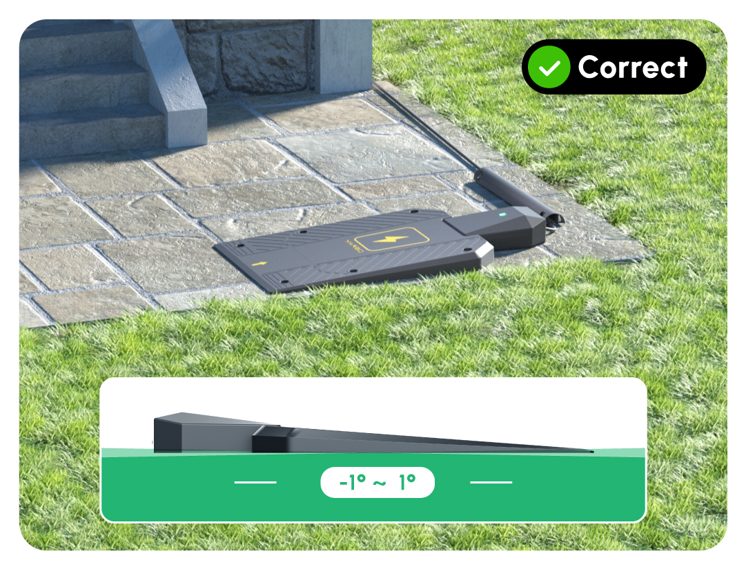

Ensuring Platform Flatness Within -1 to 1 degrees
Living in a region characterized by undulating terrain can pose significant challenges when trying to establish a stable, level surface for Yarbo's docking station. This is critical because a docking station that isn’t on even ground could lead to Yarbo slipping, interrupting the charging cycle, and possibly leading to unintended damage.
A practical workaround for this issue is to craft a leveled platform for the docking station. You can achieve this by excavating a portion of the hill to form a flat space and then reinforcing it with a robust board. This newly formed platform must have a less than one degree tilt for the docking station to function optimally. You can ascertain this using a level measuring tool or measuring apps on your smartphone. These measures will provide Yarbo with a reliable and safe docking area, preventing unwanted damage while guaranteeing effective charging.
