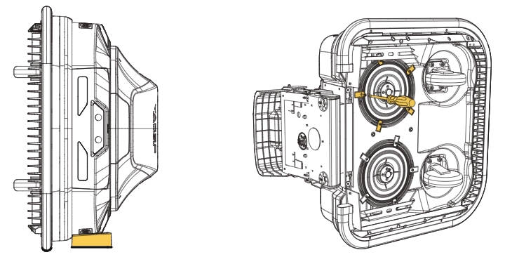

- Raise the lawn mower from the side, place the lawn mower on the Vertical Stand for Module, please refer to the following picture shown.
- Utilize a high-pressure water gun or water hose to clean the underside of the lawn mower. Do not spray the water into the universal body to prevent damage.

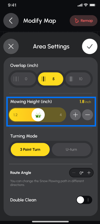

- Do not place the blade height too low in places with dense or thick grass.
- Please don't cut too much at once. You can set the mowing height to a low level in the app.
